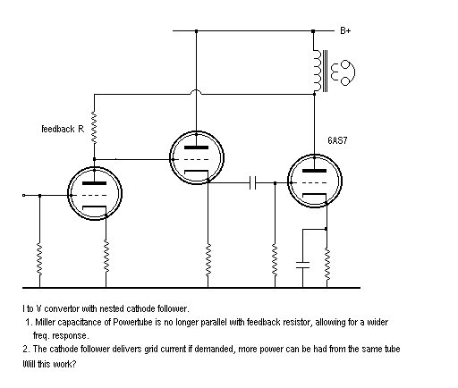

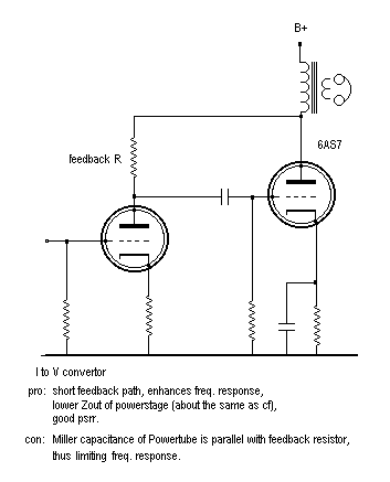

Partial Feedback issues
Hi there,
Some help on this matter wanted:
I red John Broskies article covering partial feedback http://www.tubecad.com/march2001 and tried it on a SE OTL feeding an 800 Ohms Philips speaker. (AD3800AM)
Gives great open sound, within it's limitations (mainly the speaker)
It works, but.... I get a reasonable output only untill the Powertube 6AS7 starts to draw grid current. The partial feedback seems not to help there. Also the value of the feedbackresistor is limited, because it is parallel with Millercapacitance of the powertube and so limites bandwidth. In my case about 47k for a max of 100khz. Not bad anyway.
To me it seems that there is a substantial difference in the feedback mechanism if the driver has it's own Ra instead of using the feedbackresistor as Ra.... In the first case, as I have used it, it looks like the driver just can't supply enough current for both it's own Ra and Rfeedback. so I think this cannot be a I to V convertor as JB described. Please correct me if I am wrong
Now I was thinking: Would adding a CF overcome these issues?
I've made up a drawing, to make my point. I used JB's drawings as a starting point. (3 Attachments)
Any comments are welcome, as i'm not trying to reinvent the wheel. 😉
Ok, thanks for reading this longish post and I hope to have given some interesting read.
Mark
PS. How can I put drawings in a reply iso attachement? Would be convenient to know
Can't do multiple attachments either 😕

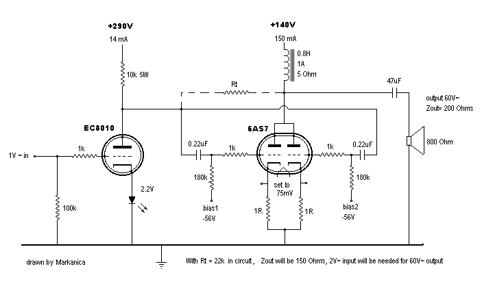

Hi Mark
I've played too with various implementations of this design with more or less success.
Interresting results where obtained in using a somewhat classic SRPP configuration for the driver, feeding the grid of the output stage from the upper cathode and returning the feedback resistor to the plate of the lower anode.
The two cathode resistors of this SRPP may be made unequal, since the FB resistor adds current in the lower portion alone.
The basic problem is pointed by JB, but he stops his paper before giving a practical solution.
That is: The plate of the output tube goes down, say near to its saturation voltage, on positive going alternance of its grid drive. At this point the driver must still pass some current altought its instantaneous supply voltage is so low.
IMHO, this could be solved by returning the cathode of the driver to a negative supply (or rising the cathode of the output tube, wich is not easier).
For now, it's what I plan to check using a penthode as driver and a -100v auxiliary supply.
And ... euh ... the huge voltage drive needed by the 6AS7 complicates the problem more than a lot but I understand this choice is to cope with your speaker.
I beleive that the higest the Mu, the better for the power tube.
Regards, Yves.
