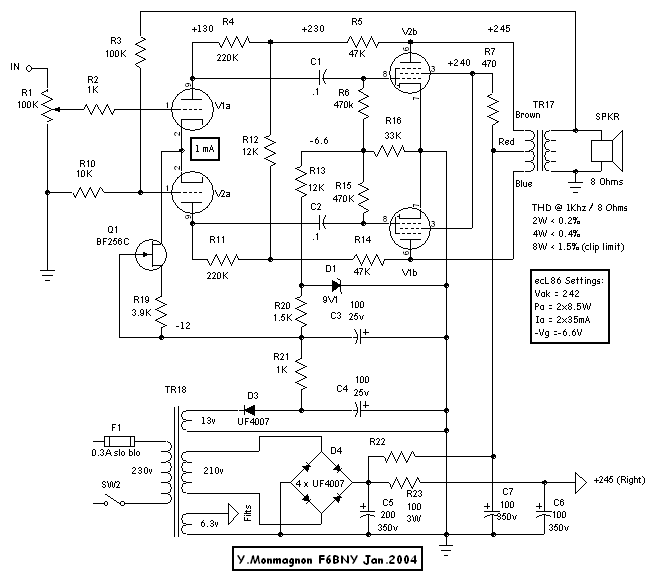

My PP version
This is my implementation of a PP configuration.
I don't claim for any novelty, just look at playing with the values of R3 and R12 to balance between local and global feedback.
Of course, a 12AX7 and a pair of 6BQ5 could be substitued by adjusting bias (e.g. R16)

Re: My PP version
Yvesm said:This is my implementation of a PP configuration.
Yves.
Nice amp, indeed -- I noticed a whole lot of SS devices in there, but I hope they do just help it do it's best 🙂 Although I do not own the famous bumper-sticker (Use a transistor...) I must admit that I would like to share that idea, if I were somewhere else where sharing ideas thru bumper-stickers and T shirts is worthwhile or any good.
As I might have previously said, ANY RH amp that was published to this moment can be made into a PP amp (with feedback and all...) provided you make it double... and you have a phase splitter in front of the two symmetrical amps per channel. It would work great -- actually, as great as the phase splitter is.
And, the more you know about it, the more you feel you would like to do it without a phase splitter. I believe that part of PP amps is the main reason why SE amps sound... well, better.
Aleksandar

Hi !
Thanks !
Mmmh..., say I'm too lazy to constrain myself in not using SS when I think than using tubes in place won't (IMHO) have any positive effect 😉
Sure, SE and PP have different behaviors, specially looking on how the OPT works ...
Both may be made lovely or terrible sounding 😎
Yves.
Alex Kitic said:Nice amp, indeed -- I noticed a whole lot of SS devices in there, but I hope they do just help it do it's best 🙂
Thanks !
Yves.

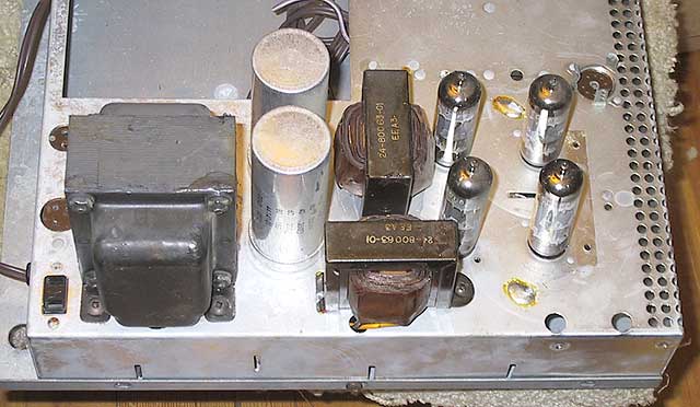

Re: My PP version
And i was just wondering what to do with the ECL86 PP donor amp pictured 🙂 It's a Viking with tubes made in Holland.
Cathode bias would be nicer... even better Class A with a CCS on the output cathodes (i happen to have a pr of 210VAC trafos that would suit a set of monobloks)
Alex -- the differentiial phase splitter with the CCS works very well. When Allen Wright showed his amp at VSAC he had a lot of died-in-the-wool SE guys rethinking things.
dave

Alexsander,
Please help me out here by explaining how the output tube connections work.
I see where R5, the (1k) is connected between the anode and G2 and R4 (2.5K) is connected between the B+ and the junction of the anode and top of R5 so in my thinking the tube is working in some sort of a pseudo triode connection because of the connection between the anode and the junction of R4 / R5.
Also, is the main intent of this design to get a lot of power out of the tube? I ask because if I can read the voltage test points correctly (they are small and hard to read) the cathode is running @ ~ 110mA and the screen is at 577Vdc and iirc the maximum on the KT88 screen is 600Vdc. I have 8 Golden Dragon KT88 from a PPP amp I built around 15 years ago but have my doubts about them standing up to the "pressure" of this circuit.
