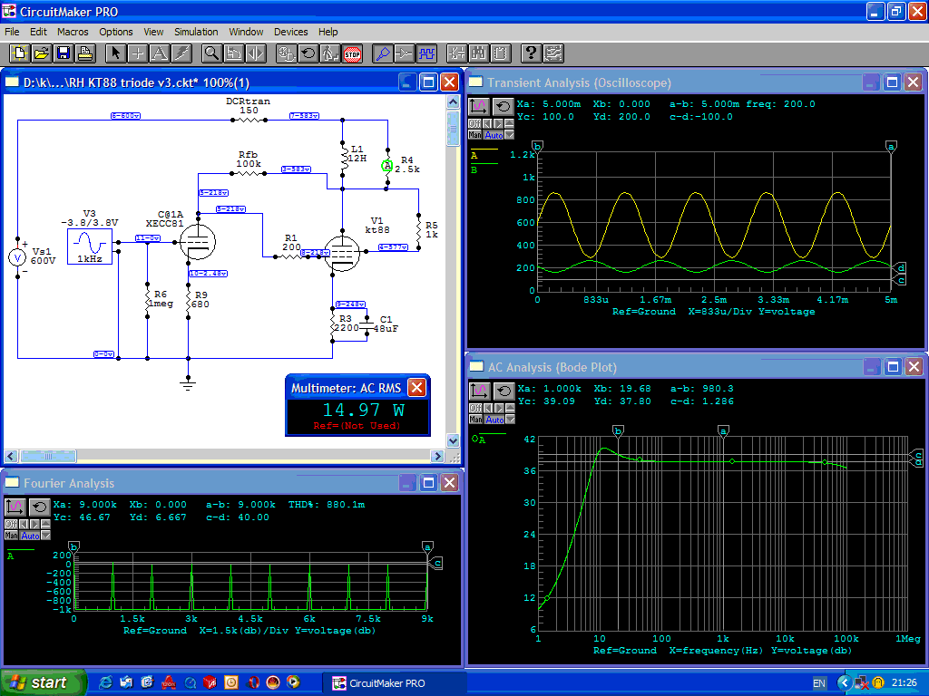

RH88 (6550) in DC mode
Well, I mentioned I wanted to try this version of it... but I did not expect the results would be "this rewarding"... see for yourself. To me, this is a scoop... and I am going to try it as soon as I figure how to achieve 600V B+ (that is going to need some serious thinking on how to use the available transformers and caps...).
Any comments?

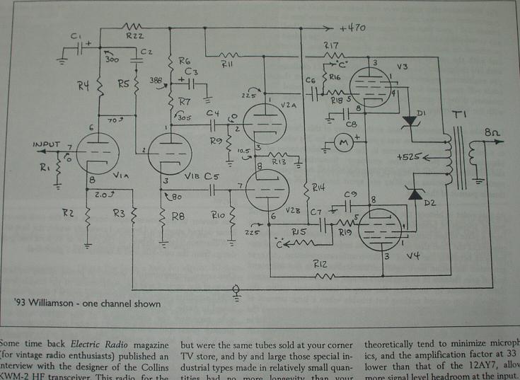

audiousername said:Gary's original PP 47 'Inverse Feedback Pair Amplifier' (I like that name 😎 ) schematic is dated the 9th March 03, which still means that your RH84 predates it. The John Broskie article was published in March 2001, so I'm not sure if the RH84 predates that since the RH84 schematic is dated '2001'. Nonetheless, the Radiotron Designers' Handbook (4th edition), in which this topology is described, predates both designs by almost fifty years. It apparently was also somewhat popular in the AF output stage of vintage radios. It may very well have been an original idea to you, but whoever thought of it first, or built the first amp based on it does not matter, and in any case is most unlikely to have been you, Gary Pimm, or for that matter, John Broskie.
Back in the summer of 1993, Sound Practices published this:
I'll have to look through some old notes, but IIRC, this sort of scheme was also used by Audionics back in the late '70s (the BA150 power amp).
EDIT: I do not recall correctly. It was feed back to the cathodes of the driver stage. In the words of Emily Litella, "Never mind."
