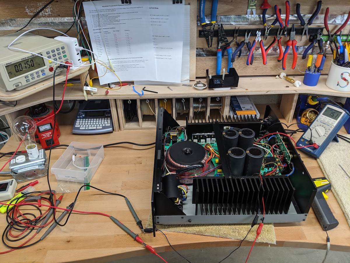

Alright. Good news and bad. I installed the two BR's today, double-checked the rest of the caps in the zip code. All looked good. We then ran into another issue. I'll try to be succinct:

- Recall the right channel was blowing F003. D002 BR was diagnosed as bad. We ordered two new BR's to replace D001/D002.
- Recall in the meantime, we pulled right side fuses, and then brought up the left channel on a DBT without issue, and ran for 30 minutes while we dialed the bias to 15mV @ 40 C.
- The VR bias pots were turned down. Fuses installed for both channels, and the power brought up on DBT.
- The DBT went bright and started pulsing, with the relay RY1 clicking at 1/2 second interval.
- No fuses blew.
- Removed right channel fuses. Started up amp again. Same thing.
- Did some looking around to verify assembly was correct, wires plugged all the way in, etc.
- Checked continuity on a variety of wires just to make sure there were no issues on hooking the board back up.
- Brought up amp again on left channel, and this time all was happy. Adjusted bias.
- I turned amp off, back on and again RY1 clicking away with DBT flashing.
- I tried pulling fuses to run channels independently. Both times, RY1 continued clicking with DBT pulsing.
- When I pulled both channel fuses, of course there is no load and RY1 does not pulse.
- In all cases, though, no fuses blowing.
- I checked inbound AC at the front board where clicking relay RY1 lives (not sure if that board has a name). 123V. When on, we get to about 20V on the other side, while RY1 clicks away.
- I went through and tested every component on that board (diode, BR, zener diode, resistors, thermisters) using a TC1 tester and multimeter. Everything tested fine. I did not test the transformer or RY1 on that board.

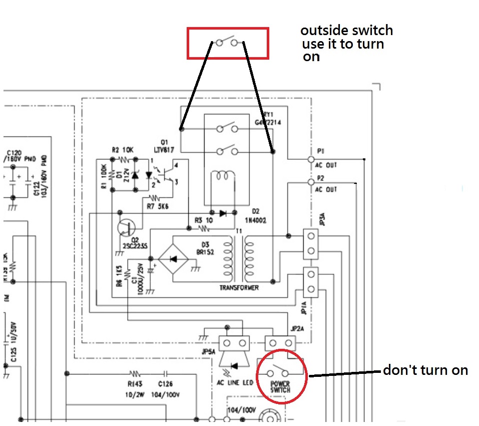

To test the amp first, we just bypass the circuit, and just turn on the amp with out side power switch

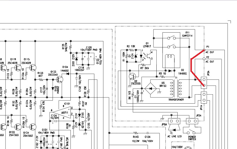

First don't turn on the amp power switch, we direct connect the rely contact points to an outside power switch which placed after DBT.
The relay clicking at 1/2 second interval is very danger to the the amp, the power on/off pulses will generate high potential possible to break the things on the power supply output side.

connection like this
Patrick101
That modified connection will not turn the amplifier on. Look closely at where the two pins you jumped across are going.
Fmorelli
I attached a modified drawing showing how it should be connected.
With a jumper across the shown terminals the amp will always be powered on so plug it directly into the DBT and if anything is wrong unplug it to power it off.
You are right!
I'm sorry my diagram in #70 was not correct, I made a correct diagram again.

My sentence in #69 "direct connect the rely contact points to an outside power switch which placed after DBT" is correct.
If the amp works ok after bypass the power on relay, next step is to fix the start circuit.

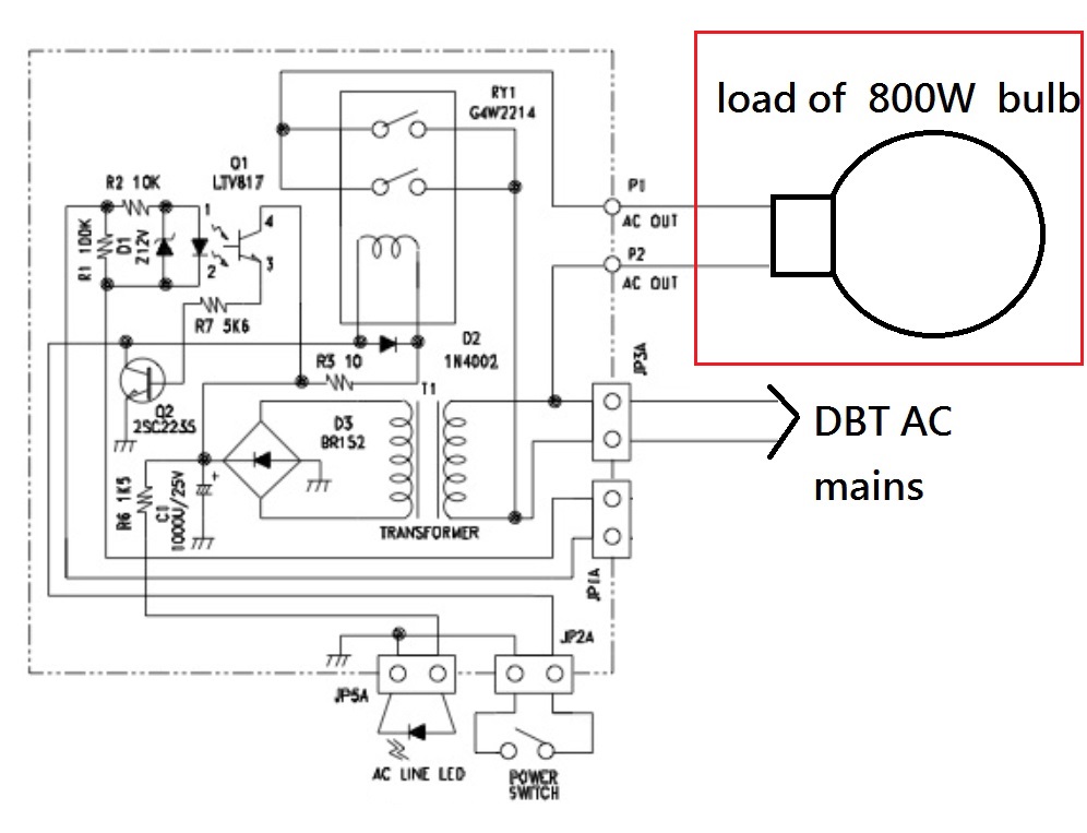

Better test the start circuit alone by connecting the relay output to a dummy load instead of the amp's transformer, try to find out why the little transformer cannot power the 24V relay right.

I'm almost 100% certain the start circuit problem will go away once he takes the DBT out of the circuit.
The DBT is dropping too much voltage for the start relay to pull in once the power supplies are energized. I've had this same issue in the past with other amps while using a DBT.

Your are right! After the amp tested ok and power up without DBT will be no problem.

Alright guys, I went to sleep and got up to find this whole conversation! Thanks for the thoughtful feedback. You can imagine I was slightly frustrated after yesterday's rigamarole. A healthy dose of ignorance and enthusiasm hahaha.
Anyway - ding ... the DBT was the issue. I disconnected both channel fuse pairs, and fired up the amp on straight wall juice. No problem. Came up with one channel, no problem. Came up with other channel only, no prob. Both channels and just happiness.
It has stabilized at 15mV @ 38°C. Next I'll hook it up to some Klipsch CF-4's and see what we have.
