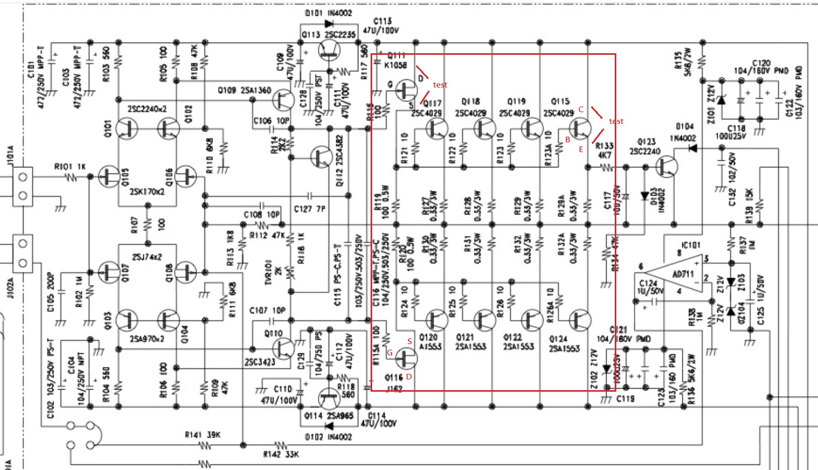

Why change the value of R119/120.
This was patrick's post on another thread:
This amp's circuit design is good. Upgrade with normal recap, replace resistor is OK.
If we change a higher driver current, you will have a more warm, dynamic and punch bass performance. To do that, remove two 100R resistors R119,R120 and replace a 47R 2W connect between two driver transistors. After mod reset bias.
R119 and R120 - anything special about which 47k 2W resistor they get? Or any one will do?
Filippo
The replacement resistor is a 47 ohm 2W (not K ohm), normal 2W resistor is OK, even you just use the R119 and R120 parallel together as a 50 ohm will fit this application as well.

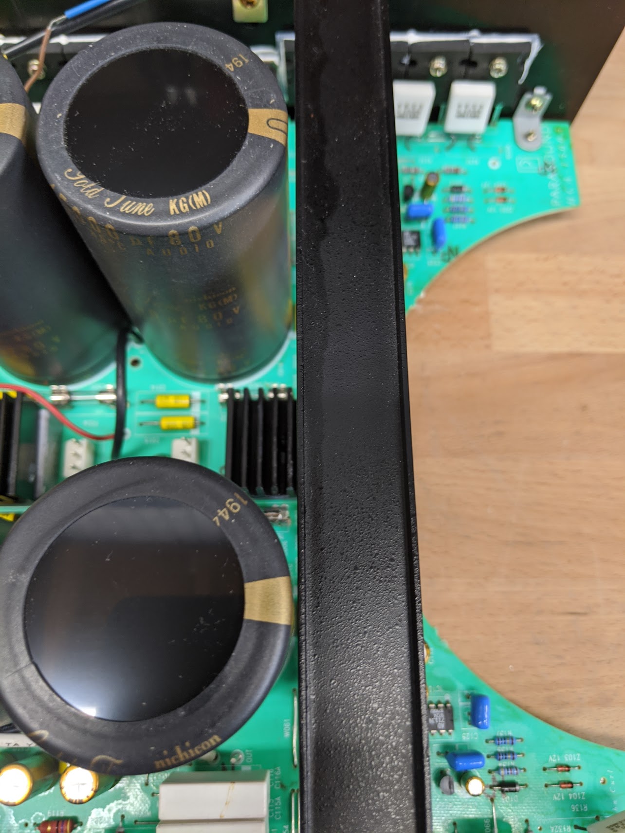

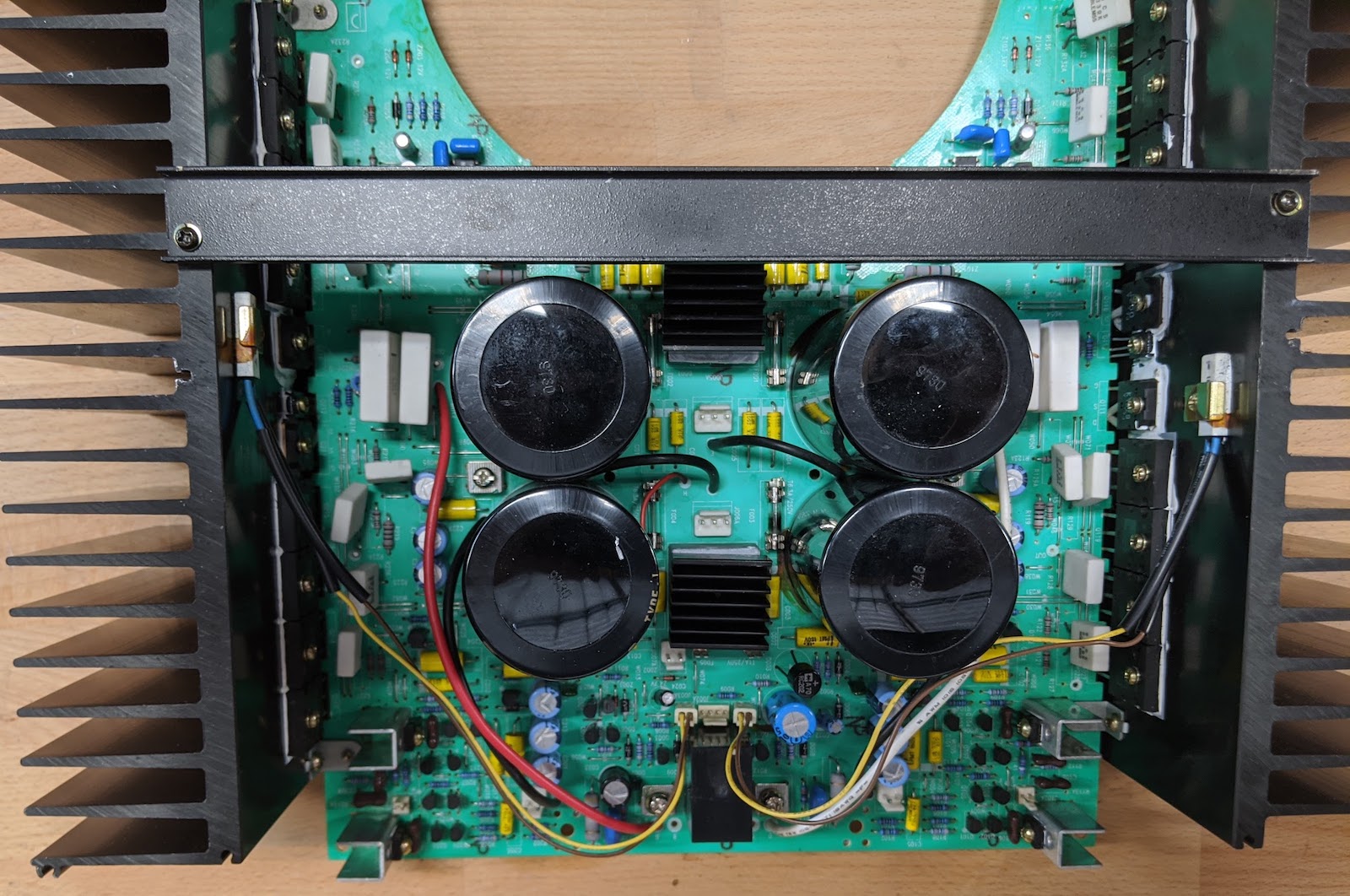

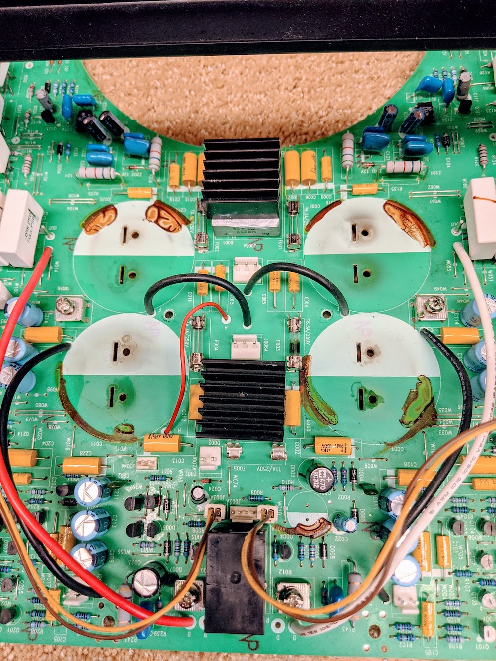

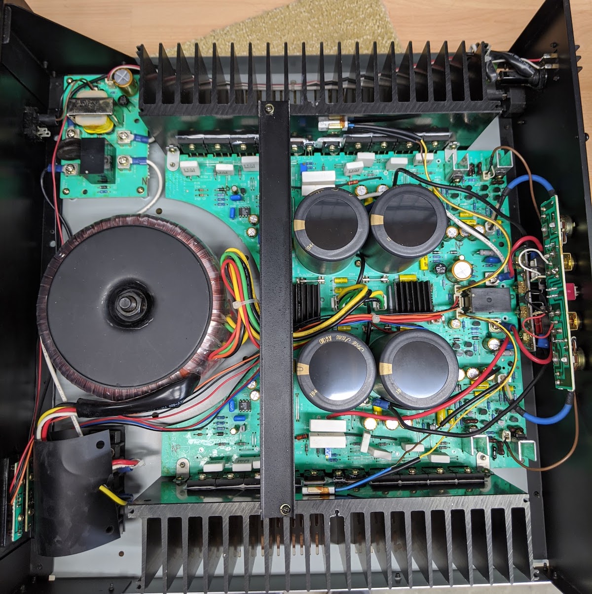

Everything arrived this morning, so I got underway.

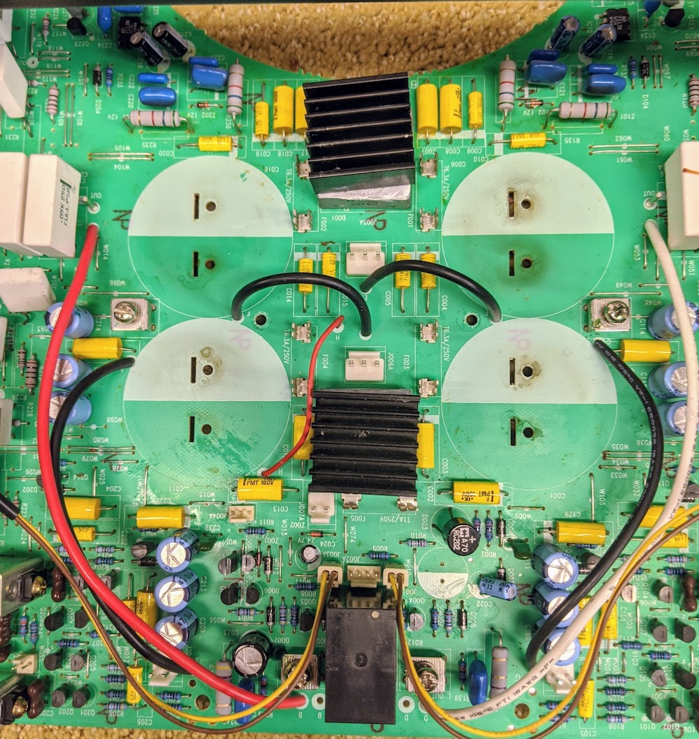

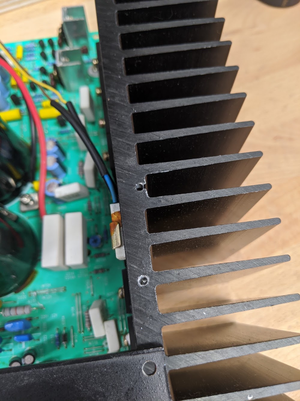

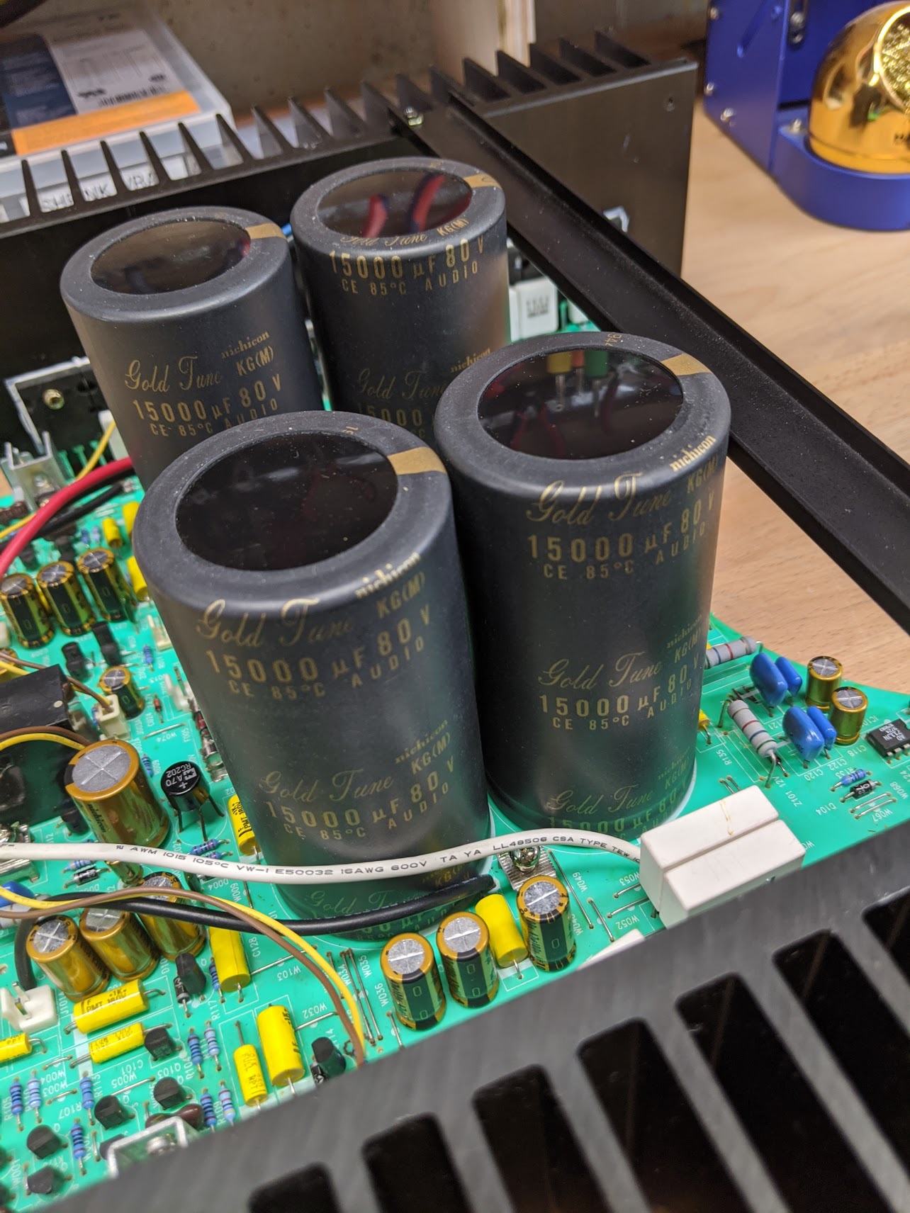

First off the filter caps are 20mm taller, necessitating relocation of the cross bar which attaches to the large heat sinks. I shortened the bar and shifted the mounting location from overtop of the filter caps to south of the caps.

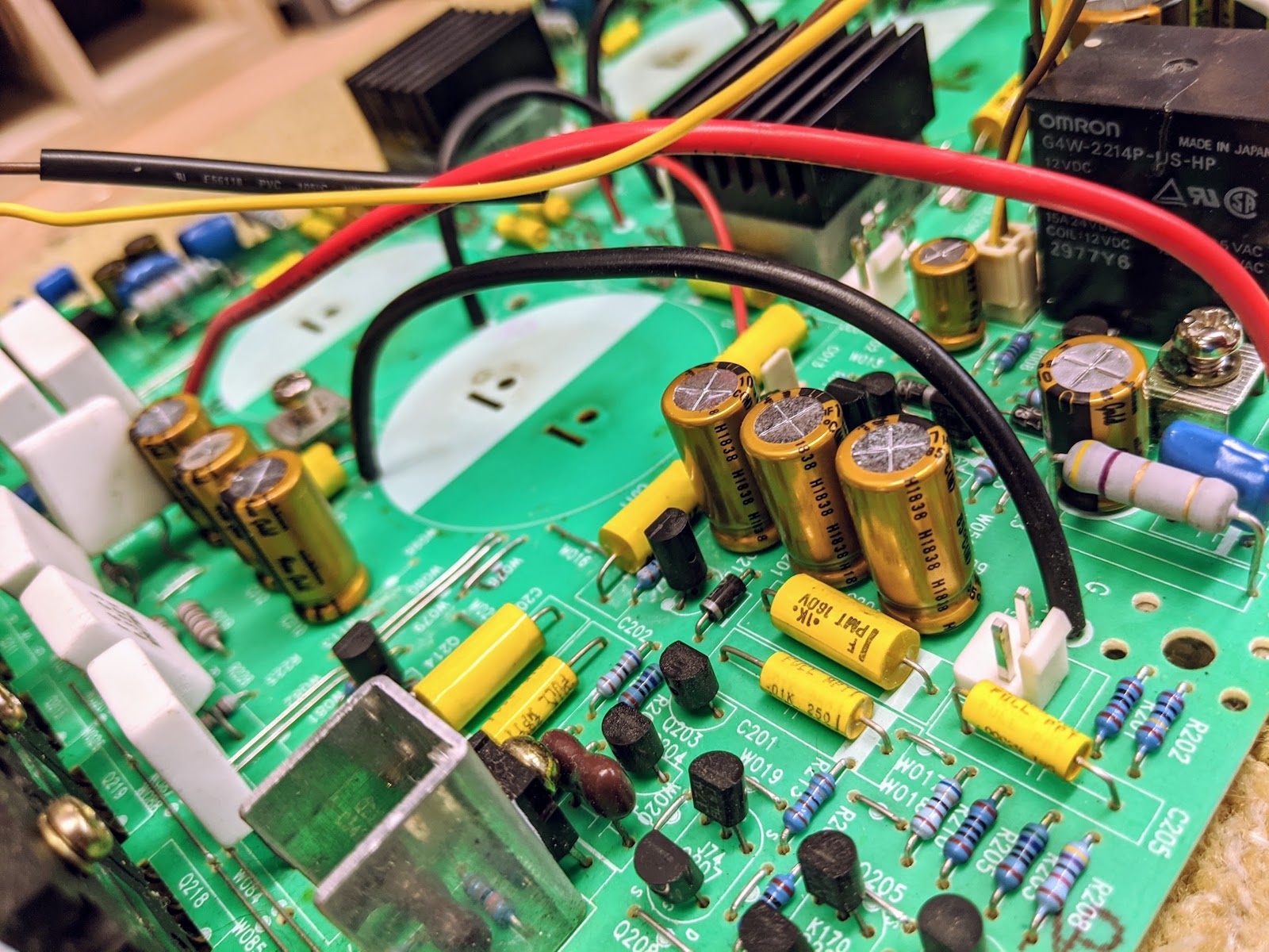

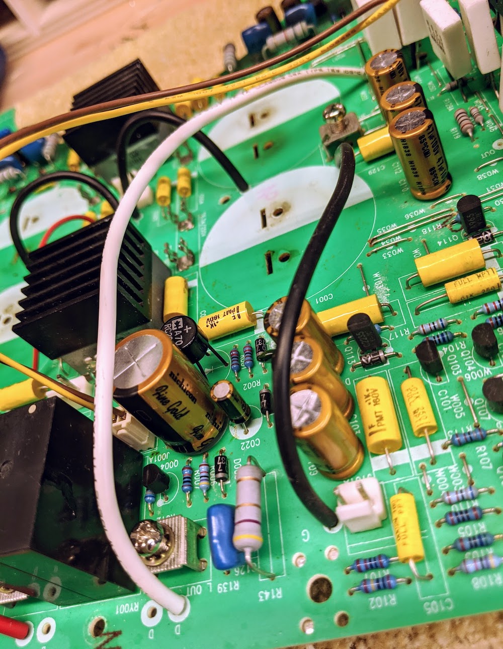

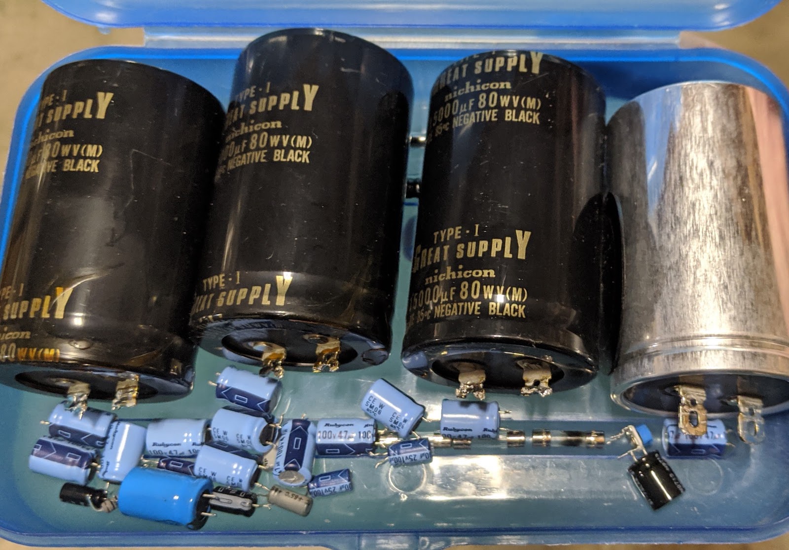

I pulled the 4 filter caps and a 5th cap that had leaked. Cleaned the board with distilled water, q-tips, and a small piece of lexan to gently scrape the caked electrolytic material loose from the PCB board.

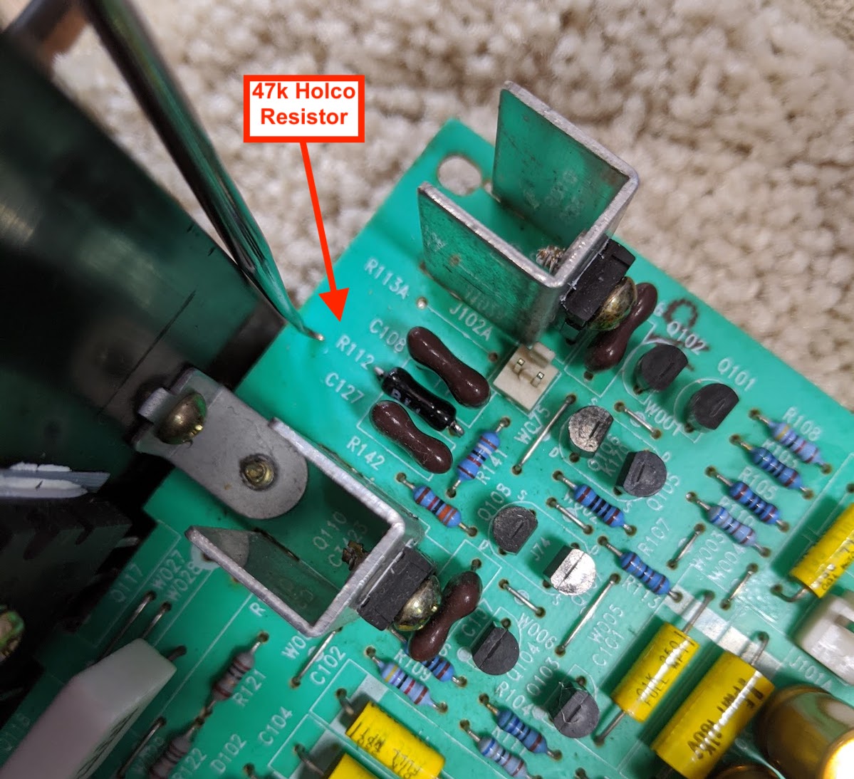

I discovered I ordered the wrong VR's ... 2MΩ instead of 2kΩ! I've updated the spreadsheet and I believe the correct p/n is Bourns 3296Y-1-202, which is
2kΩ, 1/2W, 10% provides 25 turn attenuation. 2 of them are on their way.

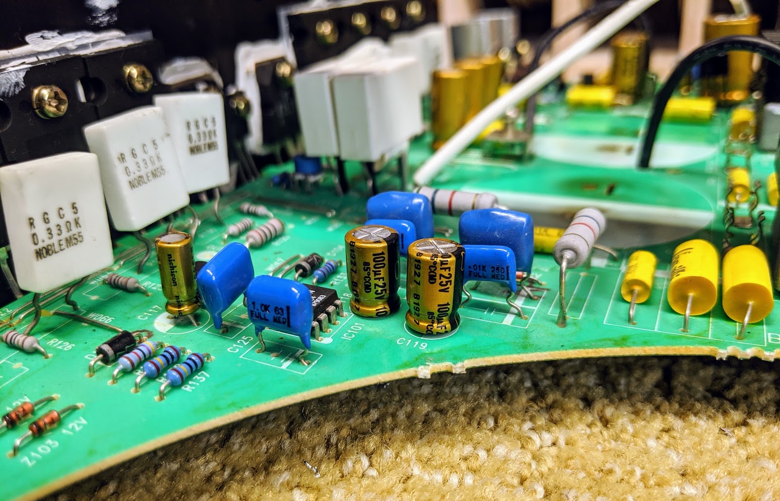

I have Holco H4 resistors on their way for the feedback side of the amplifier. I also replaced R119/R120 per Patrick's suggestion. Those received Vishay PR02000204709JR500.
Fuses all replaced. At this point I'm waiting on the feedback resistors to arrive, and the new trimmer pots. I have the on/off relay to replace, along with a single capacitor on that board, and finally need to install the filter pots.

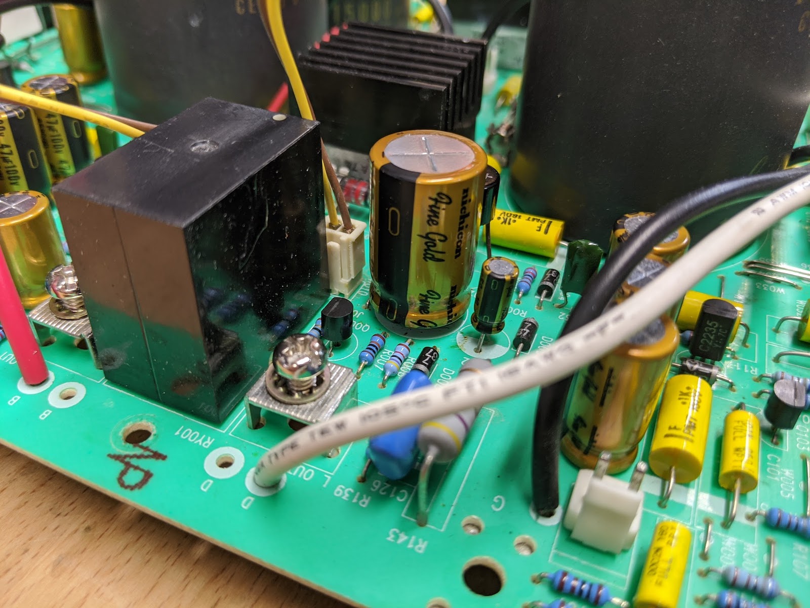

Nice job and the new gold cap is beautiful. The speaker relay contact points should be cleaned or just replace a new one for secure.
Hoping for a successful firing up of the amplifier!

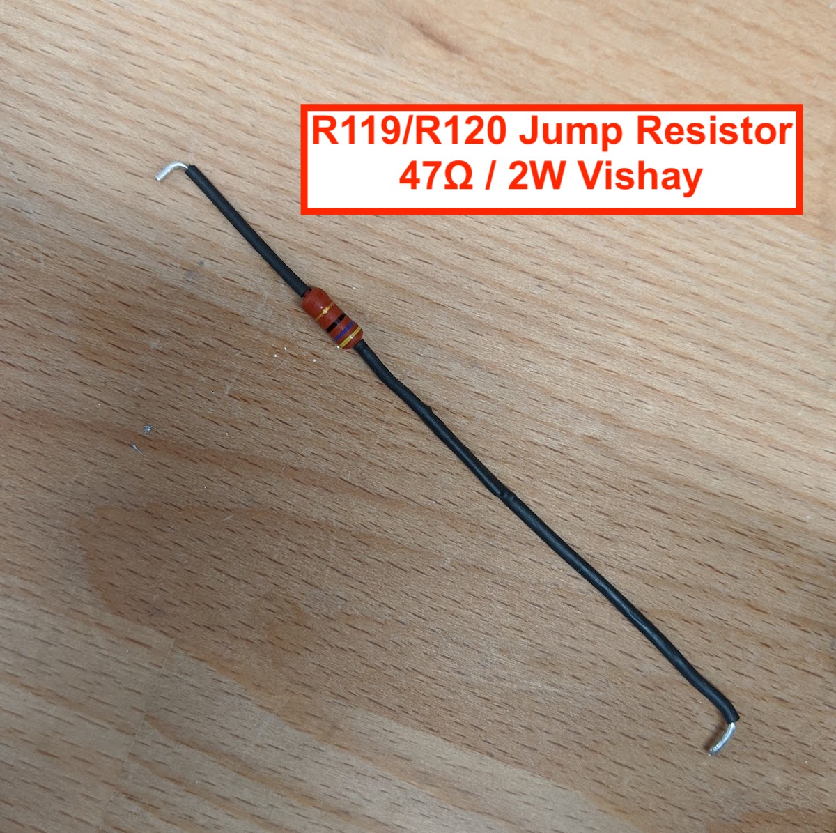

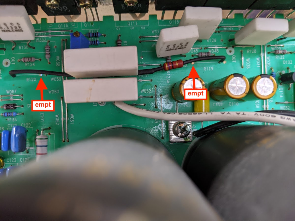

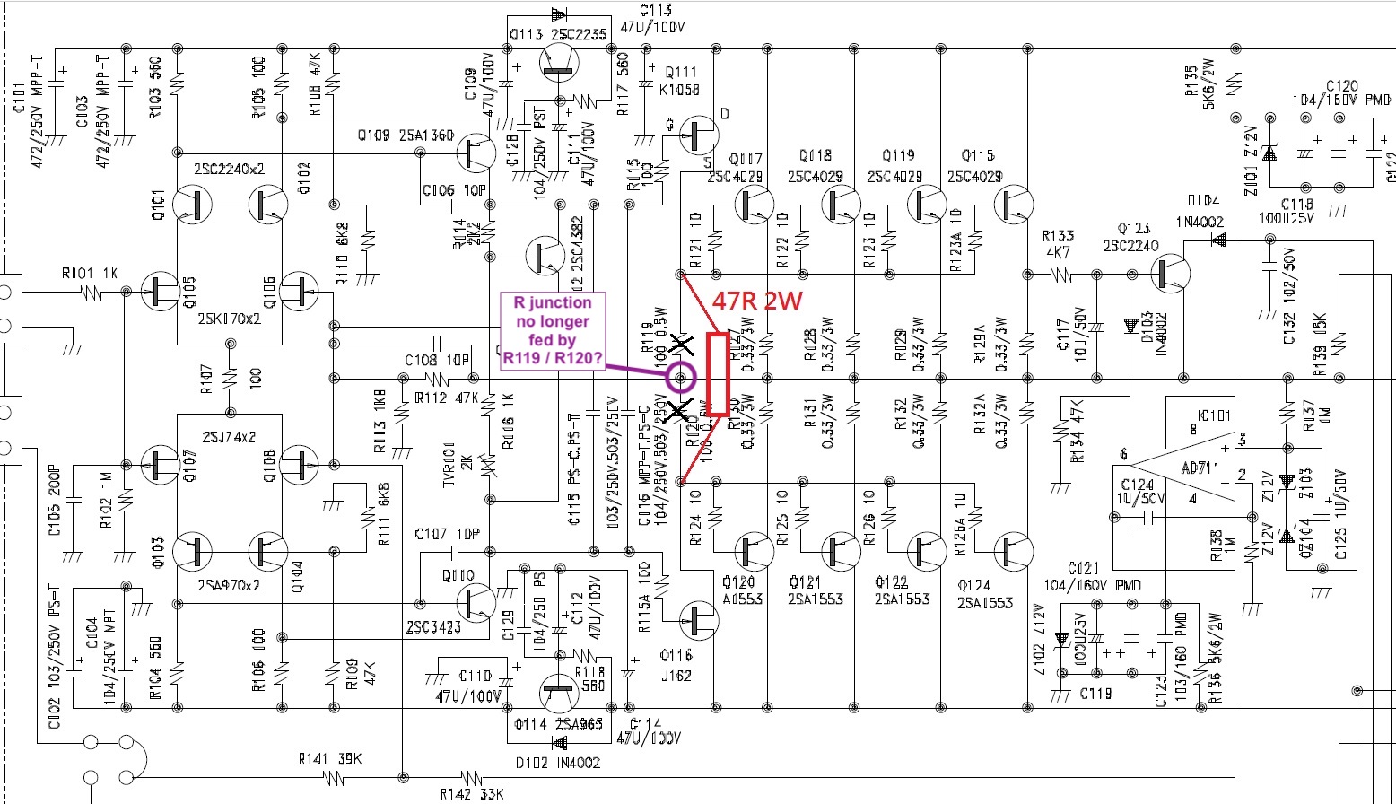

Hi Patrick, I'm sitting down to replace R119/R120 and looking at your schematic marking. I am still a bit confused. I understand that if R119 and R120 were in series, at 100R each that would be 200R, and that you recommend changing that to a 47R 2W.for new replaced resistor installation, you solder it on the PCB soldering side, one resistor leg solder to old resistor position which is one of driver transistor output, the other resistor leg connected to other old resistor position by extended wire with heat shrink tube protection and make sure no short circuit in the final installation.
But in looking at the diagram you supplied, bridging those two connections with one resistor, and getting rid of the inside connections (where you drew the "X") has me lost. There is a junction to which the electrical path flows from each of those resistors.
1) This modification would remove that junction path, correct?
2) In the new diagram, if #1 is correct, I don't understand what function the 47R "bridge" resistor now performs?
I've attached a photo to help clarify my explanation 🙂.
Thanks for your thoughts,

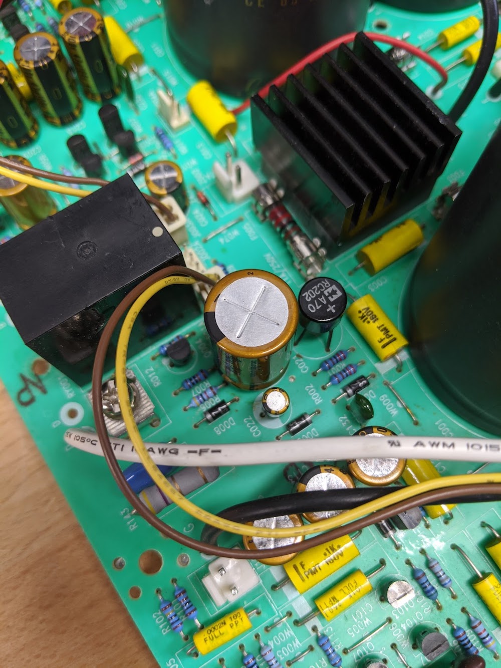

Aside from the filter caps, C021 (1000uf 25v) cap also leaked. I measured dimensions and decided to put a 35v cap in its place in hopes of giving it a bit more longevity. I wanted to provide a few photos of the fit. I have it sitting about 1/16" off the board. Tight but reasonable fit, clearing anything on the board.
Filippo
Filippo

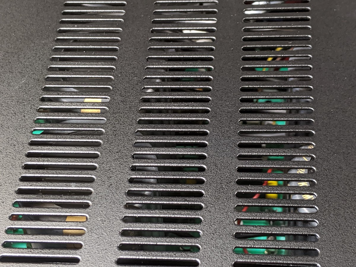

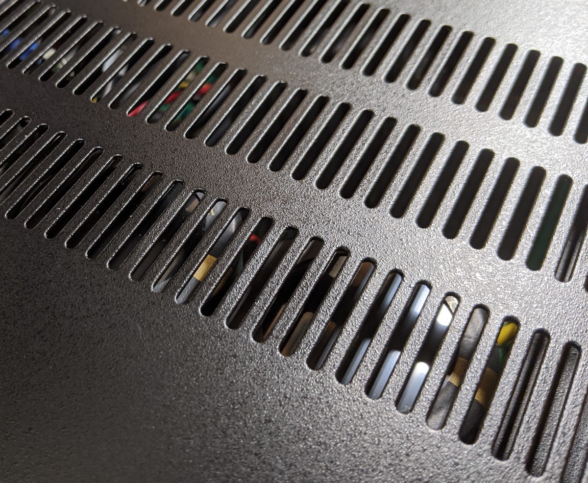

Here's how the 100mm tall filter caps fit, relative to the case. About 7-10mm space between the case and top of the caps. Well ventilated top, so I have no concerns.
original design using 200R is normal but the driver current is low, change to 47R for more higher current will make the amp performance more warm, dynamic and punch bass, you can compare by change and no change resistor
1) yes, modification would remove that junction path
2) both connect or not connect that junction path (the output) will apply to normal amp design, it has no problem. I prefer the not connect performance.

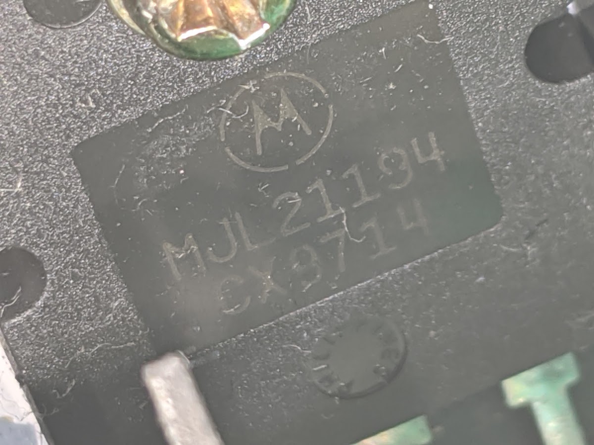

Based on his recommendation I went through and checked the transistors (power side mounted on the heat sink walls), given that I had a blown F003 fuse. They all checked out which was good. But one thing I discovered was that the transistors installed in my amplifier are not the 2SC4029/2SA1553 found in the HCA-1500 schematic. Rather my amp came with MJL21194/MJL21193.

Next I went ahead and did Patrick's mod, swapping out the two 100Ω resistors per channel (R119/R120 and R219/R220) with a 47Ω Vishay, outside to outside. Everything went back together and it is ready to test.
