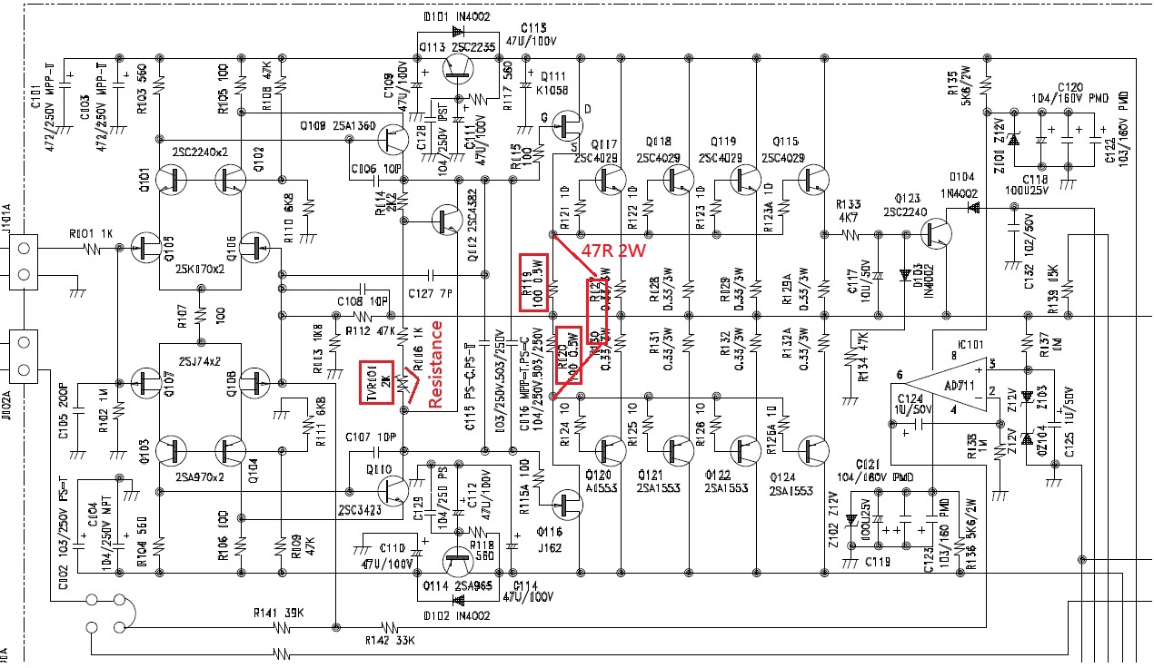

Hi, 2200ii driver current is much higher than my suggestion for the 1500A driver current mod.
2200ii mosfet drivers drive a total of 20 ohm(my suggestion for 1500A only 47 ohm) resistance, so that the 2200ii driver current will be doubled my mod suggestion for 1500A model, therefore you no need to mod 2200ii for this.
In other words, JC designed the later 2200ii model with a much higher driver driving current which proved my higher driver current mod appropriate for 1500A.

Maybe you can try adj the driver current to a bit lower to adj the bass, just like my suggestion to 1500A, replacing a single 47 ohm 2w resistor and don't join the middle point(the output).
Disclaimer; I have no expertise in the audio world. I am thinking here out loud about the driver mod, ( suggested by patrick101) . As I indicated previously, I like to understand a proposed circuit change before emplimenting. My limited knowledge tells me that the mod not only increases the driver current, but also removes the feedback from the input and driver stage(voltage gain). This leaves only a global feedback network(I assume). I also recall in my reading that to meet HTX certification requirement, more feed back might have been required. Is this reasonable thinking? Where does this lead us?

It's amazing what you might dream up while sheltering in place. Some simplistic thoughts. Ok, the driver mod.
Brainstorming about this mod I came up with this idea as to why this might be a pleasing change. The front end of the amp is operating Class A( generates pleasing even harmonics ). Output is operating Class AB (creating not pleasing odd harmonics ).
The mod removes the cancelation feedback of the even harmonics, thus these harmonics come through in the output signal, more like a tube preamp. The odd harmonic distortion from the output stage is still in the feedback, thus the less pleasing odd harmonics are cancelled in the output signal. Overall the sound tilts closer to a "tube" amp sound.
The problem with this scenario is push- pull amp(I believe) suppress even harmonics.
These simple thoughts make me so appreciative of the work done by the designers.

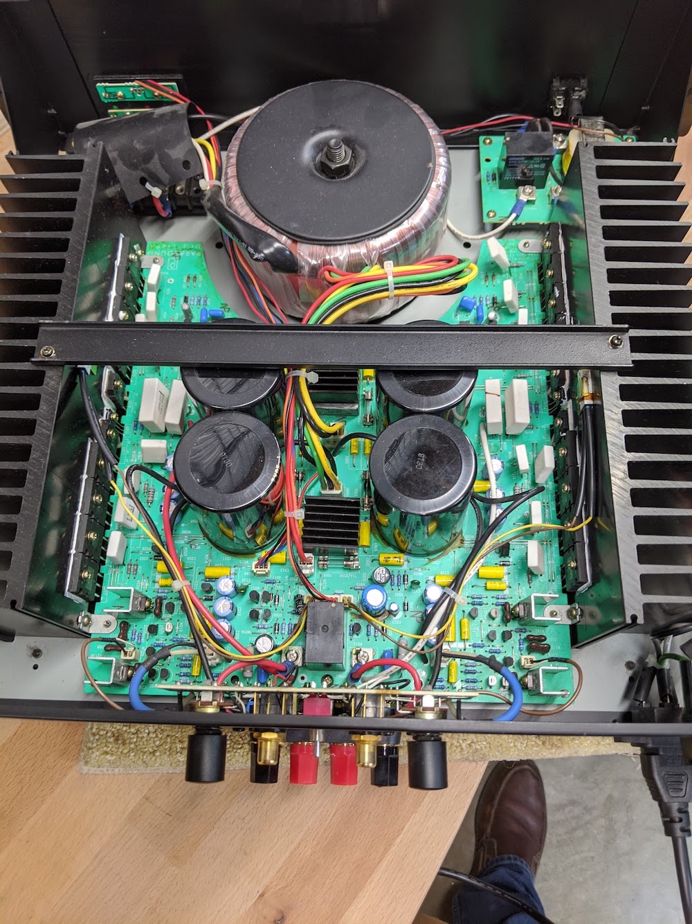

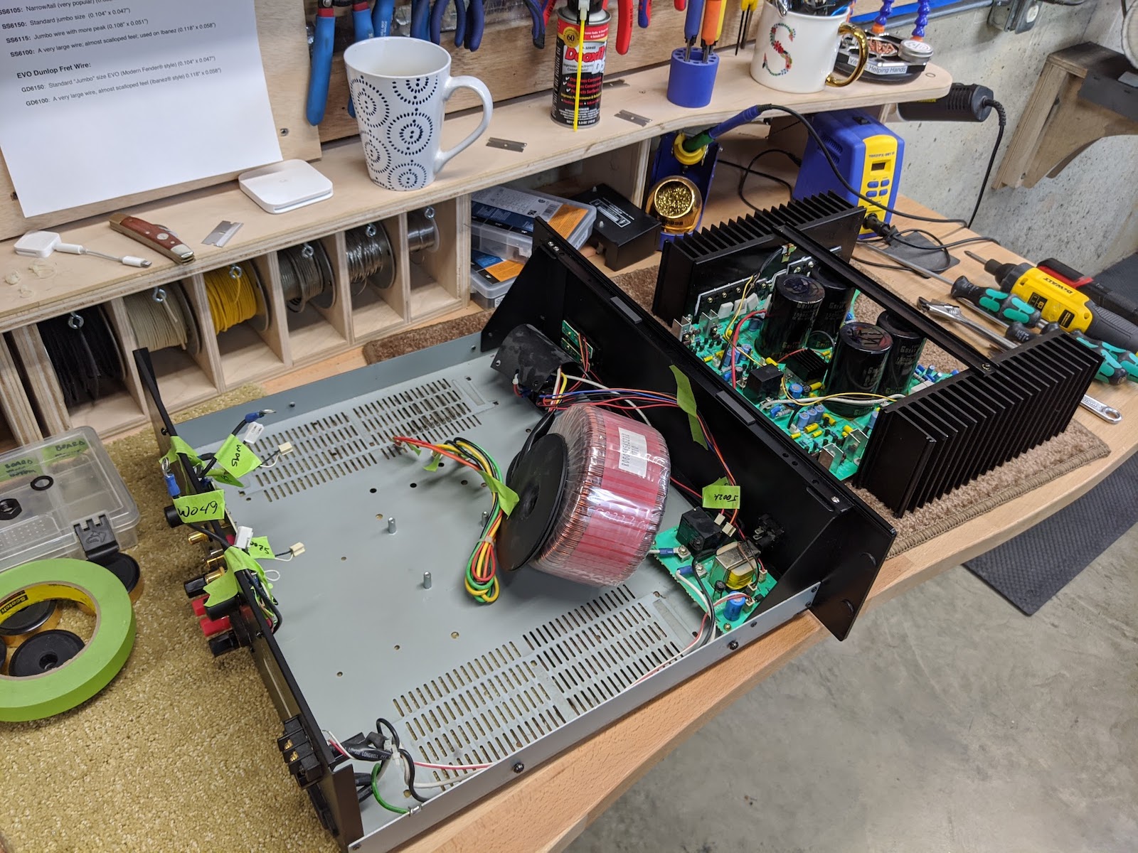

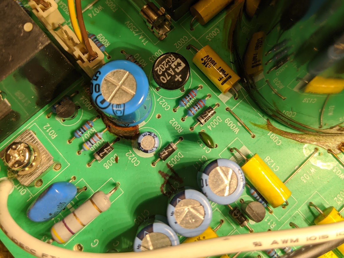

I've owned this amp for about 10 years and always thought it had great sound as it bested so many other amps in my system. But it was stored for the last 5 years as I went in to tube stuff and when I pulled it out it didn't sound as good as I remembered. So I pulled it apart and the only thing I see possibly wrong is a bulged AC cap. Is it just my musical tastes have changed or does it not sound as good as I thought? I appreciate some of the mod suggestions on here that I would implement but would need pictures as I'm a bit of a noob. I'm horrible at reading schematics but good at copying others work.
I would like to bypass the stereo/mono switch and the pots on the back but would like to see what everyone has done to do this.
Thanks for any and all input.
Trevor.

I really hate threads that just dead end so I thought I'd give a quick update. Managed to figure everything out on my own and completely eliminated the stereo/mono and pot PCB in the back. I kept the looping RCA to run a sub off in the future. I re-used the input cable from the PCB on the rear and soldered the leads to new RCA jacks on the rear. It can be easily reversed. But the sound has definitely improved with the changes. Also reset bias (LH was 4.5mv and RH was only at 2.5mv) so I'm sure that made a difference.
Did not change any capacitor yet.
Next up will be to try a few of the other mods mentioned in this thread.
