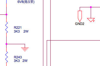

good deal, is Q217 bypassing r247 causing the amp to come on? I'll go ahead and cut it out till i can get another ordered then. Thanks for all the great help folks! 🙂 i assume i should resolder r247 back?Yes you can, just solder emitter and collector pads

it's been removed and the amp still, comes on so it might of been a good part? 😕Hi,
Ground the collector of Q217 and see what happened.
Well, my amp still works and sounds great! I think if I order a new transistor I'll just order every one that is on that board and replace them all. Might as well replace as much as I can while the board is out. Another thing I wondered was maybe the original 4013 chip was bad and, when I replaced it whatever ruined the original, may have instantly ruined the new one as soon as I plugged it in sound possible? Thanks! 🙂

the amp still comes on with Q217 removed oh no! 🙁
There is diode D224, try to remove it's pin
I have the amp hooked up right now but, will unhook it after while and check that. here is what I have been using for reference testing points on all transistors is this the correct pinouts?There is diode D224, try to remove it's pin

should be
I was looking at that diode on the schematic a while ago I think when I unhook the amp again I'll remove that board and test every component I can for opens or shorts by lifting legs. I know when I order the Q217 I cut out I might as well order all new transistors since they are cheap anyway to help make up for shipping costs. Thanks again! 🙂should be
The LED's it is turn ON/OFF by Q217 thru diode D224. Check the resistor R250 that it is in series with the LED's.

Check by diode tester and ohmmeter Q217 collector to ground, what you get? When you unhook it of course.
