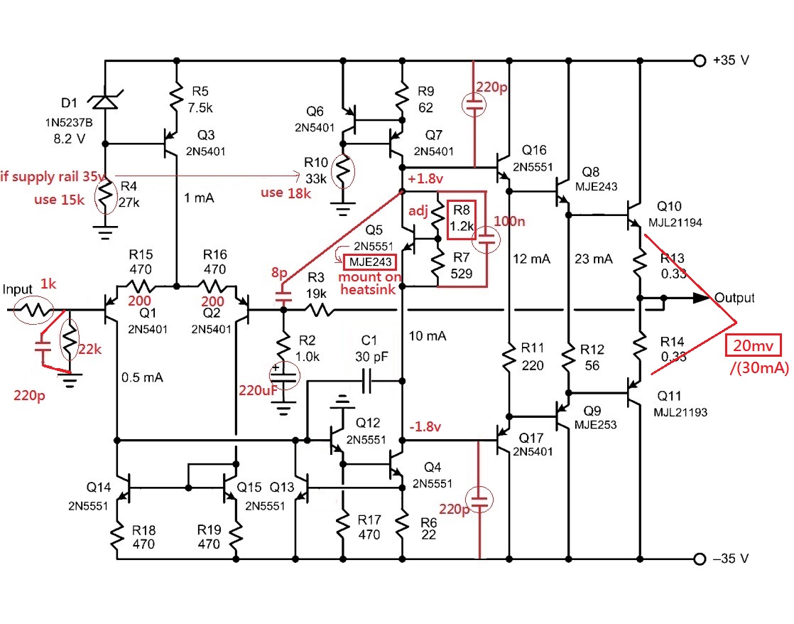

Hi Patrick, I first fitted the 8pf cap which seemed to cause some oscillation.
Then I fitted the two 220pf caps. This stopped the oscillation when connected to a speaker 6ohm load.
I get a nice sine wave output when connected to a load.
I will do the remaining mods as you suggest tomorrow but it looks like the 220pf caps have made the difference.

Yes, the 220pf caps are very important, so that I suggested first in #17
https://www.diyaudio.com/forums/solid-state/351771-parasitic-oscillation-2.html#post6136684
The others caps just to make the amp more stable as kind of compensation.
For your second amp channel output all negative supply voltage, maybe the wrong PCB layout or misplaced transistor in the positive supply rail side.

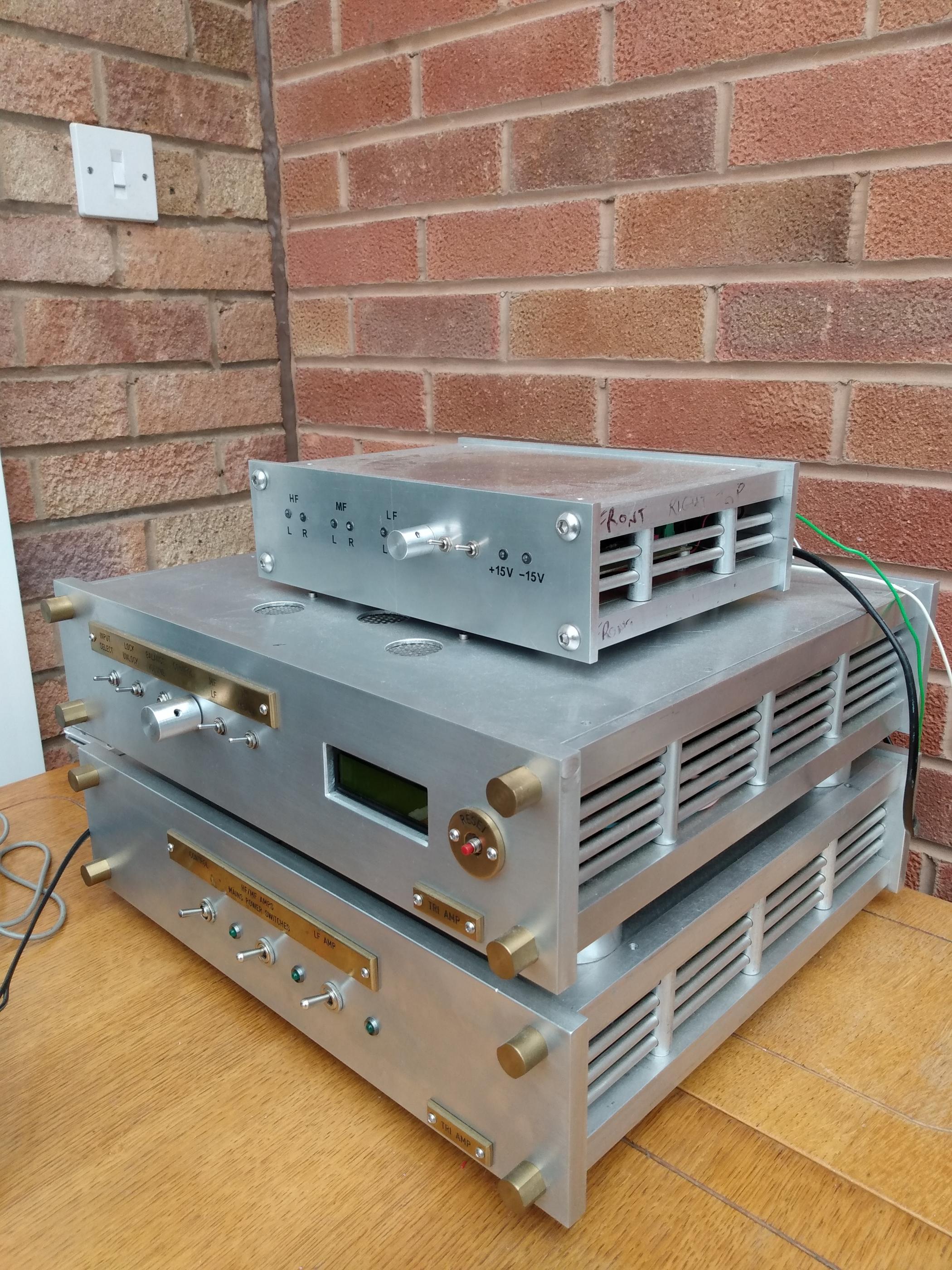

Hi Rick, have attached photo of my triamp, the small top unit houses the speaker protection circuits, need a total of 6 separate units as there are no cross overs to the speakers. The top cabinet houses the filter, amps, attenuator, controls, small power supplies, and is completely full so there is no available space. HT is 60mm but I will be putting the speaker protection board on top of the filter. I also have an earth collection PCB with over 30 connections, this reduces to 3 main earth wires to the power supply unit. So it is a major job to find any space. It's my own fault for building such a complicated audio system. But I do thank you for being so generous. I would like eventually to build another triamp perhaps using three of the BC amps, that would be a great system.
Attached photo

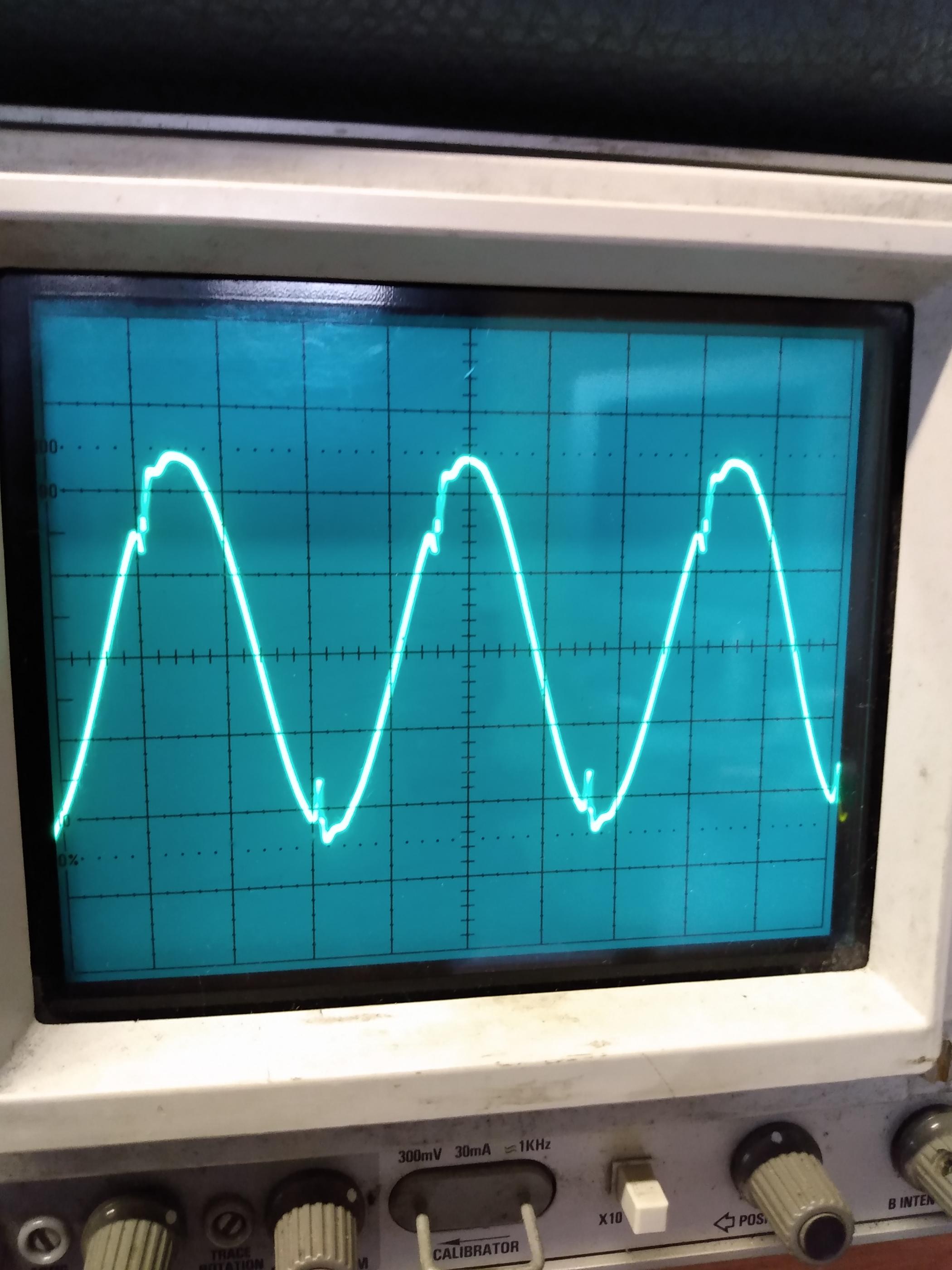

Have done the modifications to the amps and although stable the waveform is poor. It is the same from both channels. Attached picture is the sine wave output at 5khz.
Any ideas on what is causing this

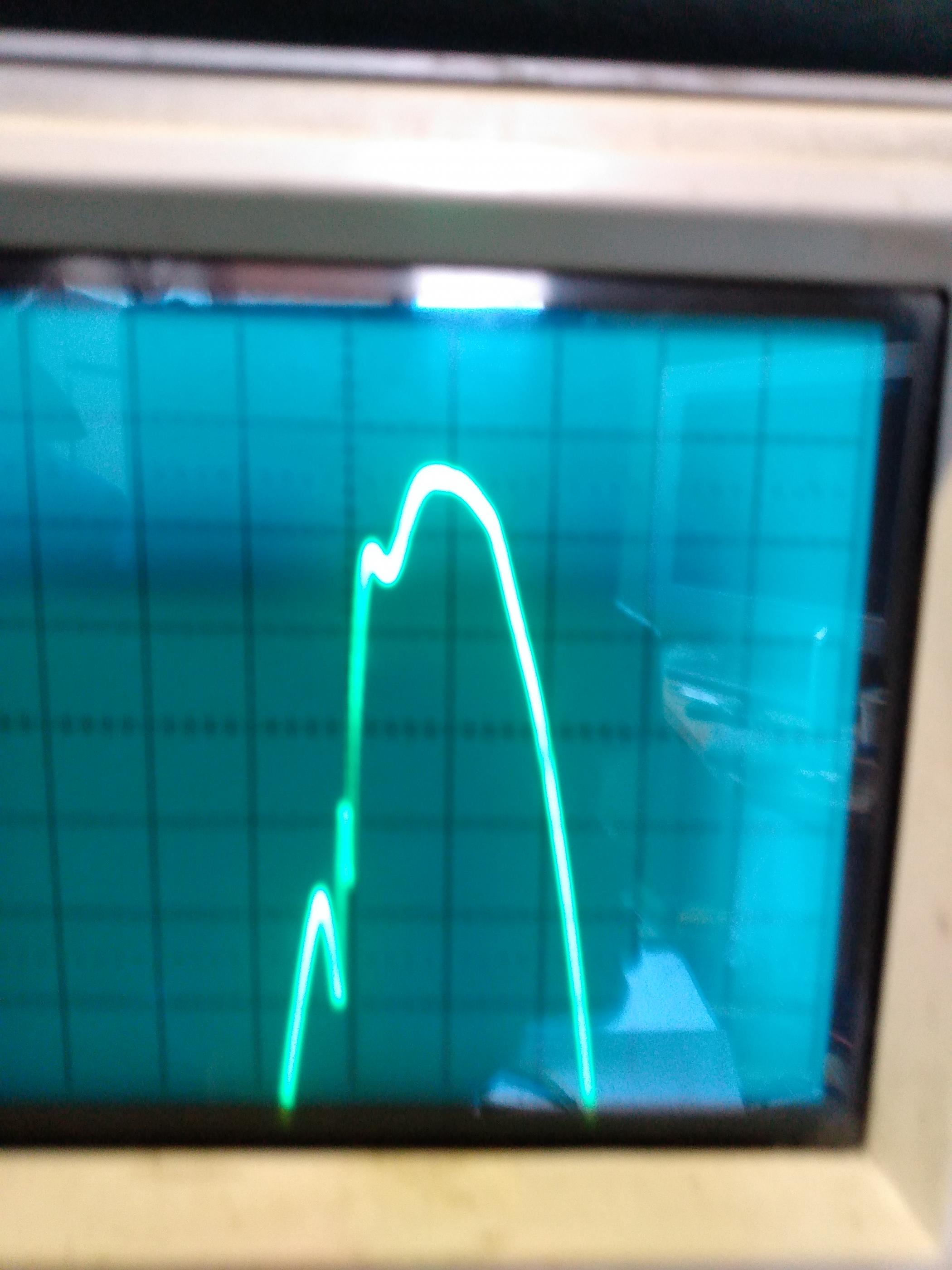

When I had a nice sine wave I was testing with a 100hz input signal and the sine wave looked good except there were slight gaps in the waveform which when magnified showed a small distortion. But when I increased the frequency I got the distorted waveform as in the photos.
first make sure your bias voltage(R18 value) is correct set for the amp so that the output power transistors has suitable bias.
second you check again each stage current is run correctly as the schematic
you have scope so that it is more easy for you to measure each stage curve and find out which stage has this problem.
What is your amp's operating voltage, if it is like +-35V then you may simplify your amp with less stage.

Your bias voltage is definitely not enough for your amp, so that it output with distortion, to avoid distortion the "output power transistors must at least have 30mA bias current", so that you measure between both "power transistor's emmitter must have a 20mv reading(if your emmitter resistors is 0.33R)".
To get the correct bias voltage, you have change R8, you fixed R7 value and only change R8, you can calculate R8 as below (all resistor values in ohm)
Bias voltage,"you need total 3.62v" = 0.6 + (0.6/R7)*R8
You need to fine tune(R8) the bias voltage so that both transistors have enough bias current.
Do you add the 220uF cap to resistor R2 ?

The R-L on the output effectively decouples from the capacitance of the speaker leads (we're talking about high frequencies here) in order to maintain Nyquist (frequency) stability - which hopefully is achieved using an adequate pole in the forward path (the 30pF - or more - Miller capacitor).
In fact, there's dual reason for the decoupling of the output - and that is to isolate the emitters from the capacitance presented by the speaker leads. (Emitter-followers hate load capacitance - they tend to oscillate. Hence the practice of base-stopper resistors - another recommendation.)
