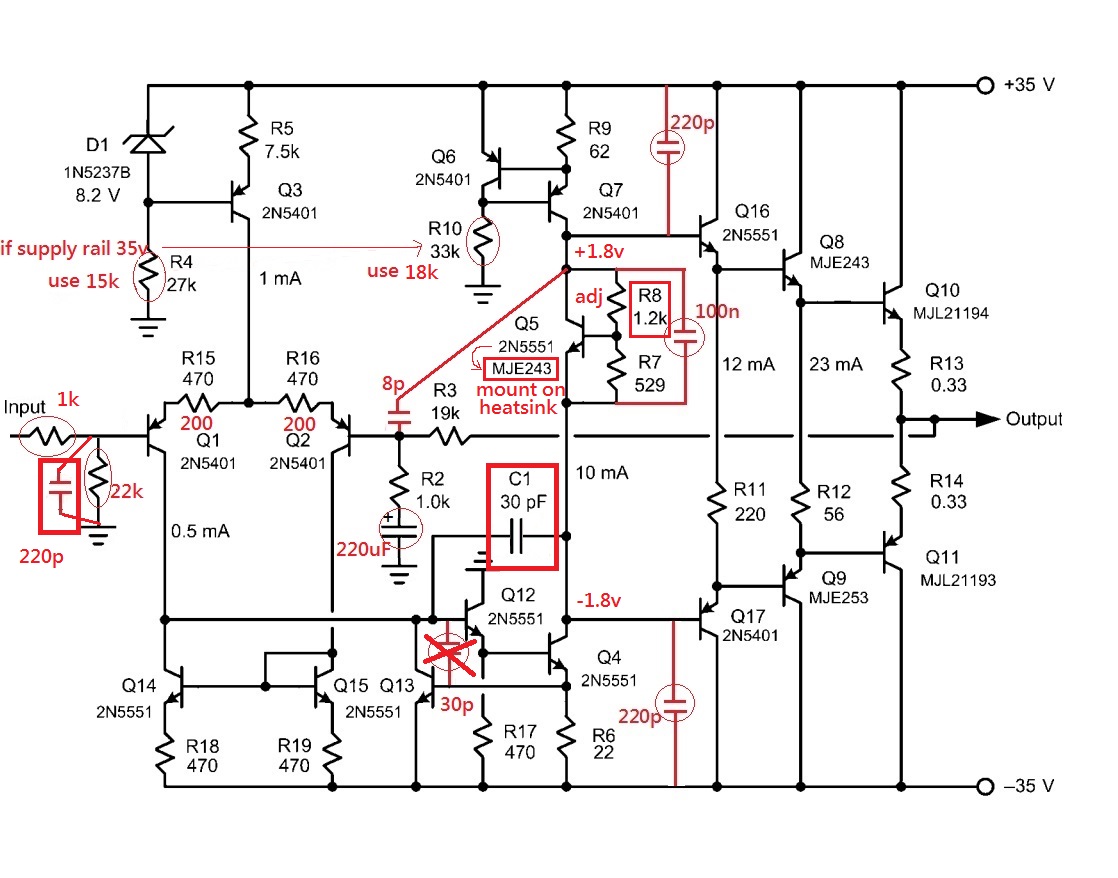

If you are using Q12 you need Q13 or a resistor in Q12’s collector. If you have neither you can get bad clipping behavior.
Adding decoupling to the rails, near the output transistors, will often cure load dependent oscillation. Adding the 5 to 10 pF cap from the VAS output to the summing junction is usually a good idea in circuits with a high open loop gain. Anything where you add another stage besides the usual diff pair./VAS almost always requires it.

Hi Patrick, I first fitted the 8pf cap which seemed to cause some oscillation.
Then I fitted the two 220pf caps. This stopped the oscillation when connected to a speaker 6ohm load.
I get a nice sine wave output when connected to a load.
I will do the remaining mods as you suggest tomorrow but it looks like the 220pf caps have made the difference.

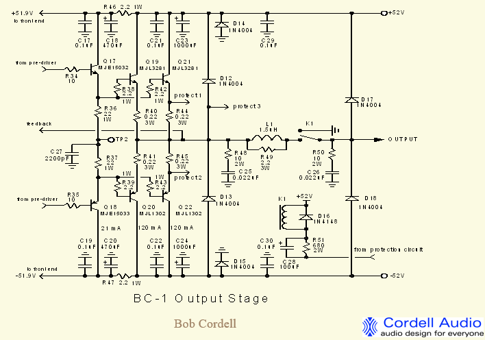

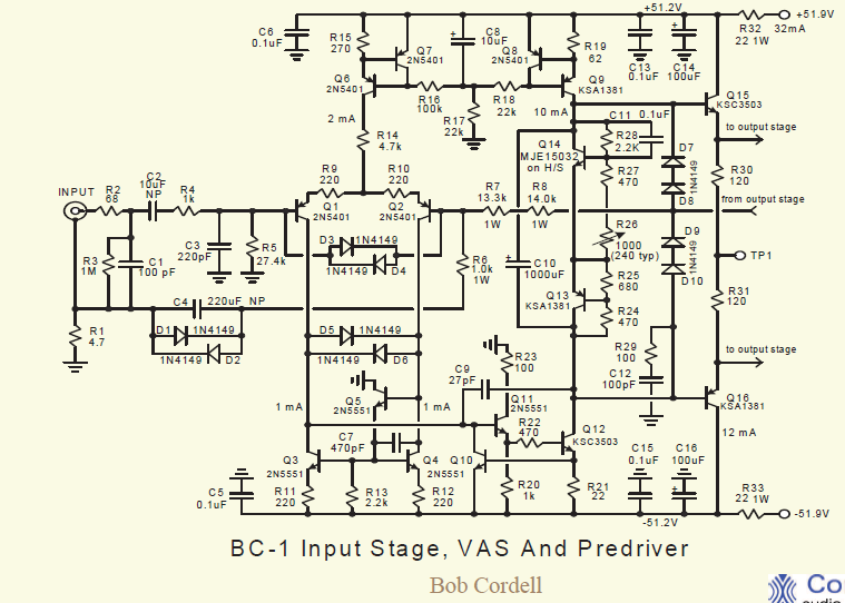

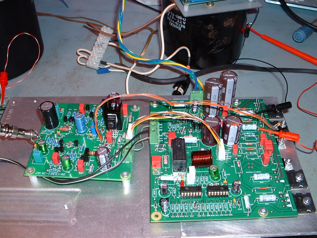

I am not sure if I can help you or not but I did work with Bob Cordell as I did do a layout of the BC-1 design that he presented at BAF. It was done in two boards. I have a few extra boards if you want them just PM me. All I ask is a small donation and pay for the shipping.
The AFE schematic is shown here which is for the pcb on the left. The deign is complete, fulled tested and characterized but there are mechanical challenges involved in packaging it in the current configuration. Bob would like me to do a new layout so that the design can be used in a DIYAudio chassis, I am contemplating that.
