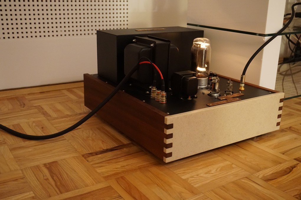

My GK71 (red color on the left) and GM70 (at the middle) are visible at this foto, I'll show the auto-bias arrangement, and yes, key parts for sound quality are good caps, I widely use 0,1uF silver-mica caps for shunting.

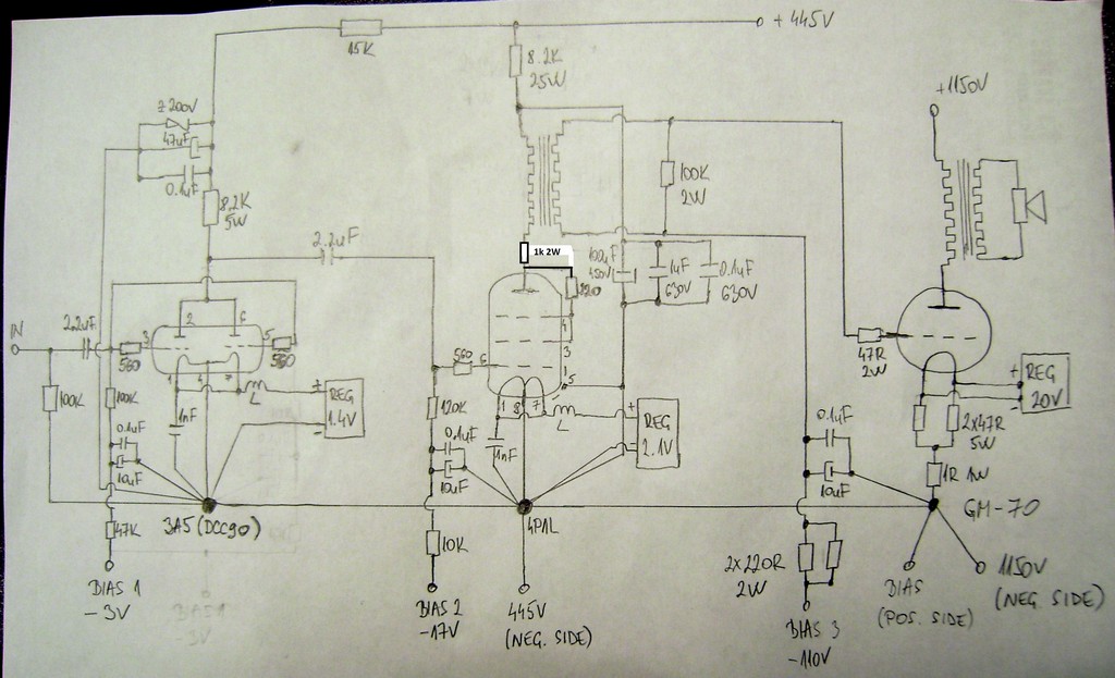

I'll be able to post something with schematics at the end of our local day (its a midday here at the moment).

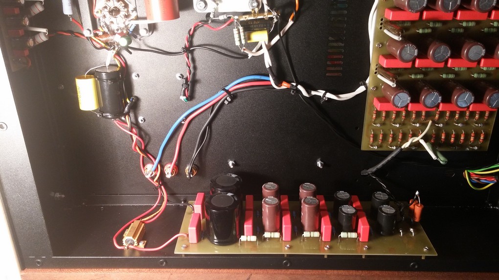

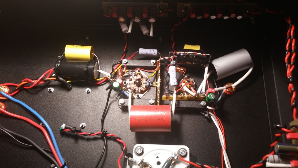

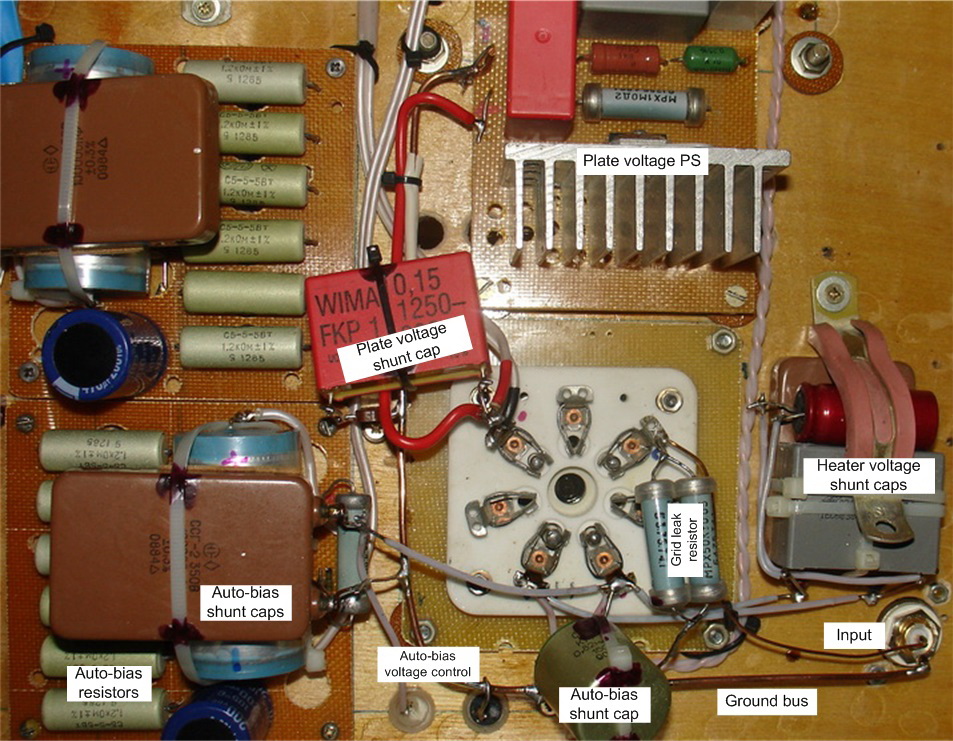

I post here the picture of GM70 socket with some wiring.
First I should mention, that the heater PS affects sound, therefore its output is shunted by caps close to GM70 heater pins (470uF Elna Cerafine, 2u2 polypropylene, 0,1uF silver-mica). Heater PS follows a spirit of that by Rod Coleman, but its current source is assembled on power jFets kp903a. The + of the heater PS is connected to the ground bus.
Plate voltage +950V is supplied via the transistor "virtual battery", and shunted by WIMA FKP 0,15uF 1250V just at the plate pin. This helps to avoide B+ variations under signal, what is good for bass notes reproduction.
Auto-bias voltage is formed by six 1K2 5W wirewound resistors (three in parallel, than each triplet in series). The cathode resistor value is 800 Ohms.
Tubes operate at "easy" mode, bias voltage close to 72V, current = 72/800 = 90mA. Tubes will serve for long period. The "resistor" is carefully shunted - 470uF Hitachi lytic, 20uF polypropylene, 0,82uF polystyrene, 0,1uF silver-mica.
Output trafo - 40cm2, turns ratio 50, 4 Ohms speakers (PMC EB1i). Output impedance of the amp is around 0,83 Ohms.
Input stage - EL803S Telefunken in penthode, driver stage - 6S4S DHT tube (300B would be even better). Volume pot - 10k DACT. Interconnect cables Analysis Plus Siulver Oval In 1,5m. Speaker cables (biwiring) - Stereovox 600 and 2x8mm2 to bass section. CD player Yamaha S2100.

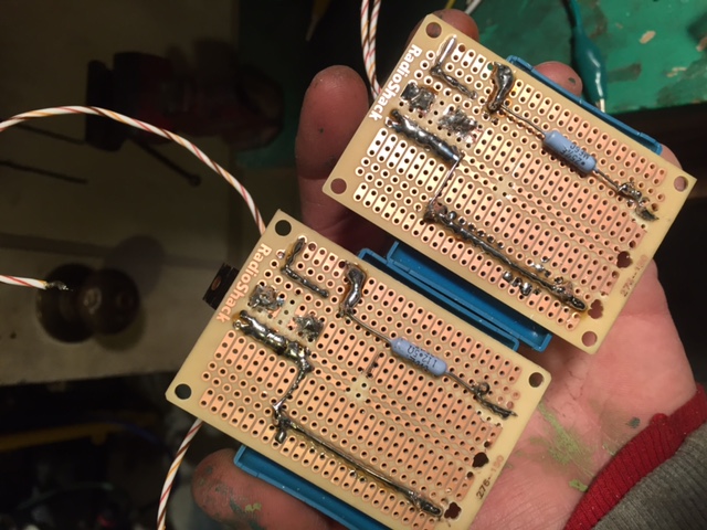

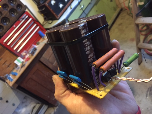

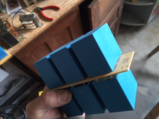

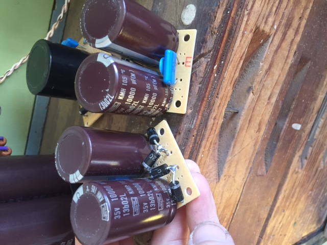

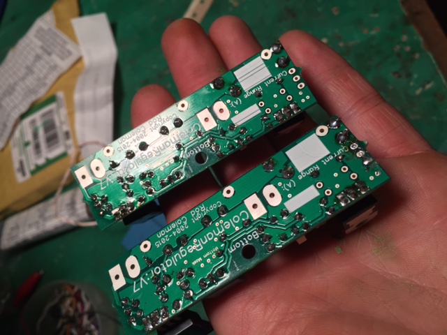

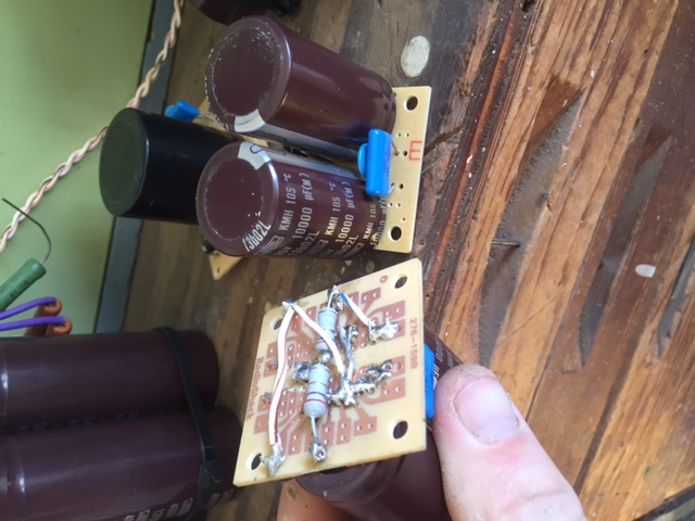

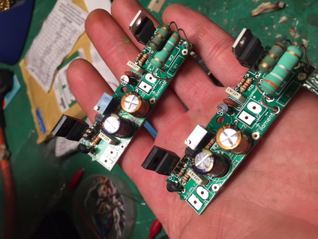

Hi All

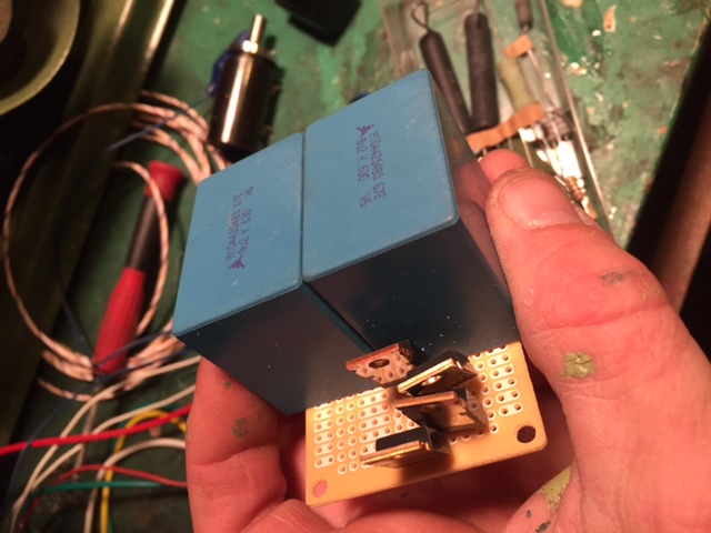

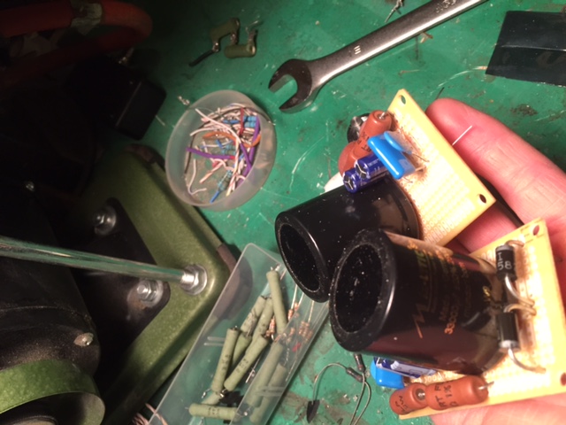

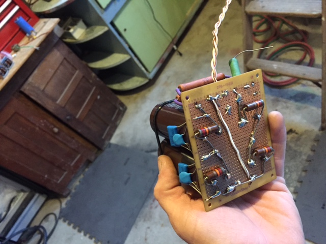

Just a quick update, on my way out the door. Last night finished last of boards that I had to design. Last is Rod's board, but that's almost like cheating with instructions hi hi. Tonight hopefully I can start doing layout and get some holes drilled. I want to finish these chassis.
I've included pics of The Bias supply and the B+ and the DC heater for the D3a.
Also included pics of the main -120v Bias for the GM70, and the cap boards for the HV
The rest is figured out but a lot of it is just chokes that go on the chassis and are wired to these boards (like the D3a B+, looks like not much on board, but it's a choke input supply in an LCRCLC config.)
So yes, still long ways to go but most of the math is done for now at least.

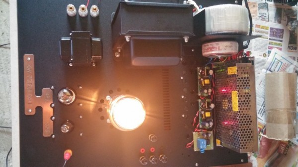

I've attached my GM-70 all DHT project pictures. I think that everything is self explanatory. PSU for B+ is CRCRCRCRC. Heaters are powered by modified SMPS, GM-70 and driver tubes also. Every tube has its own SMPS.
From my standpoint, chassis you are going to use is WAY TO SMALL for 4x GM-70 tubes, but you'll figure that out if you put 4 on that chassis 😎

IMO, heaters could be powered by standard 24V SMPS, tuned to 25-26V, and the excessive 5-6V are to be lost at the intermediate (between the SMPS and the heater) CRCRCRCR. The last CR should be with sound quality C and R. I used this approach in gk71 project, and the heater voltage had near 0,1mV ripples peak-to-peak. Without CRCRCRCR one would have around 100mV ripples of heater voltage.
That's right!
I use the same approach. I've measured my amps with R&S Audio Analyzator to fine tune it and everything is as expected.
But, I'm not promoting my amp, I'm just sharing my experience and I can tell that chassis is too small for 4 pcs GM-70. Schematic can be modified later, but to change the chassis once everything is done is much more work ...

Also, Flikoman, I see you are using IT as well. Your schematic is nicely drawn, by the way. Which IT are you using, and have you tried any others (other IT's or other coupling schemes)? A ny positive/negative results?

Yes, I try to draw it so everyone can read it. It's much easier that way.
IT is DIY. My colleague and dear friend Davorin (he is registered here also) has much more experience than me. He got ahold of some iron for chokes and he experiented with them and found out that they are great for IT's too.
Specification:
- (2 : 2) or (1+1 : 1+1), or (2 : 1+1), or (1+1 : 2), or (1 : 1), or (1+1+1 : 1), or (1 : 1+1+1)
- 10kOhm : 10kOhm connected as (2 : 2); 20Hz-20kHz +/-0,5dB with Idc=25mA
- Idc=30mA (max)
- Pmax=2W
- L > 200H with Idc=25mA with all sections in series (connected as choke)
- L > 54H:54H connected as 2 : 2
This is universal IT. I use it as 1:1. Sadly, I never tried another IT but measurements confirm this statement: " 20Hz-20kHz +/-0,5dB with Idc=25mA", so I'm very happy with it for now.
