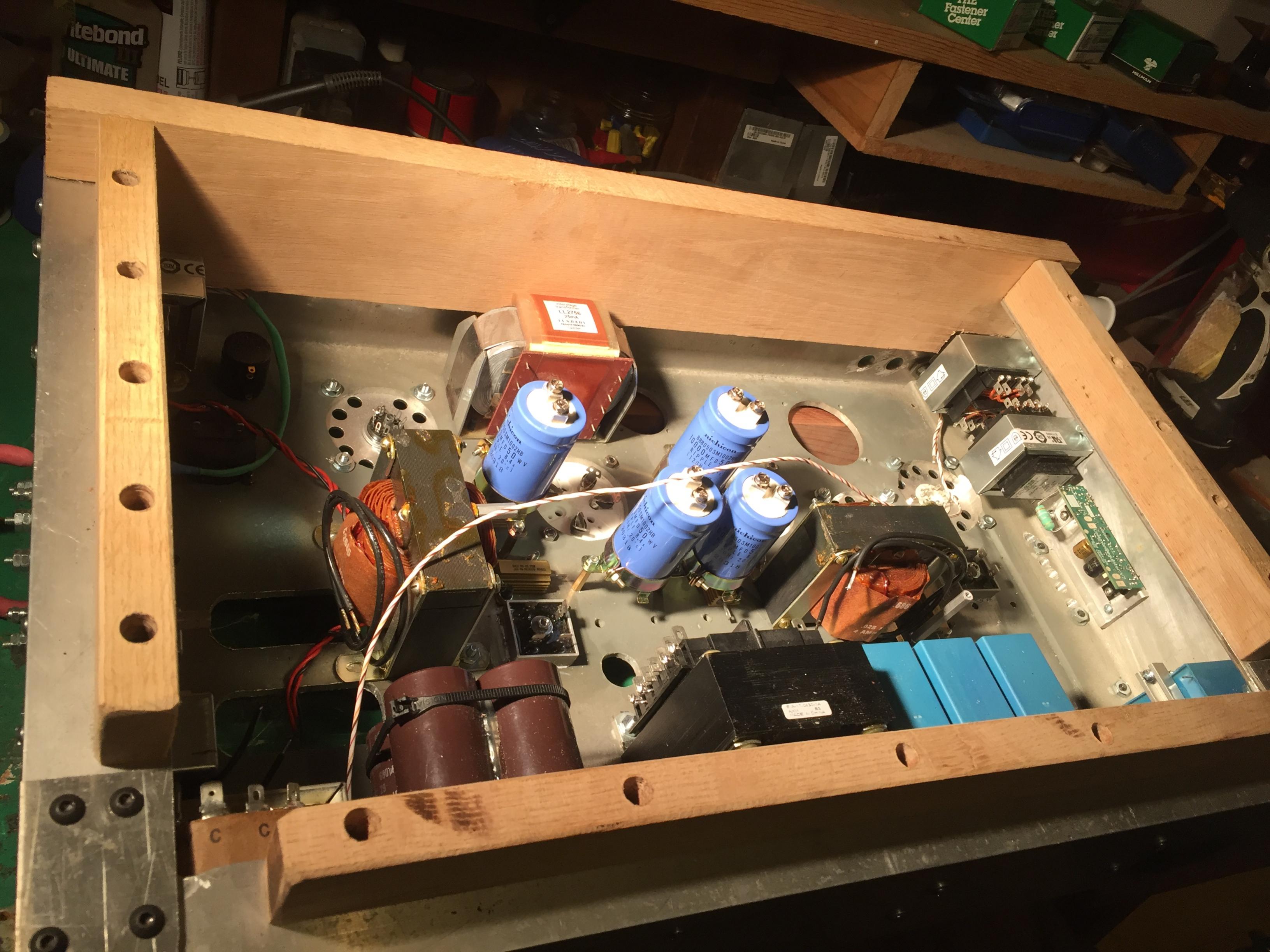

Hey guys, been saying for a week or two now that I would upload a pic. Haven't made too much progress lately. I'm building a shed out back. This will allow me to take the garage attatched to my electronics workshop, and actually devote it to woodworking/welding. As you know, with amps of this size, an hour here and there isn't much. But I did get few things done since last. The supplies for the heaters are all in. Rods boards already were last post, but now the resistors are mounted on chassis (heatsinked) and the caps are in. First RC cap in the choke input supply notwithstanding, but that's just a couple big polys from R to neg on the bridge. Power switch is in. AC receptacle is in. Main fuse is in. And the biggest thing, the wood. Solid oak that I drilled and countersunk. Then tapped the holes in the chassis. Each piece has 5 M5 hardened bolts. They only see vertical weight anyhow, so they could handle hundreds of pounds fine. But being oak they can take the whole weight of the amp even if you were to pick it up like a briefcase. And see how the side pieces are set in? That lets you pick up the amps from the side without reaching fingers under the amp. Plus the extra height, great for cooling. I had this idea all along, but it worked out a lot better than I thought it would, and so I'm pleased with it. Hopefully more to come soon. Thanks all
Nice that you got some vent holes above those filament regulators, and possibly you've got access to the trimpot on the boards to be able to adjust filament voltage from the top side with a small screwdriver through one of the holes?
One thing I did on my amp was to put test points for the filaments somewhere on the outside of the chassis as well, so that I could measure them without opening the amp up, to make sure they're settled in at the right voltage after hours of running, and then if you can also adjust those trimpots from the top side with the chassis closed, that's really handy as well. Especially handy when changing tubes.

theoj,,,,,yes I can acess the pot topside. I set it up to use one of those insulated flatheads, the all plastic type. Once you know where it's at, it's pretty easy to find, but this prevents chance of damaging something. What I might even do, at some point, is solder on a tube going from the vent hole that is used, that goes down just about to the trimpot, so that the insulated screwdriver has no choice but to be in the right spot.
This is an excellent idea! I'm definitely going to implement this, rather than fiddling with a flashlight and screwdriver.
Thanks...yeah i like it, you can make the tube as long as you want so that it drops out just right above the trimpot...I got the idea from those old ohmite type pots that had that sort of connection you screw on to the pot and it recesses it into the chassis...you know the ones, they're hex holes and you have to tighten them with a big 10mm hex driver...

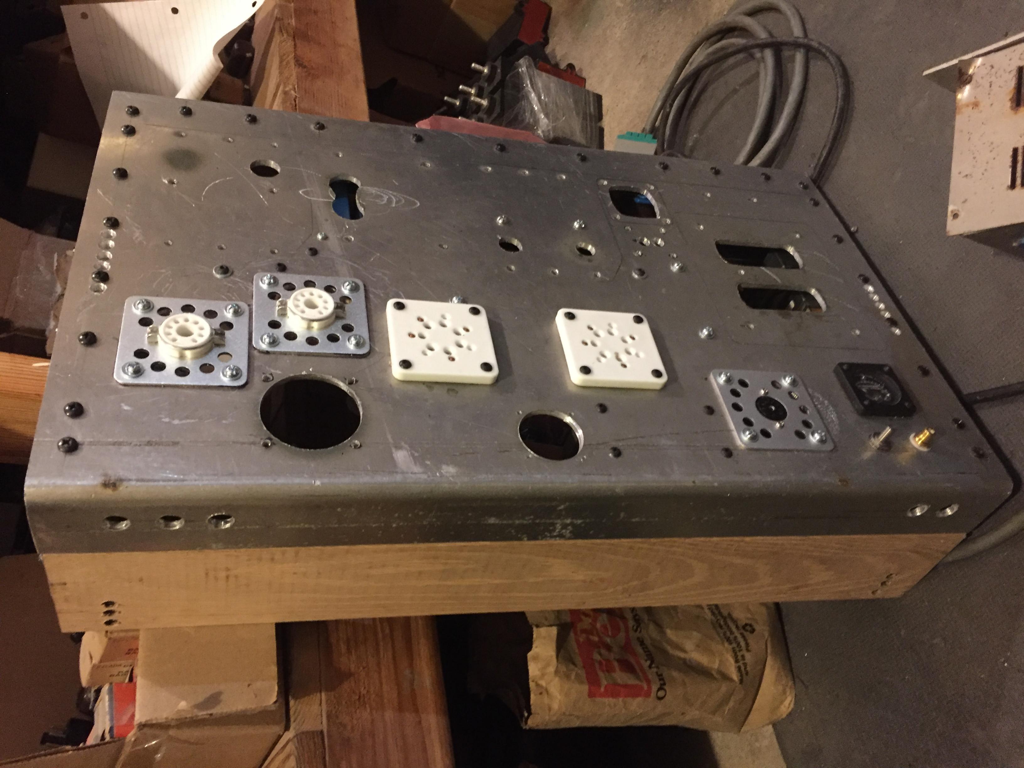

How funny, I was just perusing the forums a day ago, thinking how I need to post. Haven't finished, although all the boards (power supplies, biases, filaments, etc etc) are all finished. Chassis are all drilled and finished. Just need to put it together! Been busy with work and school. I ended up taking 2 classes this semester, another welding and a machine technology. It's been eating up my free time. But I can feel the urge of electronics coming back on, especially with summer and class ending. Just got this little guy yesterday. It's nice knowing that the next time I need some oddball tube socket, nice plate cap, whatever, that I can just make it. Higher quality and free other than time.
