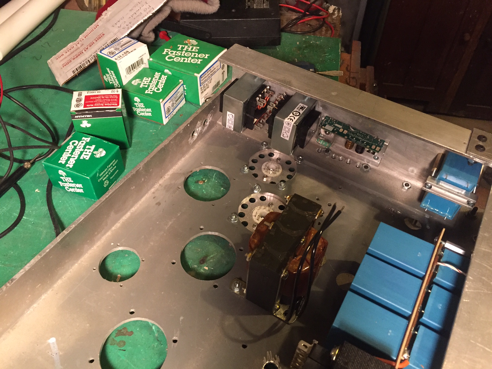

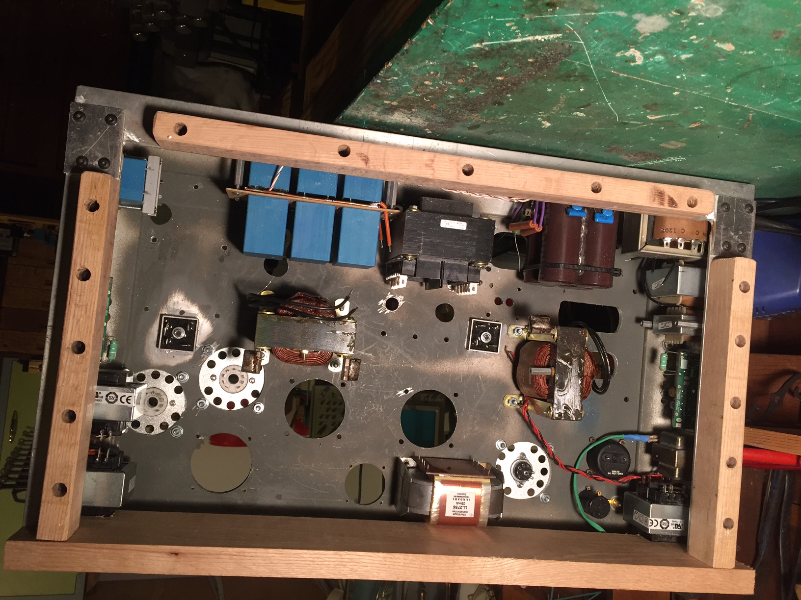

got some more done. The rest of the chassis is done. All solid oak. No, there is nothing that even gets warm mounting to it, and remember with amp flipped it's all on bottom. I secured it by drilling and then counterdrilling the oak. C-clamped that to chassis and then drilled chassis. Then tapped those holes. So each piece is attatched with 5 M5 bolts into 3/8" of hardened AL (yes, there is such a thing as hardened Aluminum, and that's what the U beams which make up the sides of my chassis are). Also drilled the holes for the 15Hy chokes for the GM-70 bias supply, which are going topside. Also mounted the LL2756/25ma interstage transformers, and the RCA input, and the 250ohm D3a bias adjustment pot. Also mounted the bridge rectifiers for the choke input supplies for Rod's regulator boards. I'm getting close to the point of having to start wiring the couple of spots which will be buried by other components. Like the input RCA to the D3a socket. The boards for D3a Bias and D3a DC filament will go on spacers above those two wires, which would make it impossible to get in there with a soldering iron. It's busy in there, yes, but I'd like to think I'm doing alright so far at keeping it neat. Down the road in the future, if something needs to be changed, at least 80% of the components (and all the ones that have a "lifespan") are just 4 bolts, easily accessible from the outside, and that board is out.
Well, I'll post more soon. Next will be drilling all the holes for the capacitor clamps, for the RC filter and CRC filter parts, of the "(rc)LCRC" regulator board supplies.

What type are the bridge rectifiers? Take care if using ordinary PN type for the filament raw dc - compared to Schottky, these can get hot, and make some noise. Though with choke-input, these differences are much lowered.
Hi Rod. They are KBPC5010, 1000v50A. I had a few things on hand (including Schottkys) but I went with these because
a.) The package, easy mounting and heatsinking to the 4mm plate which is the top of the chassis. And the physical size vs heat, low stress
b.) Being choke input and having the regulators I didn't figure noise would be an issue
c.) Being 1000v 50A they drop almost 2V which is great because I end up right at 25.6V (without having to use any more than .3R in the CRC)
I will probably snub them anyhow, just because it is so easy (same goes for a lot of the different PS caps in here with bypasses). A lot of that it's doubtful wether there is any sonic difference, in this particular setup, but I might as well.
Agree?

Yes, Loren, this is highly recommended, since heater supply subsystem is sitting in the signal chain. Maybe, after snubbing, some additional RC stage with neatly shunted C would be useful.
With SMPS for heater, I used 5 stage RC (cutoff frequency around 40-50kHz).

Yes, you have reason it out well, especially since you need the extra drop. I'd probably take care to keep the rectifier cables nice & short, to prevent noise EM-coupling to the signal wiring.
If you need lower drop after testing, the schottky STS1545FP is well-rated and mounts directly (isolated package).

that's what I thought. I have an RC stage after the Bridge (snubber), then the choke, then CRC. After that, Rod's boards. With neatly shunted C in every part of that (across the RC and across both the C in the CRC), and with then the Regulator Boards which further block any switching noise, I think I should be ok. Actually I'm sure I'll use some of the caps I got from you Vladimir 🙂. And yes Rod, if it turns out in the end that I have a volt or two to spare then sure, I'll change out to Schottkys. But shouldn't be as I did pretty extensive testing before i started installation. Since these have so much under the hood, being PSE, I want everything to be lowest heat possible. Hence the 9A heater transformers, and the R's only being .3r. If you look in the pic, the one bridge you can see right in front of one of the transformers. Other one, you can see the holes where transformer goes right below it. Wires from AC from transformer to the bridges will be all of about 2.5", and that's just because of the transformer height. After that, about 2" to the rc filter. Only after the DC goes into the choke, and after the CRC after that, do the wires get to be 6" or so just to get them over to the Regulators. And 6" to get from regulators back to tubes. The CRC will only be seeing just over 1.2A ripple, so those 10,000uf should last for a while, as they are rated 8.8A (each) .
Also, the actual cathode R (because remember I'm attenuating cathode a little bit for balance) is going to be also only an inch of wire>resistor> variable resistor,>ground. And as far as the grounds for all of these caps, and the cathode (as well as all the other grounds in system) I am going to do a ground bus. For heaters one that comes from negative tab of bridge. For GM-70 comes from center tap. etc etc etc and then all connected to chassis in one spot (except for heaters, of course)

One should remember, that diode recovery noise falls into high MHz region, and in your RC just after bridge I would recommend C shunting with silver-mica 1000pf, 10000pF, polypropylene 1uF. Also I suppose that you put 0,1uf-10 Ohms chain on EACH diode in the bridge.
I would rather use schottky, and put additional RC for suppressing excessive voltage.
So you really think that the bridge will make that much noise? I was understanding it as diode noise used to be far more of a problem with older PN diodes. And with Rod's. boards as well? If it were just a normal filtered D.C. supply straight to the heathers then I wouldn't question that yes, use Schottky. But for this, you still think it (noise) could be an issue?

My Regulators will remove (almost) any such noise in the conducted path.
The remaining hazard is only that EM-coupling of noise-pulses into signal wiring, or other parts. The recovery pulse is a large current, with only a small voltage showing up, so this means a low-impedance B-field. Short cables to the bridge will help, and longest distance to the susceptible parts/cables, and loop-area of the grid-cathode circuits kept minimal. DACs should not be placed near to the amp's transformers. The schottkys will always emit lower noise, though, if in doubt. Standard bridges usually specify nothing about recovery time, because it's not usually relevant.
