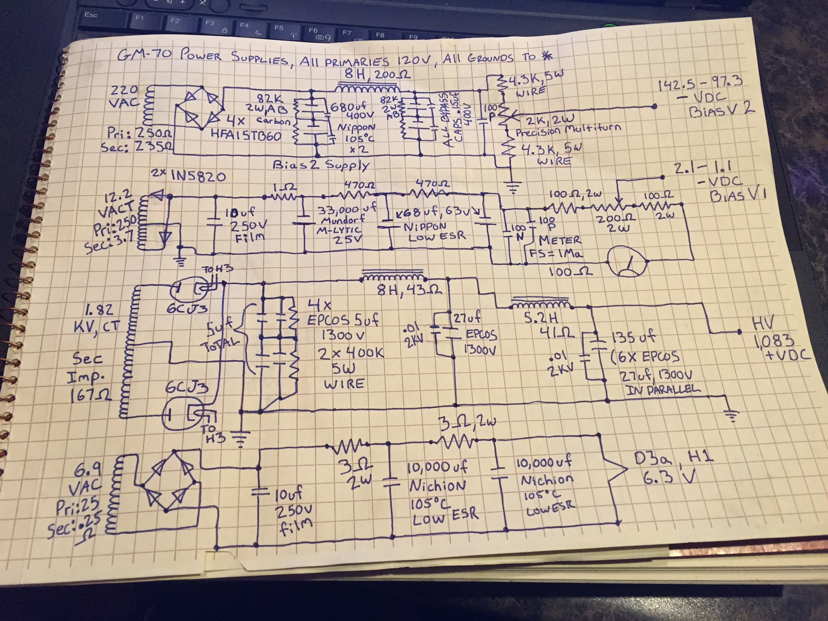

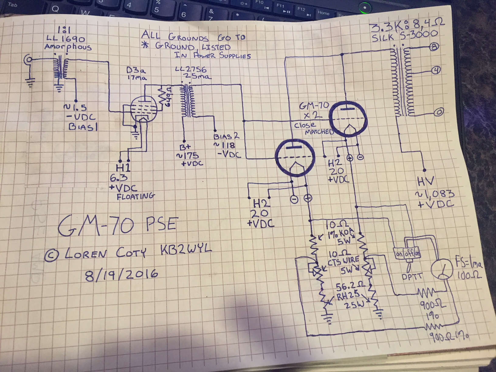

Ok Guys
Actually, I have a few different kinds of HV wire...But yeah, no 600V crap on the HV. And the ptfe, and ftpe, on the rest of it because I like how it doesn't melt and is resistant to, well, everything.
Thanks for all the comments...keep it coming..Here's the amp minus my few mistakes and the things I forgot to label. And here's the power supplies, minus the B+ for the D3a because I'm still waiting on those transfos, and the Filament supplies for the GM70, but they are simple, 10,000u, .025H, 10,000u.
Anyway like I said, keep the comments and constructive criticism coming. Thanks guys.

I would consider doing the bias circuit differently.. You're at the mercy of the wiper on the pot.
Here's a thread where I asked for some assistance with my bias supply.
http://www.diyaudio.com/forums/tubes-valves/283101-bias-circuit-fixed-bias.html
You're right, I need to connect those on the schematic. One of the reasons I chose the voltage range on the bias's was for that reason, that if something goes wrong I am just at the highest voltage. But doesn't do much good if it's not hooked up like that. Will do, I'm sure I'll be posting another more final schematic, but it's close enough at this point for stuff like this. All those "umm, were you going to..,,".

Hi all. So been talking with Rod about the filament regulators. Just in case anyone doesn't already know, Rod stands behind his products in a way I only wish more manufacturers did. He has been very kind putting up with my questions.
I have not done Choke Input on a heater supply before, and it turns out that these Triad VPS-36-4800 that I have here are perfect for the job. I did a test run with .025H, .47 ohm old stancor chokes. Using them, into then a CRC of 10k, .82ohm, 10k, and loading the whole thing with 6.6 ohms (GM70 filament) I get 25v, perfect for the regulator board. I'll post schematics later hopefully if I have time.
But there is a bit of hum from the choke, and I don't want that to couple electrically or physically to anything else. Remember this is all on a monoblock.
So I figured I'd see, who else here has done choke input DHT? Rod suggested a filter and I'm sure going to try it, any one else have a scheme that worked for them?

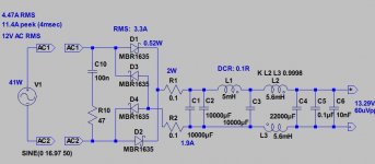

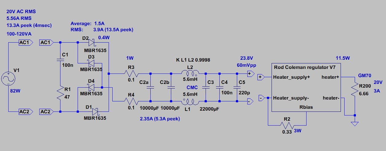

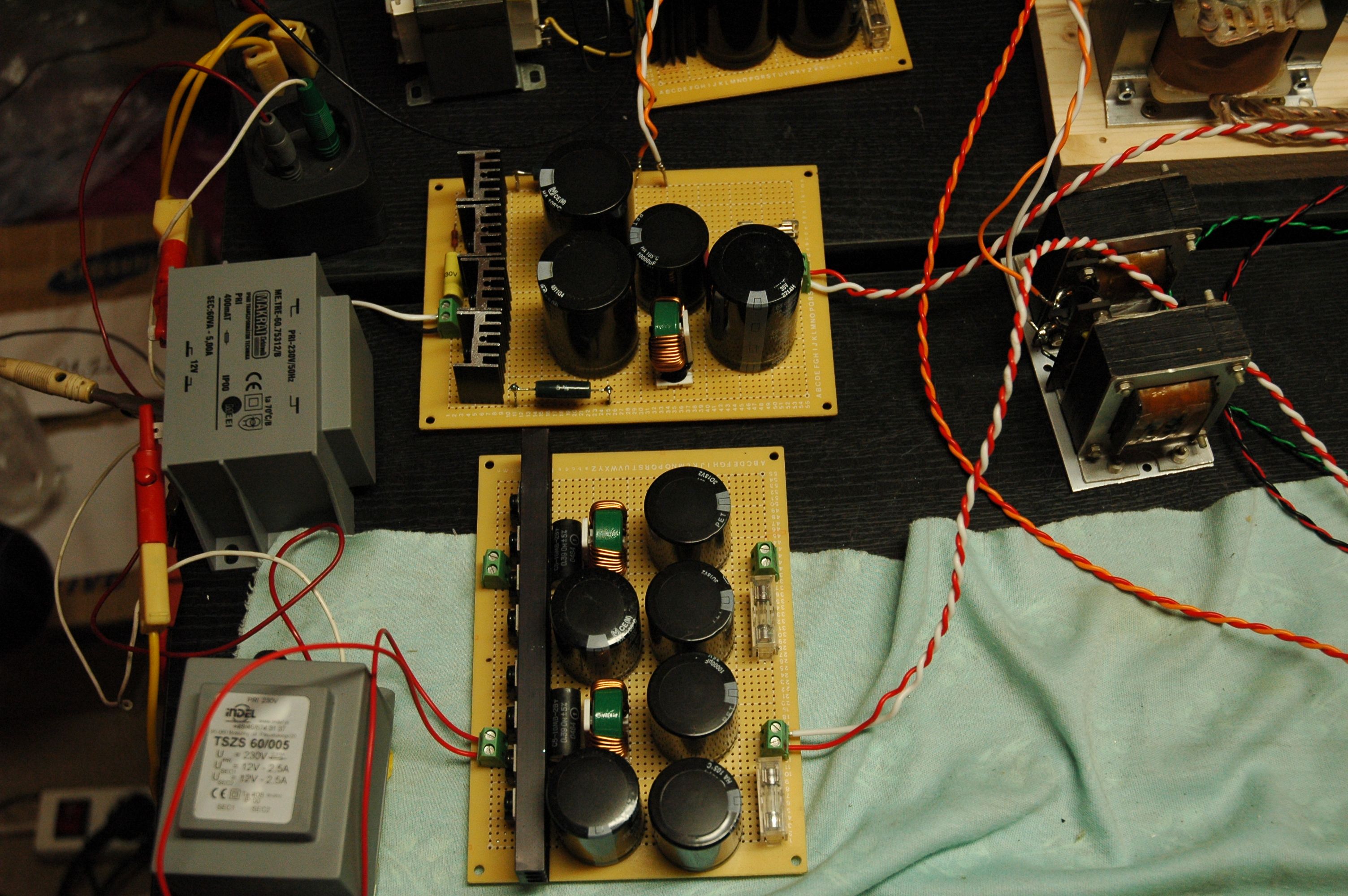

Hi Loren,
I regularly -for years ago- use r-C-L-C-CMC-C type raw DC PSUs before Rod's regulators - over 2..3A - (or r-C-CMC-C below it), because I notoriously hate filament hum.
I tried choke loaded one, but the total cost was a little high (I only have appropriate core from amorphous material), and the result wasn't so much better.
Sample: one my 801a PSE filament PSU schematic and raw PSUs on experimental state (in middle 801a PSE PSU) .

Thank You. I tried real quick before I went to work with an rCLCRC and it worked great. This is dissapating a little more heat than I would choose if I was starting from scratch, but certainly nothing I can't deal with. The transfo is 36v secondary and arrangement was .1r, 30uf, .025H, 10kuf, .47r, and 10kuf. This gives me 25.2V, and I'm sure the ripple is very low. I'll sim it later but this arrangement leaves me needing nothing else than a few chassis mount .47 resistors...
For me it is just wanting to try the choke input, as well as having this stuff on hand...with an 18V parallel or 36V series transformer this seems a good way to come out enough above 20V for the regulators, so the current reduction in the transformer and possible benefits of noise reduction are just added benefits for me.
Thanks again, especially for the pics I enjoy getting to see others' work.

Those polarities look somewhat odd.Perhaps better like this ?
Direction of the arrows not conventional(+ to -) but electron flow (from - to +).
Mona
Hi Mona,
With my Regulators, you can connect either FILAMENT + or FILAMENT - as the anode return ("cathode" connexion).
Naturally, the bias must be adjusted to get the same anode current.
But many constructors have told me that the + side grounded sounds best, and I think it does too. I can't see any convincing reason why it is like this, so I can only say that whoever is interested, must experiment!

Thank you, Loren!
Yes, I like choke-input raw dc supplies, especially for Transmitter tubes. The reduced current-peaks makes a notable reduction is wasted power in the transformer, rectifier and caps - lower stress all around.
And nearby DACs and MC cartridge stages will be glad of the lower EM, and mains-conducted emissions as well.
