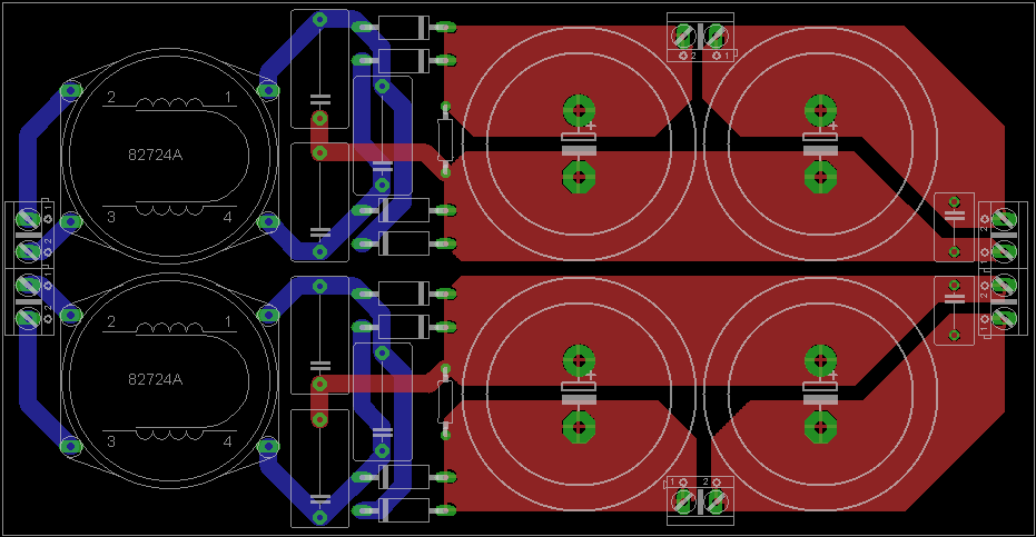

Next try.
This is the first draft of the Paradise Preregulator Board according to Joachim's schematic.
The board is about 157 by 81 Millimeters yet. Inputs on the left, outputs on the right, choke connections on the upper and lower edge.
For now, I just ran the ground connections of both parts completely independent.

Cool. And pretty universal. Maybe you could add a few Holes in different spacings for Caps & Diodes. But i see that this would lead to loosing Eurocard size maybe which is strongly undesired.
Another point: would it make sense to add a board for the High-Volt side with softstart, dc-removal, fusing comparable to what Dragan did in his Supplys for the ono?

... add a few Holes in different spacings for Caps & Diodes
Absolutely. Mounting TO220 diodes should be possible.
f you move the Input Connectors to the corners...
You are right, but that would consume the space needed for the mounting holes.
to add a board for the High-Volt side with softstart, dc-removal...
Soft start? Hardly needed here. DC removal? Negotiable 😉.

Just a newbie question to the chokes (B82724a),
they also have a vertical B82724j model with a smaller
footprint.
Will it work? If so, some room could be saved for
the fuse?
