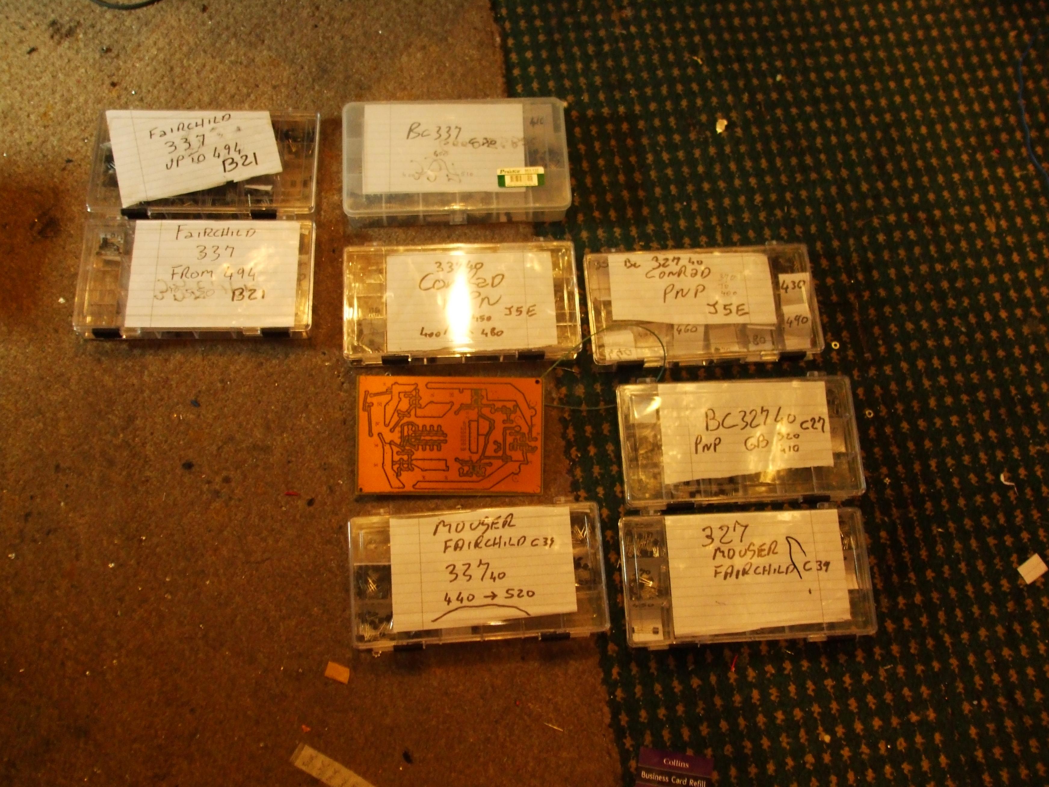

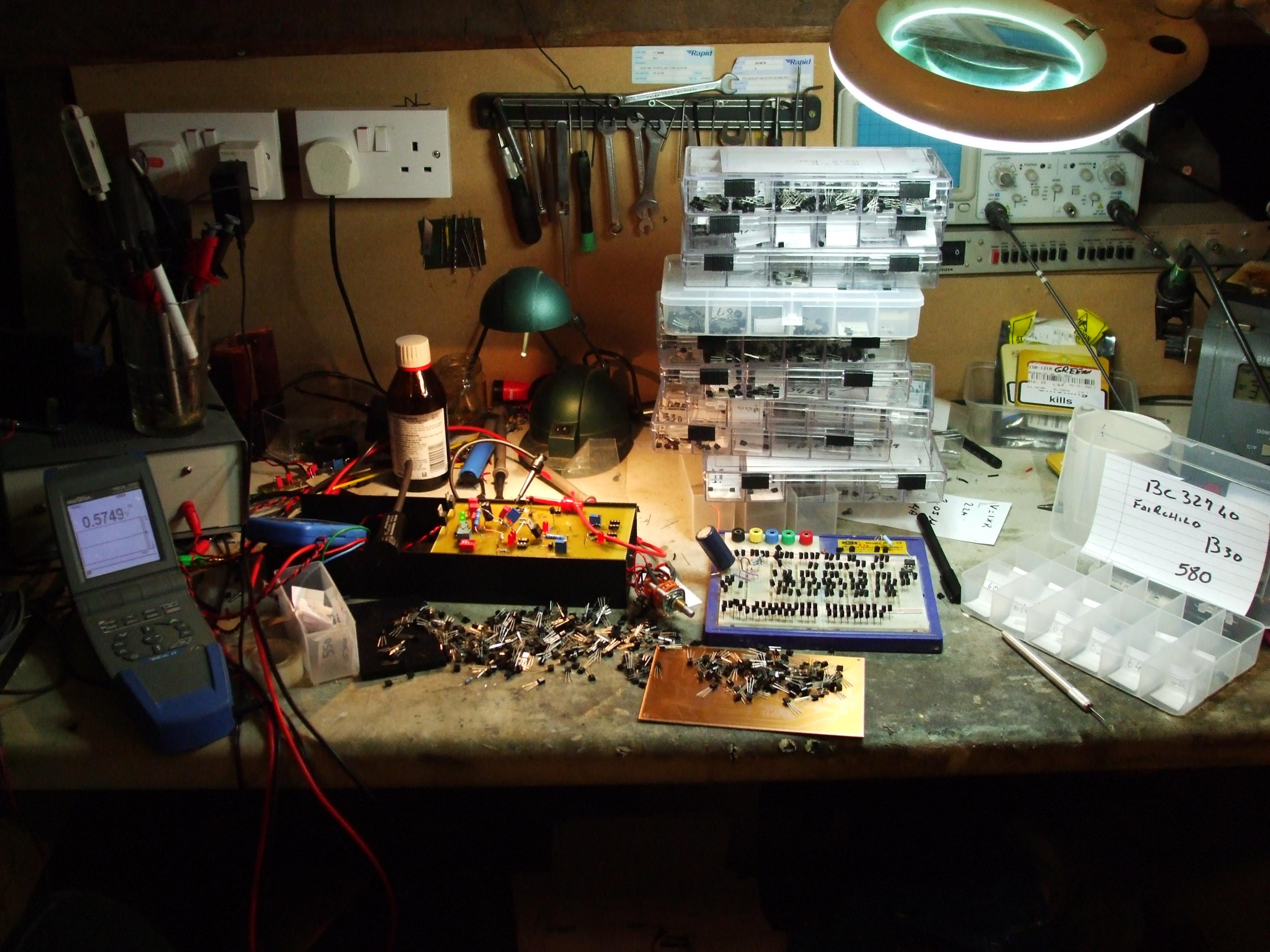

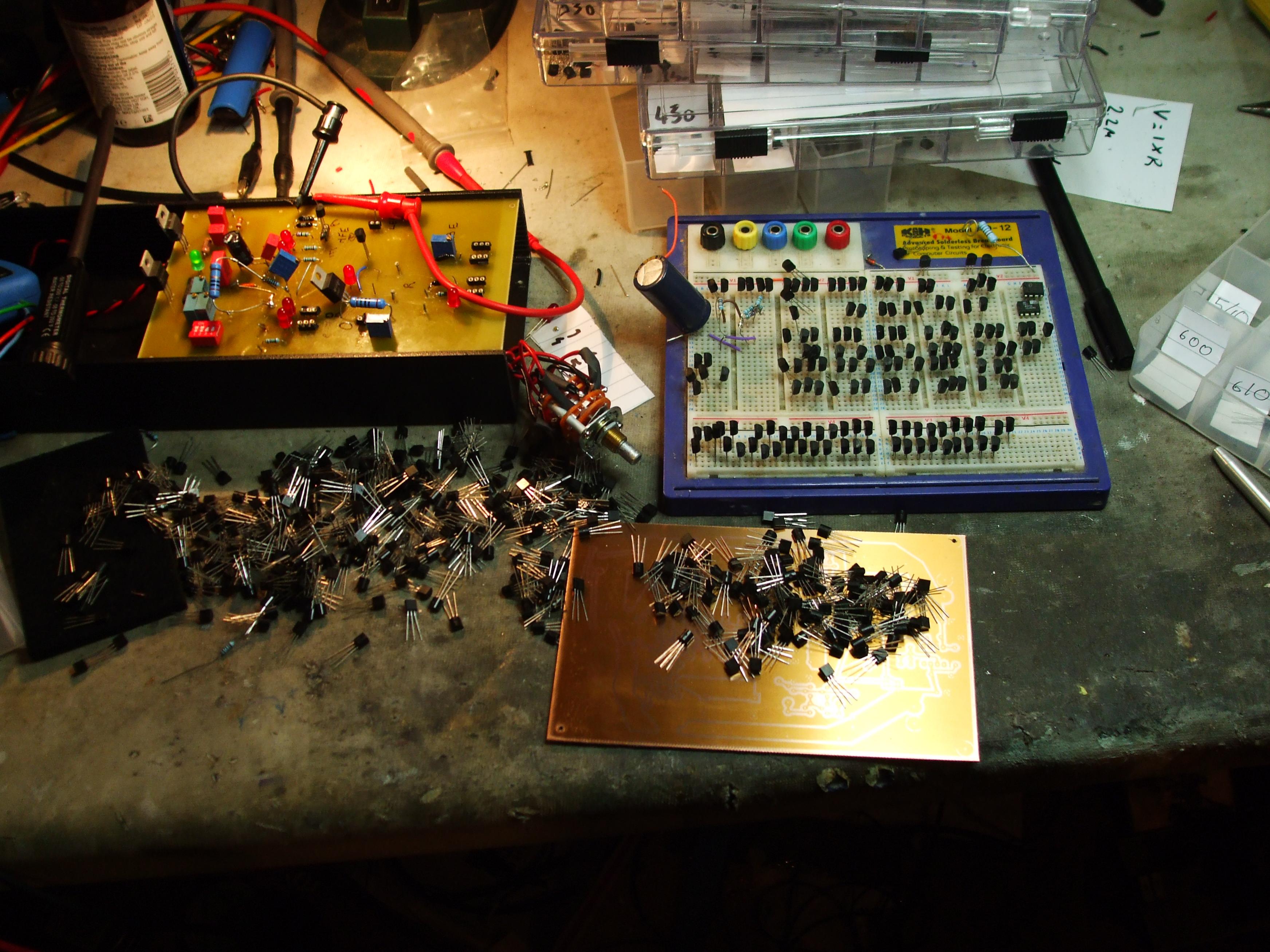

I know this has probably been asked before, but how close do the groupings of NPN and PNP transistors need to match each other in the input stage? Most of my NPNs are in the range of 460-500 and the PNPs are from 360-420. Could NPNs with 460 and PNPs of 400 be used together? I think I'm probably looking at yet another expensive Digikey order (first was to fix the group buy parts issues) for a batch of Fairchild PNPs. 🙁
The guide suggest 10percent or better to reduce offset thus it is a bit over the recommended values.
