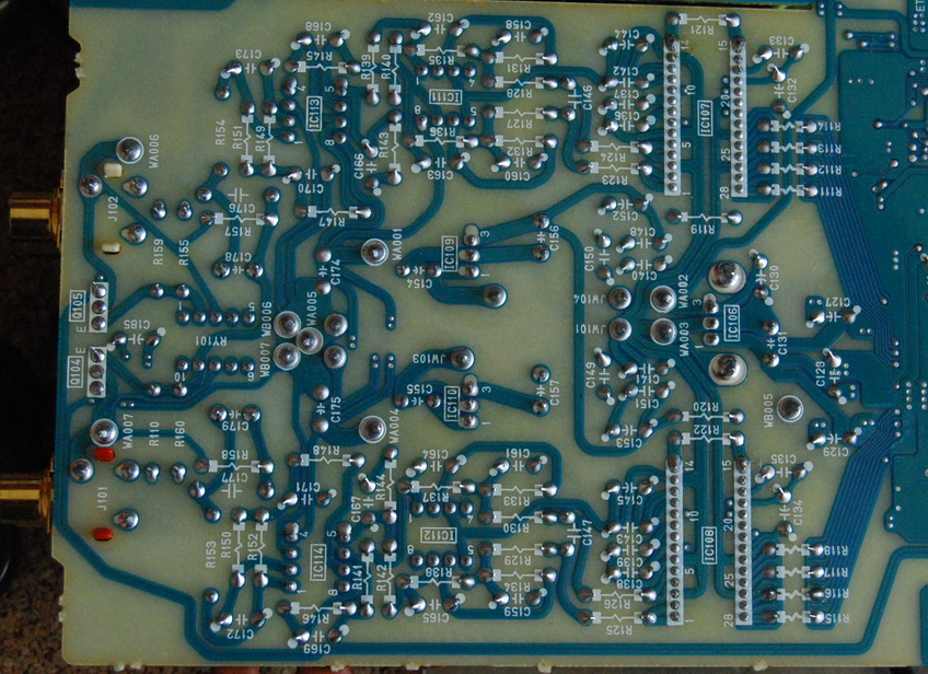

Hi Werner
Please see the attached pic of the board where I included parts numbers.
The output buffer fets 90 and 99 are in the center of the board.
Once I had to replace 99 to get things working.... also the top fet 90 (J310) should be chosen with a high Idss / Vp otherwise the buffer might not work properly and produce big offset.
Lads
Just I have changed Q 90 and Q 99 no difference ,
previously I have measured 2SK 170 as Bksabath has suggested
K 170= 10,5 mA / J 310 not possible to measure so.
