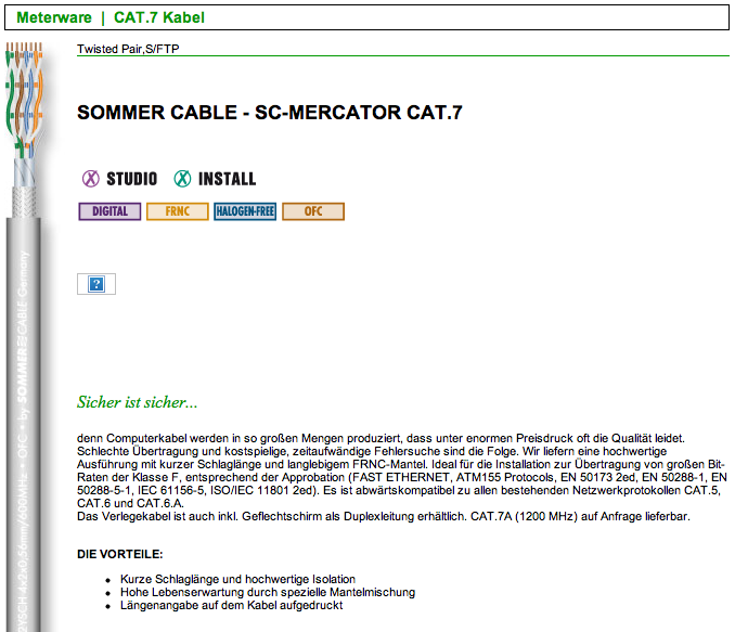

Anybody with a take on interconnects between preamp cabinet and psu cabinet?
Wire? connectors? Etc.?🙂
I use Neutrik Powercon. As cable you can use a big sized microphone cable.
I use Klotz and Sommer.
Looks good.

Hi pdul, I used a cable with 6 wires and industrial connectors:
DIN-Kabelstecker, gerade Pole: 6 SV 60 Lumberg im Conrad Online Shop | 733239
DIN-Einbaukupplung, Frontmontage Pole: 6 KFV 60 Lumberg im Conrad Online Shop | 733020
