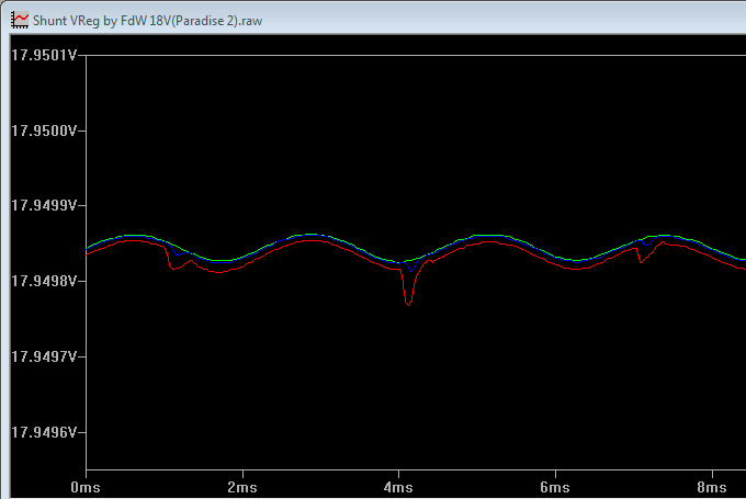

A quick run in the simulator shows these output residuals for:
Green 25Vdc, Blue 24Vdc and Red 23Vdc.
As you see 23Vdc is marginal.
It looks to me as 25 will be the minimum.
25Vdc is the recomended minimum as specified in Mpp #6462.
