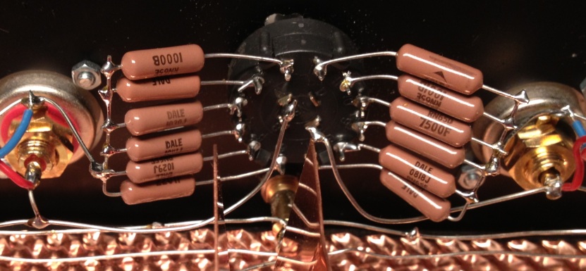

How do you implement input loading switch if you don't mind me asking?

Here you go.... Not fancy but does the job nicely. Resistors are Dale RN65 (10 / 100 / 220 / 470 / 1000 / 2200), the switch is from C&K with silver contacts.

Ok thanks Alfred, like they say -" a picture worth a thousand words". Just need to source the rotary C&K switch. I am still getting hum from my R3 , it is playing beautifully just need to get rid of it as it is obscuring the details. I will post a picture and ask for some advice.
