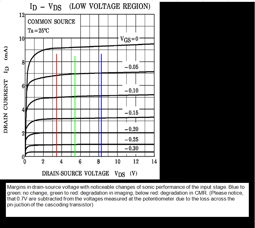

The top transistor in the Fet cascode has a certain voltage between gate and source, the so called Ugs or Vgs. The transistor down in the cascode, say the 2SK170BL runs at near zero Ugs. The difference in Vgs of the top transistor and the main transistor is the voltage that develops over Drain-Source of the down ( main Fet ) transistor. That voltage should not be too low because the down transistor is not very linear at very low voltages. Also ideally the Vgs diffenence should be the same in both channels. That requires to select the top transistors for Vgs, similar and as high as possible. Something between 3 and 5V is what we usually aim for.
You can interpolate the linearity of the 2SK170 from this curve that shows idle current at several voltages. You see that the first 2V are strongly bend. We would like to avoid that region. Over 3 V the curve is nearly straight. That means that the J-Fet is a very good constant current source in that region and that transfers into good linearity as a buffer.
This is of cause without cascoding and without the cascode current source we have in the Paradise. this two measures plus choosing the right condition for idle and Vgs give the Paradise buffer its exceptional linearity as long as the buffer works in class A.
This is the case when no more then the idle is drawn. For example we have 8mA idle and a 10kOhm load. The buffer can swing 80V in class A into that load. That is of cause not possible because we run the buffer on only plus-minus 18V.

Well, in the La Boheme phono this is for the input stage working in transconductance mode . When you do the Vds voltage too high in an input of a phono stage the noise will go up because of rising gate current so it is a compromise between linearity and noise.
For the paradise buffer 3 to 5 V is fine.
For selecting Vgs in the J310 cascode Fet you can simply build the paradise buffer with Idss selected 2SK170. You can build a little jig from DIL8 sokets where you can insert the J310 and then simply measure in the real circuit.
