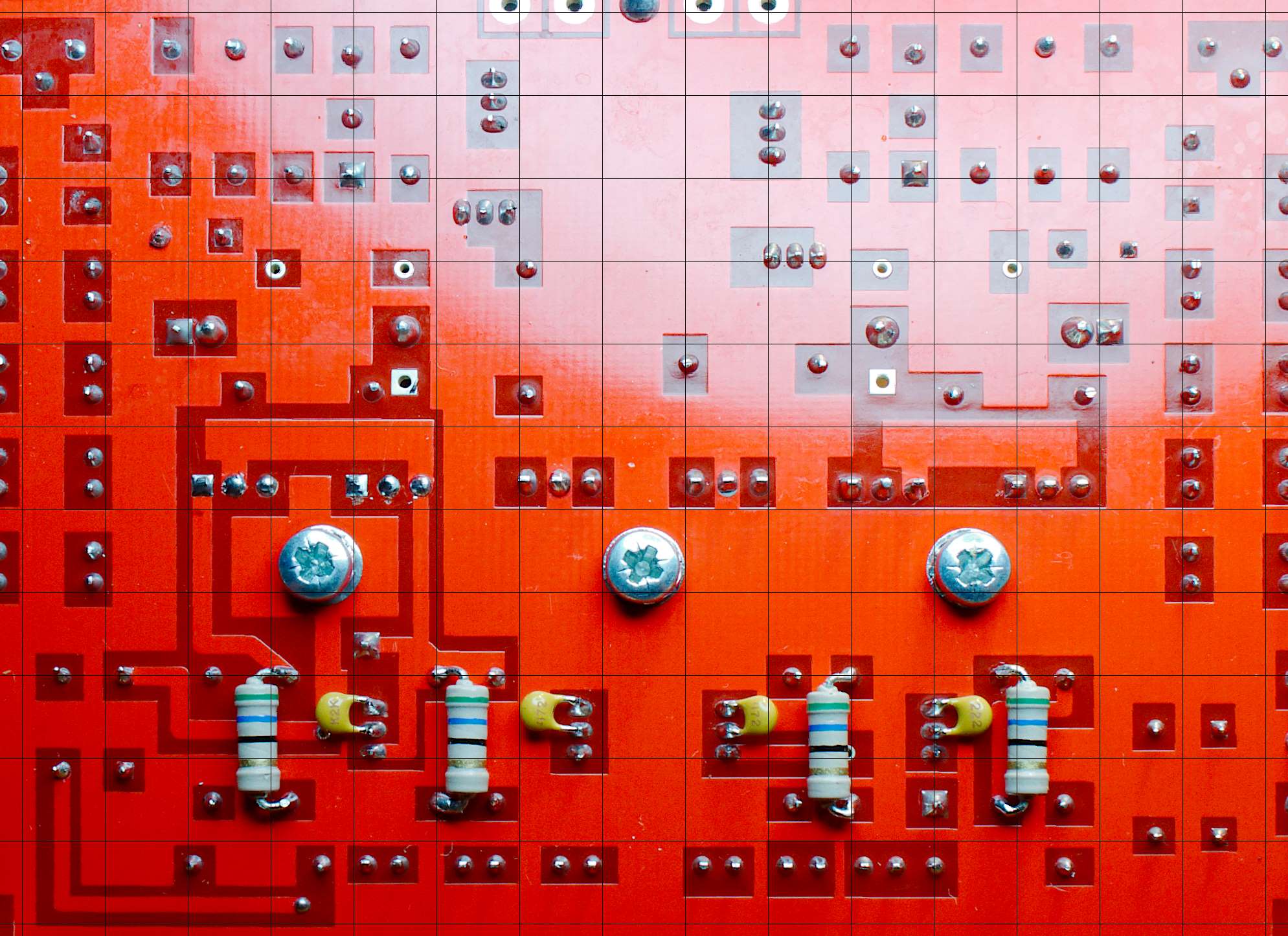

And here you can see the patches made in detail. The resistors are 56 ohm, it would be better to use 68 ohm but these where the nearest that sat in my stock. (e.g. 68 parallel to 330 is 50 (about)).

Hi Frans , sorry been calling you names😀😀. I thought that massive knob in the middle of the amp is the input resistor loading switch ie picture in the build guide. I don't have scope only a DMMs🙄. How do i know if the psu is oscillating?. MY R3 after the ground being fixed still have some noise on it esp the channel with higher voltage on pin 6 of IC.

Just do the counter measures, e.g. add the 4 capacitors, it does not harm anything. After that you will be sure it does not oscillate 🙂 even if it was not before (the resistors are not needed).

Hi Frans,
3) Added ce capacitors (as in the builders guide) but I had to use 4n7's and 2n2's to stop all oscillations.
jep. builders manual says:
The way to fix this is quite easy, put two caps of 470pF parallel to C-B of
Q104 and Q204, and two caps of 2.7nF parallel to C-B of Q102 and Q202.
so its better to use 4n7 and 2n2 instead of the values in the manual?
and should this be any special type of capacitor?
as i understand, the capacitors do no harm, whatever the curcuit is oscillating or not.
thank you!

Yes, that was the consensus from the simulations and some experiments, so I put it in.
These caps will limit the speed with which the current source will be able to react to line / load variations. When it is slowed down by this (and we are talking 2.5MHz), then the capacitors that are at the output voltages (C105 / C205, as well as the ceramic blocking caps in the amplifier) and the shunt regulator (which is not limited in its performance by these changes, as Frans pointed out) will have to work just a touch harder. No big deal.
As for the caps, a good foil cap will do (e.g. Wima MKS, FKP or similar).
Don't they slow down the CCS for bandwidth VS rejection performance to some extent?
Yes it does, it will limit the BW to just over 2Mhz (what is plenty). The shunt is doing the main work of course and that one will stay unaltered. My guess is that the CVS is influencing the CCS, for a future version I (may) have to alter the design a bit. Other measures (like the output capacitors) in the PSU and RIAA-decoupling will (for now) take care of that. As Hesener did say "No big deal" 🙂
