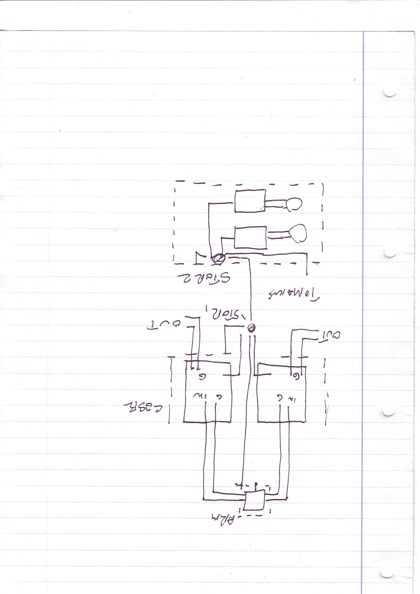

Hesener is there any chance of posting a picture of your input loading and grounding arrangement?Thanks Marra.
You welcome
Actually I forgot to put smiley on previous post as picture is upside down😀
And maybe is worth looking at how the output cables to the Pre-amplifier are arranged
As the Pre amplifier is earthed trough the mains I may be worth cutting the screen at the preamplifier ends and that is why I just sqibled Out on those
By buss of star I mean
Star one all wire to the same point enclosure, board 1, board 2,maybe the ground cable from the arm, this then out to a single cable to the PSU or star 2 as follows: Cable to star 1, ground from pre reg 1,ground from pre reg 2, eart of enclosure and this out to the main plug.
Please note that there are no other earth connection to the cartridge as 4 independent wires are used and that same turntables, Like my RPM4 used to be before surgery, have the screens of the Phono cables connected to earth at the turntable end and this can cause a loop and maybe noise pick up (I say maybe as ground loops issues are a real pain in the bottom.)

Hi marra and all,
here the updated assembly guide , check out the last two pages on case layout and grounding. we hope it helps....
Looks good Alfred 🙂
