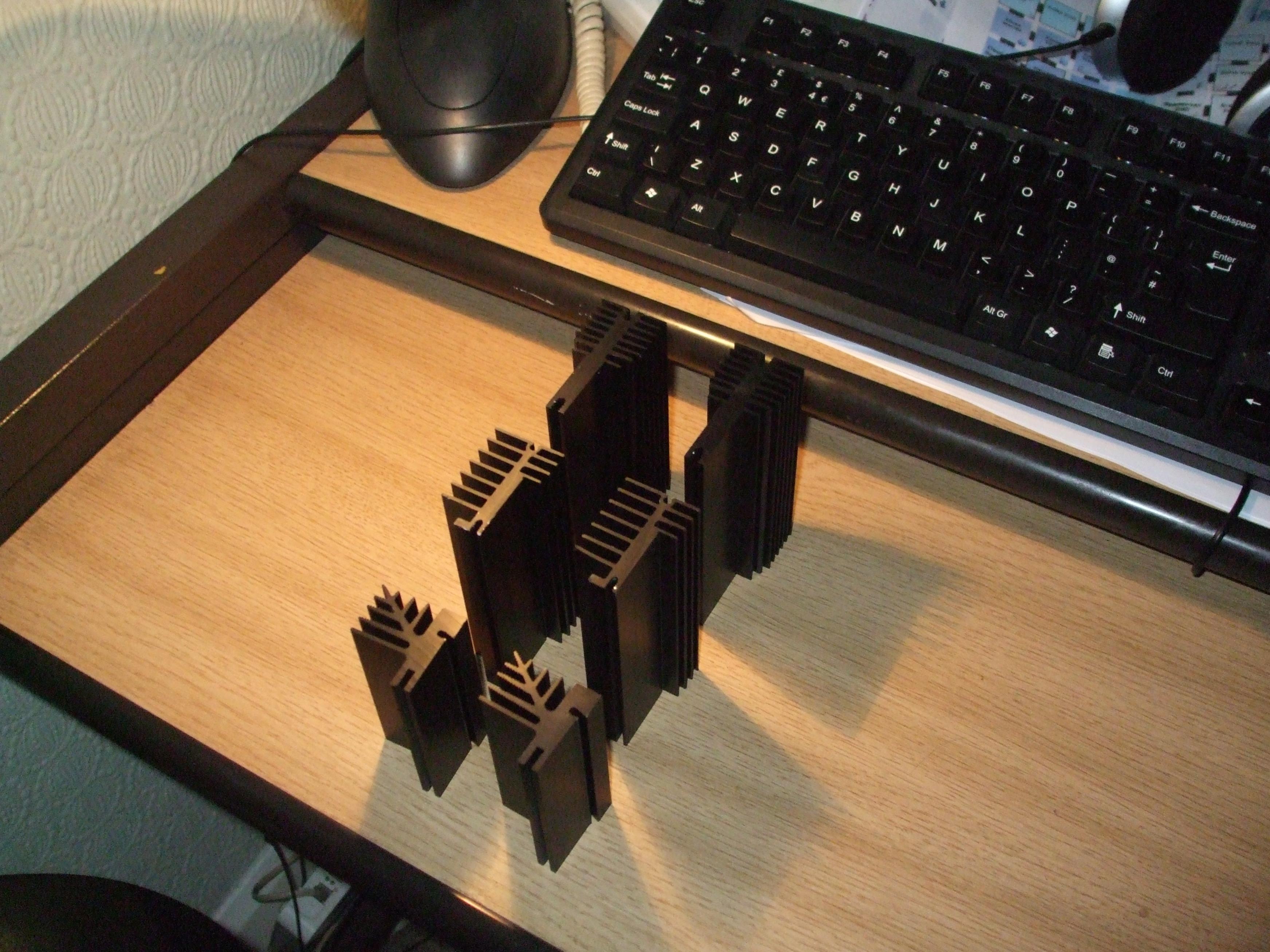

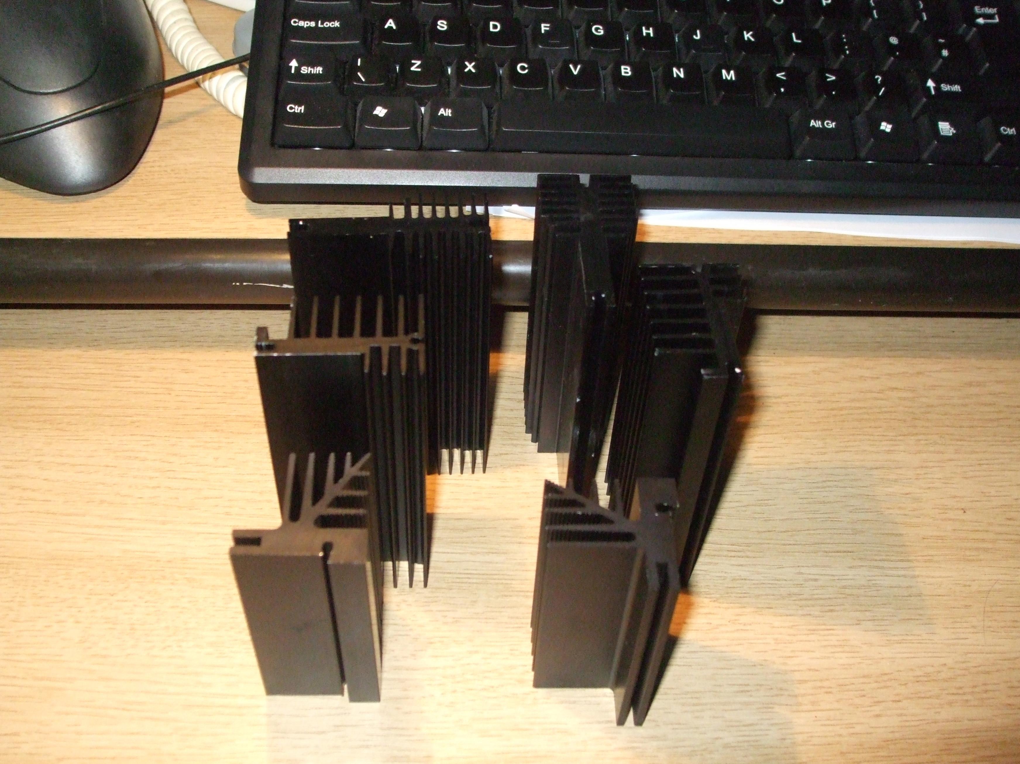

Just what I was looking for and possible improvment on the orizon
I am not saiing that a separate psu board may make an improvment also I am not saiing that a different heath sink may also help.
No not saiing this at all till I tried and psosted pictures to prove it 😀
And an old post by Sallas came to mind....
Sumtink to do with thermal coupling 😉
And then another big one burried away about using highest possible Hfe for imputs which may also improve spatiality.

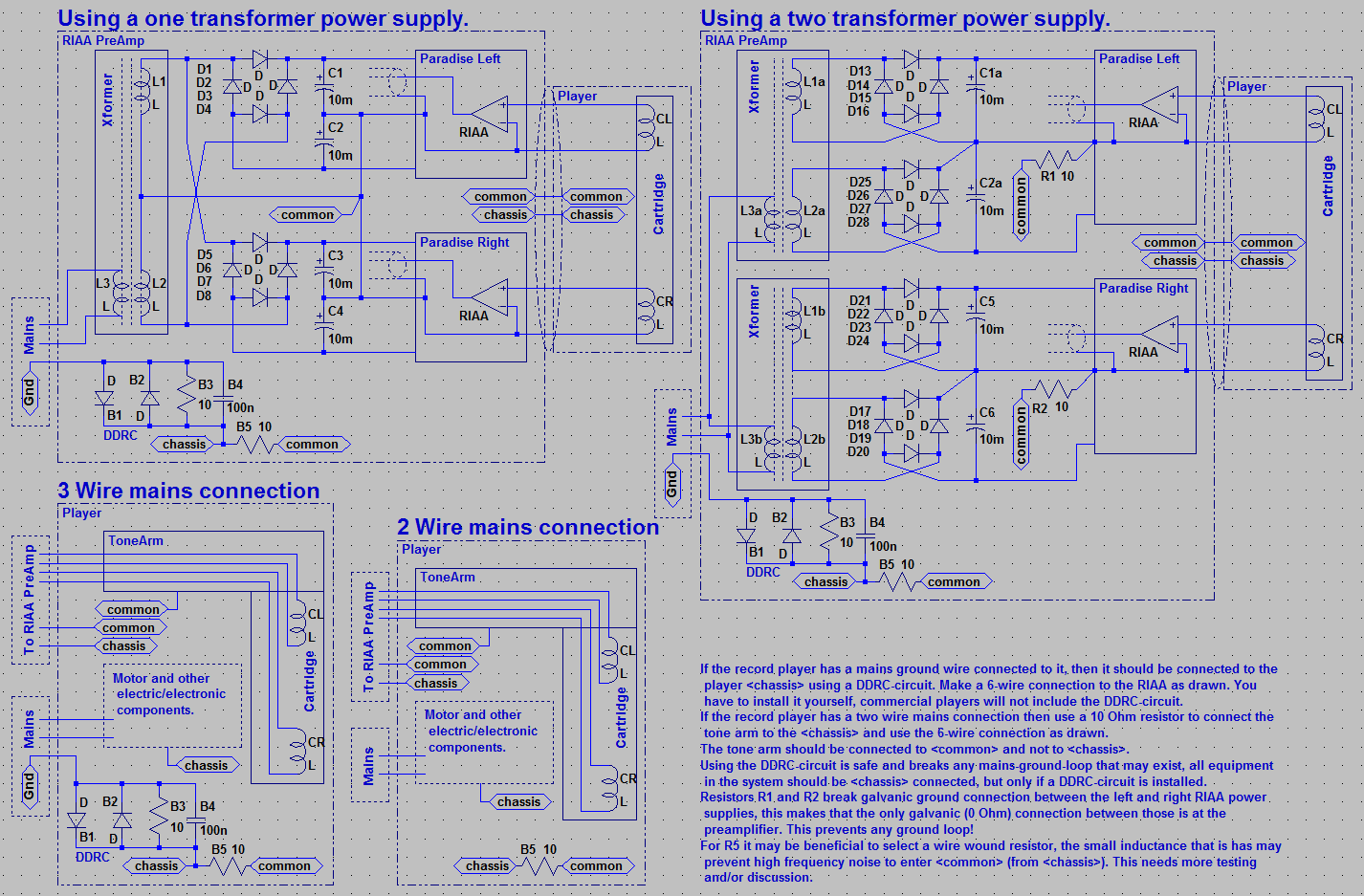

I thing the problem is the common ground of the boards in combination with grounding the input.
Chris
If you use only one TX to power both board, then both boards share a common ground... in this case you should not connect also both input grounds together otherwise you have a ground loop.
Try a "star" ground at the input connector of the phono preamp, where you take the turntable ground, and isolated metal "bath tubs" for both boards, also connected to the same star ground, that should solve it. You can use double-sided sticky tape to mechanically fix the bath tubs.
This will work if you use two independent psu´s one for each channel, and the only common connection is at the star in the input.
Also, the schema as shown makes sure that the -L and -R of the cartridge are separated (all the way) and that the player ground and signal-ground (the arm) are separated (you need one extra wire from the player to the RIAA).
After that all grounds are connected at a 'star'-point in the RIAA-box.
Maybe RCruz has a thing (or two) to add on this subject 🙂
IMO the best solution is to connect TT chassis to arm gnd to amplifier chassis and all these to earth GND using a DDCR (or DDR).
I also connect signal gnd to chassis gnd using a 10r.

Grounding
Just tested consistently grounding on one starpoint with one psu, only one connection from the boards to the startpoint.
With plugged dummys i had light hum, but with plugged DL 103
maximum hum. Pluging input ground from the starpoint to the boards, hum change into noise, same as at my first try.
I use a DIY tonarm (Schröder Clone) with a DIY cable.
The paradise works fine with two psu and thats my choise, I will test only DDRC for turntable grounding, but also with two psu.
Chris
