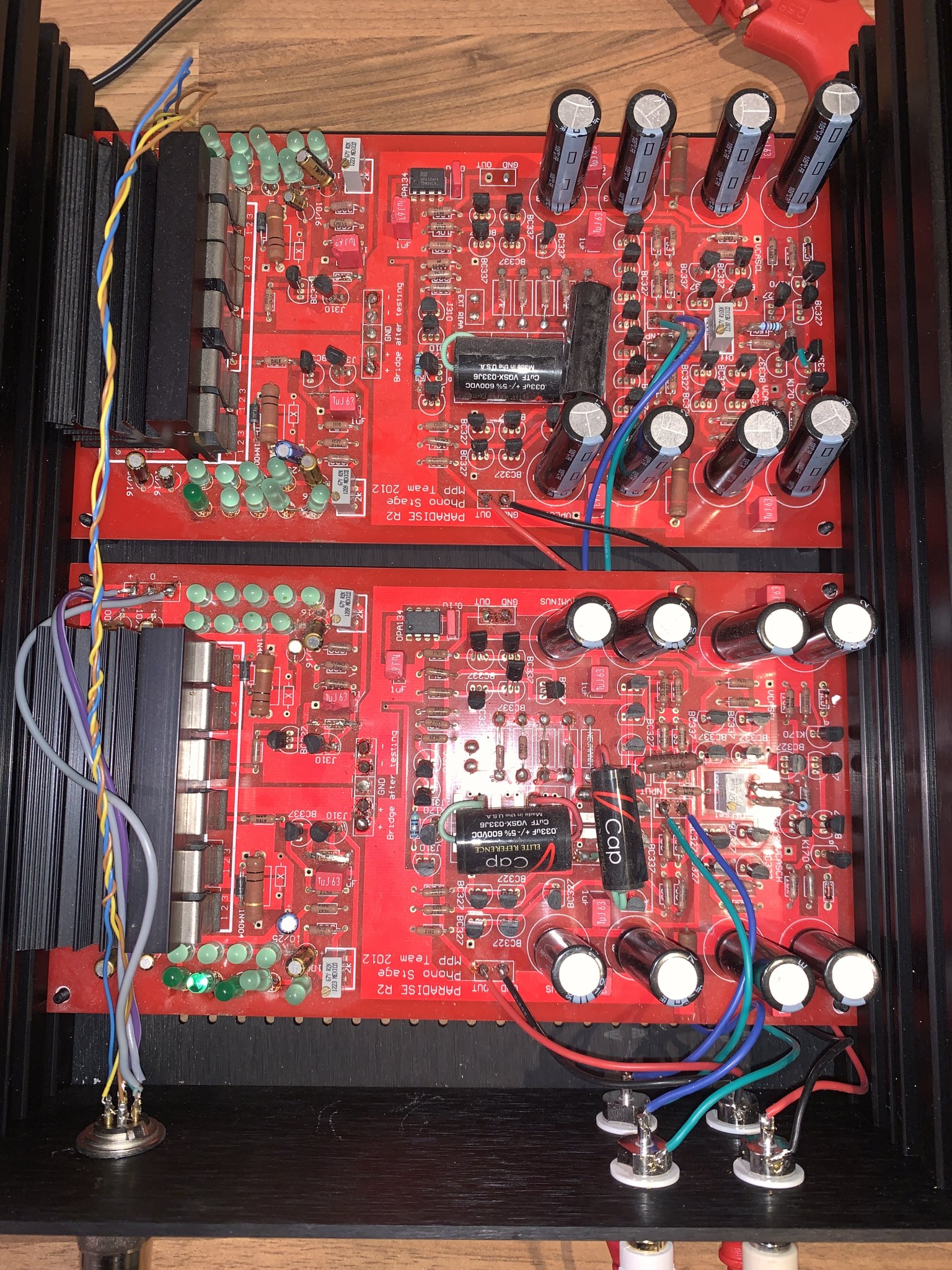

Early on (2013) i had some issues as well, documented in this thread but these were (I thought) resolved. Note for example the additional servo resistors, described here. Also I had to play around with some of the transistor values. Not sure any of this is related to what I'm seeing now though...

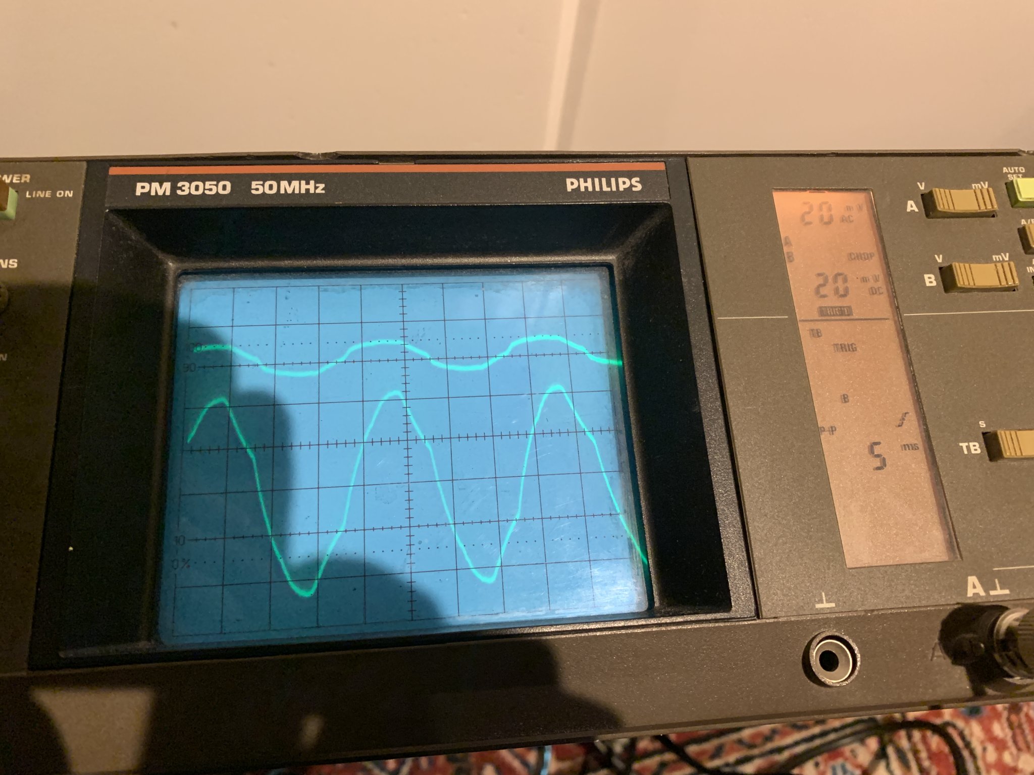

I guess you connected the outputs to the scope. Is the input terminated or connected to the signal generator ?
The supply is not shown and I see no connection of signal ground to chassis.
Check integrity of all supply voltages with DMM and try to detect in which branch the oscillation occurs or has
max. level. A scope probe can be used for this.
I also guess that you had to "play around with some of the" resistors values, not "transistor values".
We need the complete picture for additional advice.

Output connected to scope, input connected to signal generator (which was not generating a signal when I took the picture of the scope). Input and output terminal GND are connected to the respective GND terminals on the pcb. The pcb is not connected to chassis GND (I did a quick test and connected with alligator clips but it didn't improve the measurements).

Did some more digging, decided to first try to sort out grounding issues before looking for any oscillations that may (or not) remain. Redid some wiring and tried to implement some of the grounding concepts as per this thread. This seems to have improved matters audibly already but some humming remains on one channel.
Measurement shows on the B channel a 90mVpp sinusoid at more or less exactly 50hz. So clearly ground hum. On the A channel also a 50hz sinus but much lower (could be triggered by the issues on the B channel?).

This is good news. The lf oscillation is gone (if it was in fact 70 Hz as stated in post 4437 / 4439).
But it is not indicated in your scope picture : is the amp input open or shorted?
