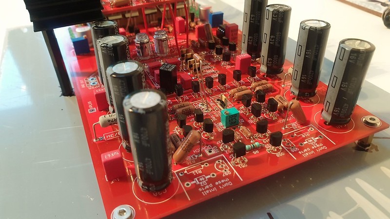

I'm confident now that the regulator is working OK.Maybe you can also provide complete voltage measurements at the test points indicated in the original schematic? That would be helpful.
Output voltage is adjustable to +/-18.1V and all the check point voltages look good. See attached (hopefully)
The chain LED's are all fine. The two that dim are on the positive side under the heat-sink and connect to the base of Q104. At this stage I can't see any connection issues and It may be just a character of the transistor?? Voltage across the two LED's is just on1.8V
I've made provision the the back of the boards for the suggested caps to control parasitic oscillation, and the transistors are a moderate 450hfe, so hopefully no problems there. I don't have the luxury of an oscilloscope, so fingers crossed.
So I think I'll press on the the amp side.
Thank you for your input, always appreciated.

voltage levels looking very good indeed. good luck with the amp section! If I remember correctly, most of the issues were with the regulator so you might be lucky 😀
The latest version R31b still has them on, where did you find that information? I do not remember, sorry .....I've also noticed that on later board there is a label to not fit the parts:
R11
D2
Q97
D1
R10
Q98
Can I safety remove these from my R2 version PCB without making an other changes to the board?
Ta
Interesting. They serve as a "weak" regulator, to keep the supplies for the cascodes centered. Maybe SQ can enlighten us?

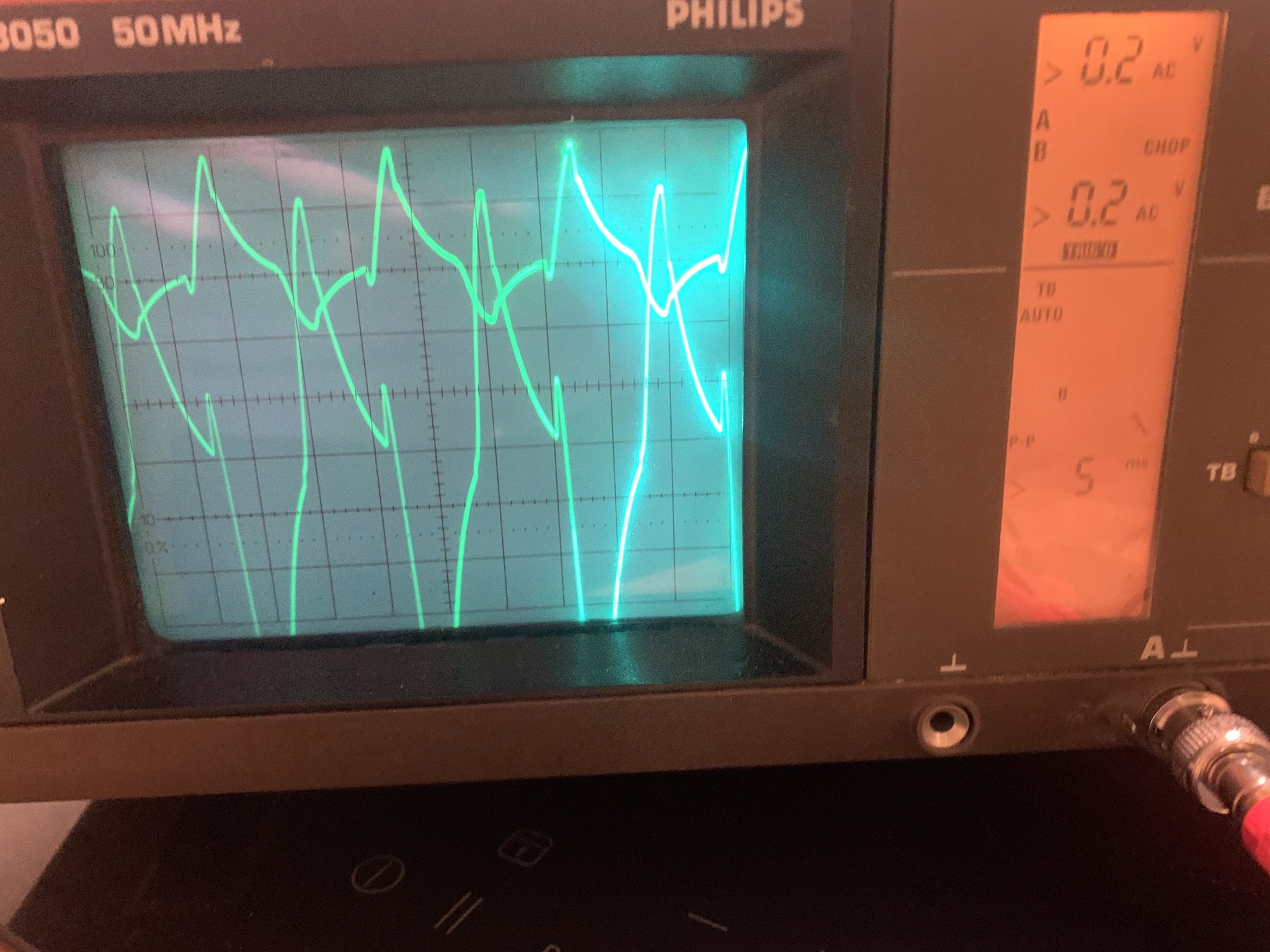

I’m getting a buzz from one of the channels, so I hooked up the unit to a scope (and waveform gen).
I’m getting the picture as attached … indeed one channel more than the other but both have this.
I don’t really know what I’m looking at here, so any pointers?
Please show us what did you build and how is it set up.
The signal in channel A is the inverted waveform of channel B but with reduced amplitude - is this
a triggering phenomenon or correct, is one channel set to invert mode (not indicated on the LCD
screen) ? However, the problem may be in channel B, it looks like motorboating, a low frequency
oscillation.
