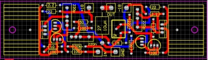

So i take it that the J310's is possible to replace with 2sk170 and J113, but the latter is recommended?
I have already bought the J113's, so i just need the 1K resistors then, but about power rating.. i take it that it will be 1mA through it, which would make it (power wise) pretty much any resistor would be enough for it.

Yes see also Paradise Builders #1772 (the attached picture). When using 2sk170 (replacing the PSU J310's) then Rbe should be 360 ohm (330 is o.k. ). The Rgs is to be selected for a Ids of 1mA (as you noted ).
Great, then i got it right.. i don't know from where i got it - but i though there was some other jfets (besides the 310's) that you was supposed to replace with 2sk170s.. but it was the same fets all the time.
