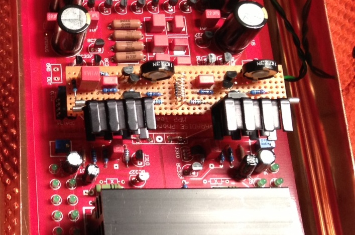

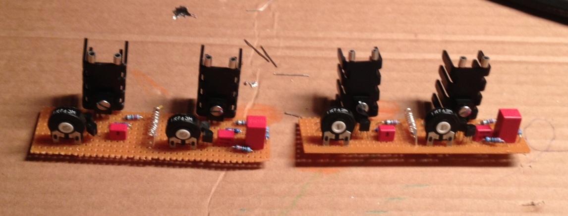

Hi Joachim and all,
just put the buffer in and did some hearing. I must say it is very nice! Comparing to the regular Paradise output buffer, the bass is very well structured, there is more texture there, and the transparency is amazing. I had a feeling that everything is slightly more forward, more "visible", and the spatial resolution as well as the timing is a nice improvement. The highs are more there, more in your face, but not aggressively so. It is just clearer. The best part I think are the microdetails, lots of them and just right.
The regular buffer is not bad, dont get me wrong, but the calvin buffer makes it much more believable and clearer. Maybe it was the longish cables and low input impedance of my line stage, that the regular buffer just couldnt cope with so well....

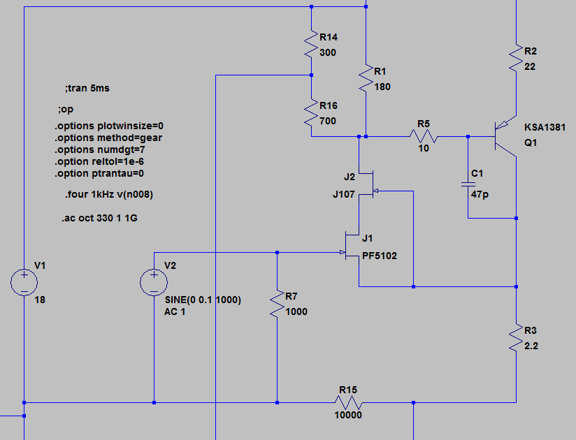

Please see the pictures on how I implemented. I just did little PCBs as "backpacks" to the regular PCB, where I removed Q99 and Q91 (so the way back is not too painful 😀)
I also changed a few components, see schematic. Here I used the PF5102 cascoded with J109, and the 2SA1381 as output PNP. The simulation showed -3dB at 32MHz or so, and 0.000006% THD - whatever.... it sounds mighty fine....

Here is the full schematic of my implementation. Please note I have replaced R14/R16 and R17/R19 with a 1kOhm trimpot each, but I just set them to the value the simulation indicated. In the Paradise, the buffer is inside the servo loop, so adjusting the offset would have to be done outside. The output zobel is not shown here but implemented just as in Calvin's schematic.
I will look into a little PCB for this....
Sorry I left those in. Yes, R7 is just an input resistor and has no function in the circuit. Its parallel to a voltage source so it does not affect simulation. R15 is the output resistor I used in the simulation, just to have some load on the output. The output is just below R3.
thanks for the review.
I think that this buffer gets very likely approved for Masterpiece too.
