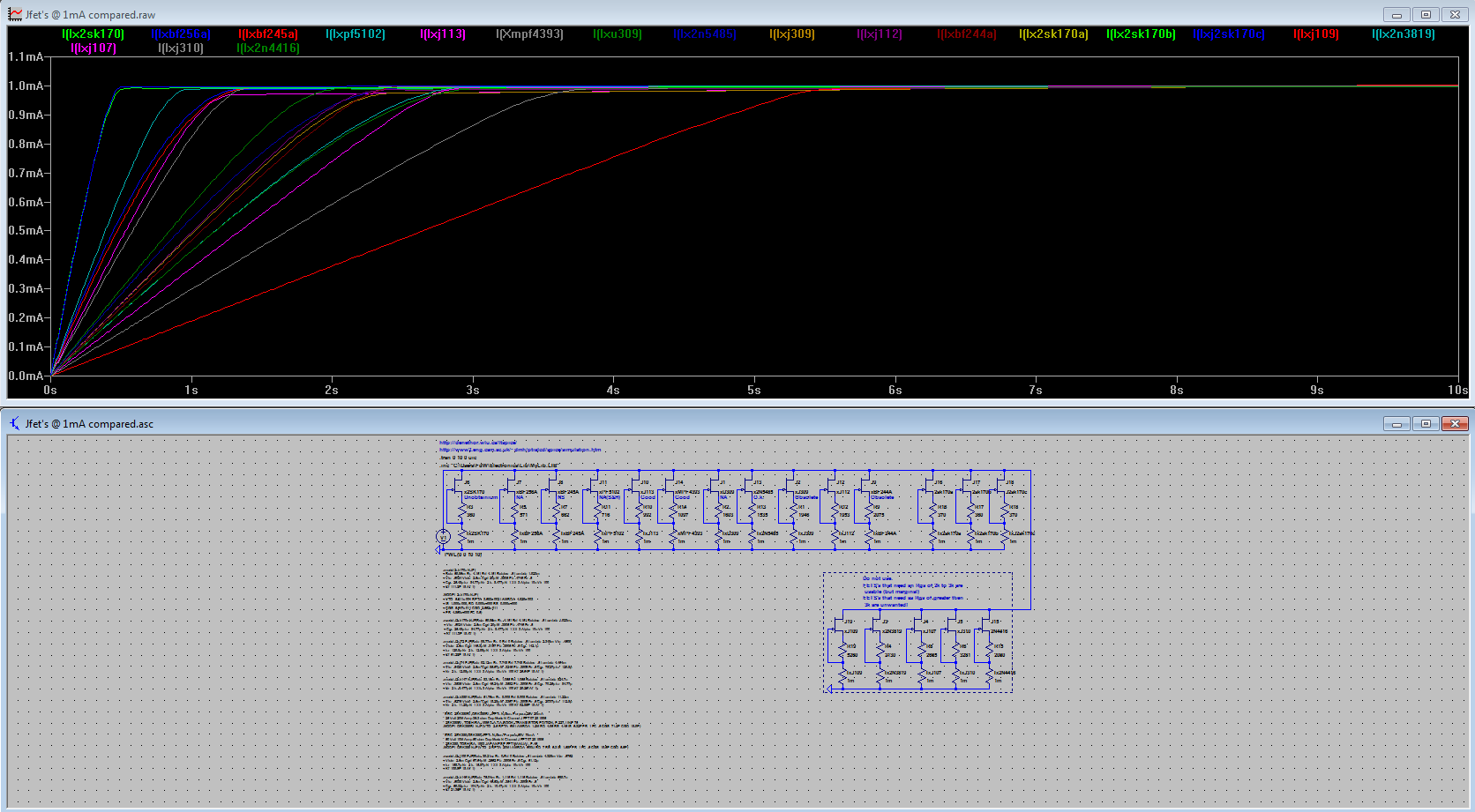

Not possible, the J109 needs an Rgs of more then 5K for 1mA, thus dropping more than 5Volts (no more than 2Volts (or less) is best).

IMO the best choice is the J113 (using a 1K Rgs resistor). But all resistors needing a 2K or less Rgs are good. The J109 is currently the worst one simulated 🙂

And, trying to un-confuse this a bit more, to be more clear. The 'impossible' means that it is impossible to have a 1mA current source (in this application) using the J109 and the 1mA was the design parameter for this current source.
On the other hand, the power supply will happily function using the J109 and 3k3, but; the supplied current will be between 600 and 750mA (not the design goal) and it will not be a CCS (not the design goal). Especially the last (it not being a CCS) hurts the performance of the PSU (but slightly).
