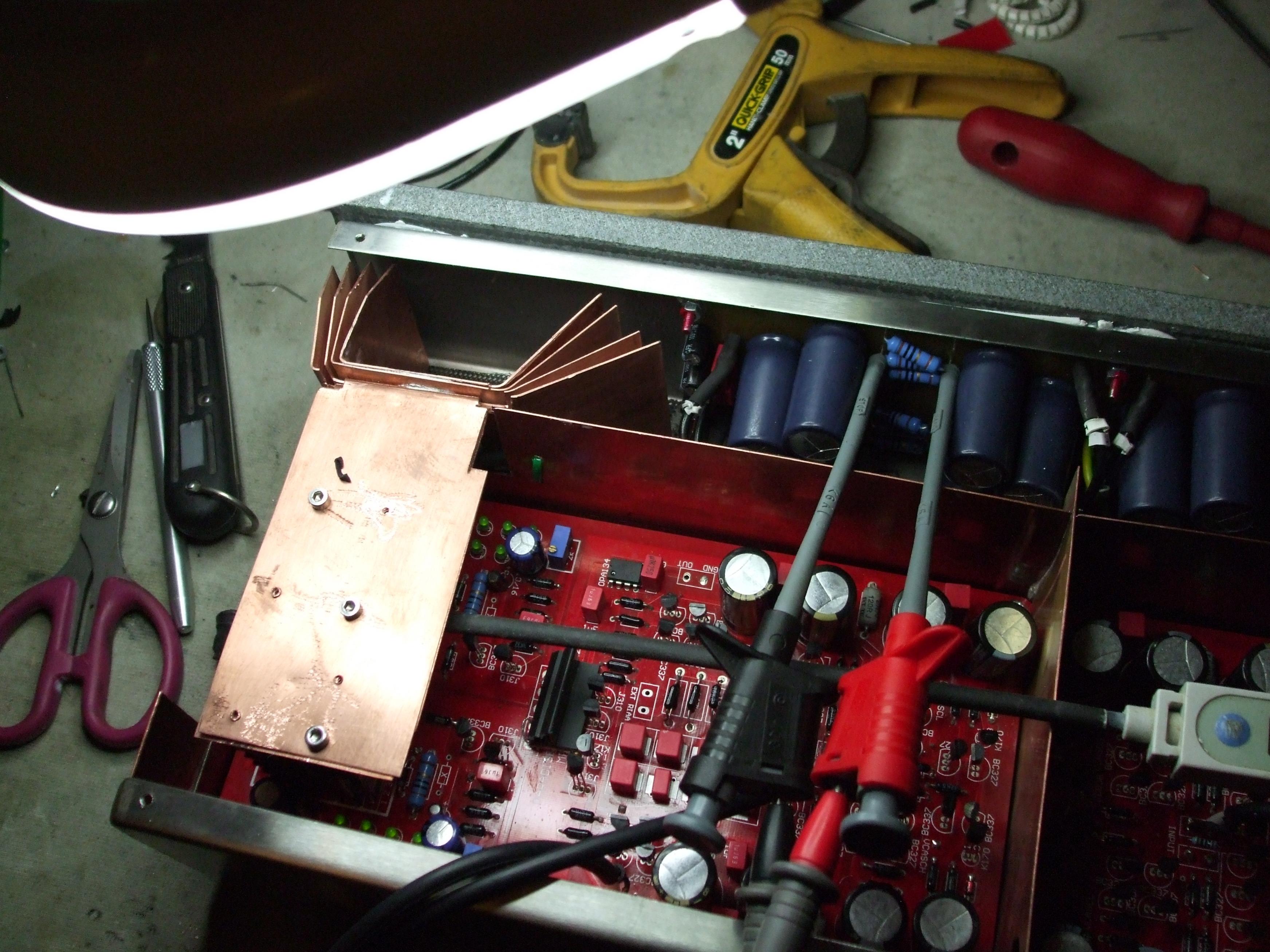

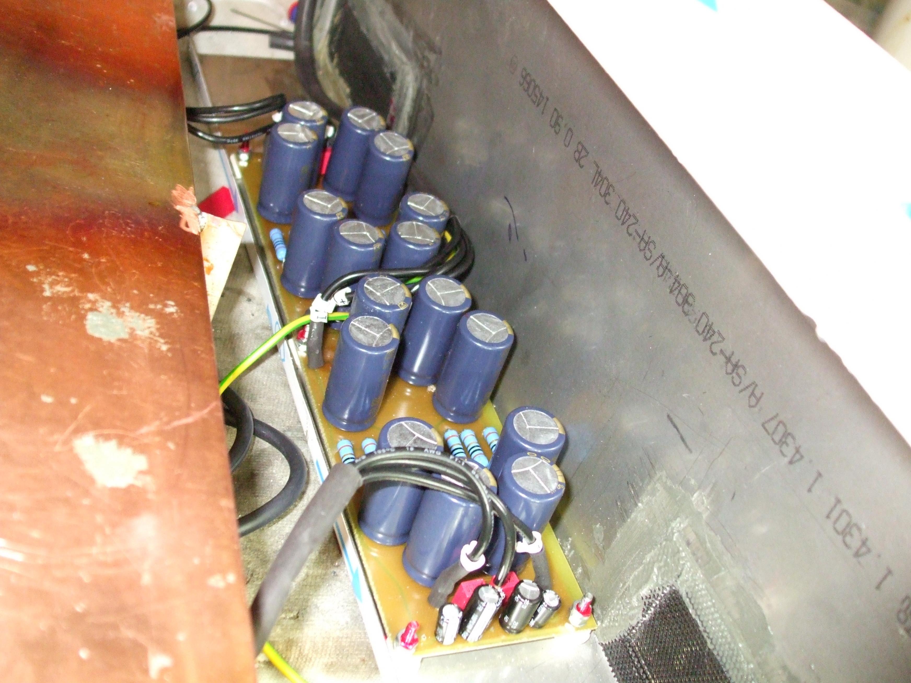

I got some 40ohm 12 watt wirewound ceramic resistors to lower voltage.
The 40R resistor lowered the voltage from 36v to 26v, so i am right where i need to be. But i can only touch them for a split second cause they are hot.
Are these made to handle this wattage and heat??
Also I have a 330r resistor on the input with a 30ohm cart, started with a 100r resistor but it seemed a tad bright and noisy as it was a cheap resistor.
Right now it seems a bit bass heavy, would i lower the input to 220r??
Not sure if going higher value on the input increases bass or lowers it.
Thanks...
If you got enough to spare.
Extra RC
2 X 40 Hom's in parallel capacitor 2 X 40 Hom's in parallel
still get the magic 26 V and get rid of same ripple.
20 Hom's 24 W should give you 1/4 of the heat.
Cheaper than proper new trafos with correct voltages and you could fit the last RC near the Phono Stages.

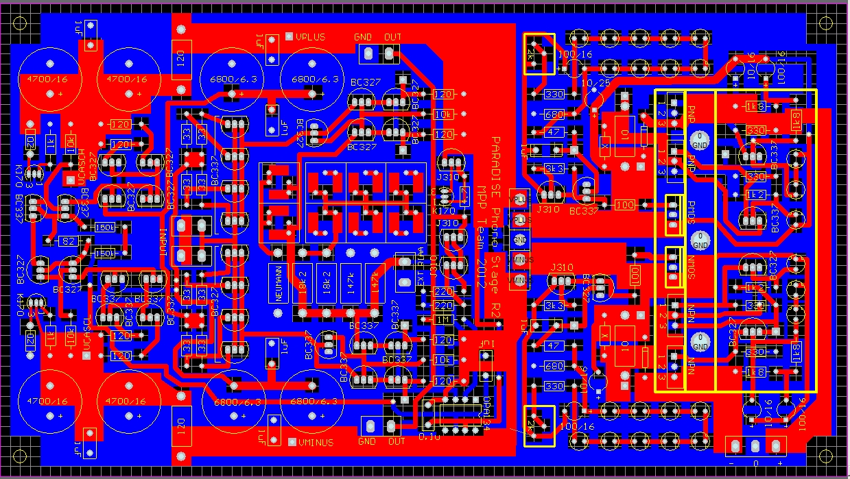

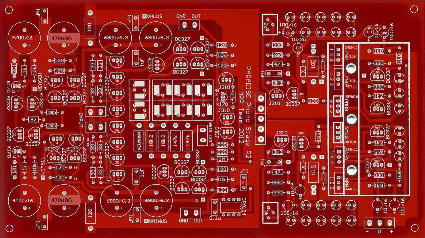

Hi guys. Just getting started with my build. Sorted the transistors and started soldering. This is my first pcb build, have built everything in my rig point to point and tube. I have a really nice tube phono stage now and use peerles/altec 4722 suts. Am putting a second tt into the mix and was going to build another tube phono but thought, hey, try something new and so here I am. I have baseline barely worthy of your attention queries. I am good with copying builds from pictures. Following pcb traces and determining the relationship to the schematic is not really a strength of mine. In the build guide there are circled groupings of the transistors to keep matched as a grouping from the schematic. Any chance I could see these groups transposed to the pcb image? I feel like I am getting good solder joints so the first hurdle is crossed, as well as getting the leds properly indexed... Thanks in advance for your time and attention. Is there also any chance that someone from the group buy has a nice finished pick to assist me in loading the board?
Kind regards, Bill
Here is what I have at present
RCruz did same real nice ones with numbered components wish I could find them...
Those are R2 boards and have very small differences from R3 (off set pot and couple of foot prints)
Transistors grouping is quite evident from lay out and is also on Guide

Here it is.
Each transistor has the same number as in the schematic.

I am trying to move forward without a pc. It went up in smoke a few weeks ago and I have been trying to get by on my phone for now. Needed the extra $$$for the ps group buy! First things first. So, I printed out the build guide at a friend's but it doesn't have sufficient resolution on the picture with the circled transistor groupings to discern what is what.
The side of the board with the leds and heatsinks is the output side? The group of eight input transistors is on the side opposite the leds in the center? This is where I need the high value transistors? Eight similar pieces of each from my batch of transistors will be in the 440range.
