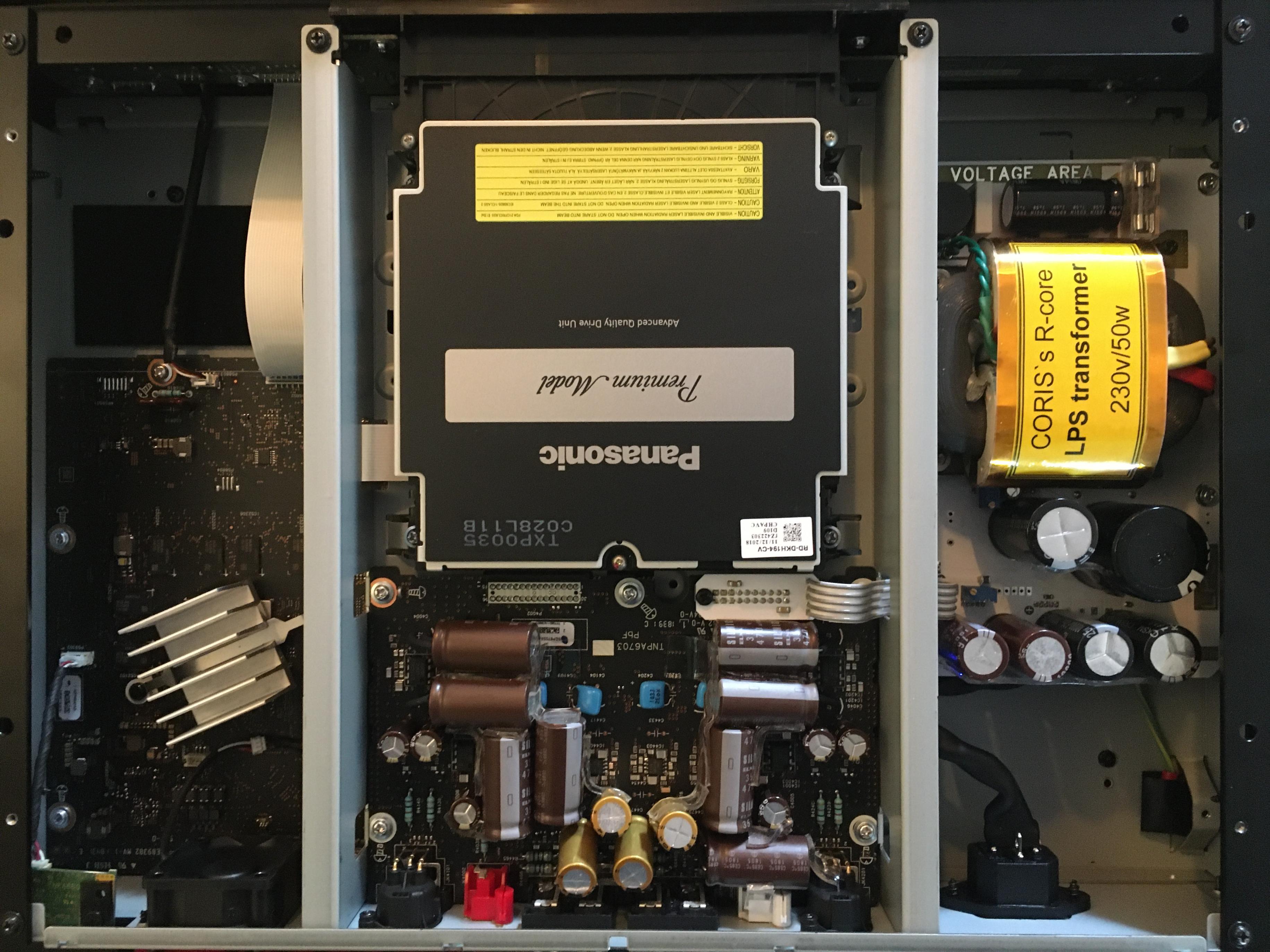

After a conversation with Coris, I tried rewiring the mains cable to earth the LPS board. Seems Panasonic don't earth the board to the plug. I have experimented with the earthing before. So I thought I'd give it a go and have the chance to recheck how the LPS compares to the old SMPS.
SMPS vs not main cable earthed LPS
Some quite noticeable differences, whilst the overall sound was very similar in many ways there were some areas of distinct difference in my system
Bass, the SMPS was full but not as weighty, dynamic and solid as the LPS, it sounded softer and less resolving.
There was. greater sense of 'blackness' with the LPS and it sounded easier to listen into the recording, a little more being there than watching. the dynamics were also better with the LPS. Overall resolution was reduced a little with the SMPS and it just lacked the immediacy, dynamic tension of the LPS. Musically the LPS was better as it seems to have a 'flow' that was more analogue and less digital.
I didn't re do the picture comparison because it was really the audio I wanted to compare. But watching the film with the SMPS I was aware it wasn't as good as I expected which could easily be the film, I'll retry tonight and report back.
The initial impression I had of the LPS sounding a little 'glassy' and a hint 'hardness', the only possible negative has all gone. I suspect that the LPS running in (I know Coris will disagree !)
SMPS vs LPS earthed at the board
I run separate manis lines form the main board for each digital item in my system - projector, Bluray player, processor and Lumagen. Which might have an impact and I run Naim amps which I know are sensitive to earthing choices.
In my system running the unit this way has brought clear improvements the gap between the old SMPS and the LPs has increased, particularly with dynamics and bass separating and weight. It sounds a little more 'real' and has a little more 'body' all very good improvements
Playing the same piano piece I am less aware of the slight lack of lower mid weight, I am not sure I would have noticed in this configuration.
I'll report back following playing some of the film I watched last night regarding the picture comparison
Overall very happy (although I still with Panasonic had built the analogue out with seperate DACS and not one multichannel DAC)

Well, grounding the UP9000 chassis to outlet ground it can be fortunate in your particularly system. The UB9000 it is however grounded, through the cables connected on its outputs, to the further devices in the system (amp, AV receiver, etc.). If the other devices in the system may not be well grounded, or it may have a particularly such connection, then it could be a clue to ground the player chassis.
However, it should be also mentioned another aspect in this regard. With its original SMPS, the UB9000 it have the chassis always tied either to the neutral or to the hot line of the AC outlet power, through a special capacitor (inside its original SMPS). Therefore in such case it is important how the IEC is wired to outlet. If the outlet it not have a neutral, then it start to become problematic a such grounding approach in the existing consumer SMPSes...
When using an LPS this stupidity does not exist. There is no whatsoever connection in between the AC network and the chassis (because the LPS transformer it fully isolate one from another). The device grounding it is in LPS case, very well done by the connection cables, in only one point, through the terminal device (in the system) ground connection. If connecting the chassis to ground (outlet ground), when using an LPS, it may be created an ground loup. A such loup may not affect anything in some cases, but it could have negative impact in other cases, function on how the groundings of the other devices in the system are made. Well, all these things it can be quite complicated in some cases, as well.
The best as principle is not grounding (to outlet ground) the chassis of UB9000, especially when using an LPS. In some cases a such grounding may not bring any whatsoever improvement, or it may have a positive impact in other cases.
So, if it works fine in a certain system, then is all right. But as a rule, this it may not apply in general, in all cases.

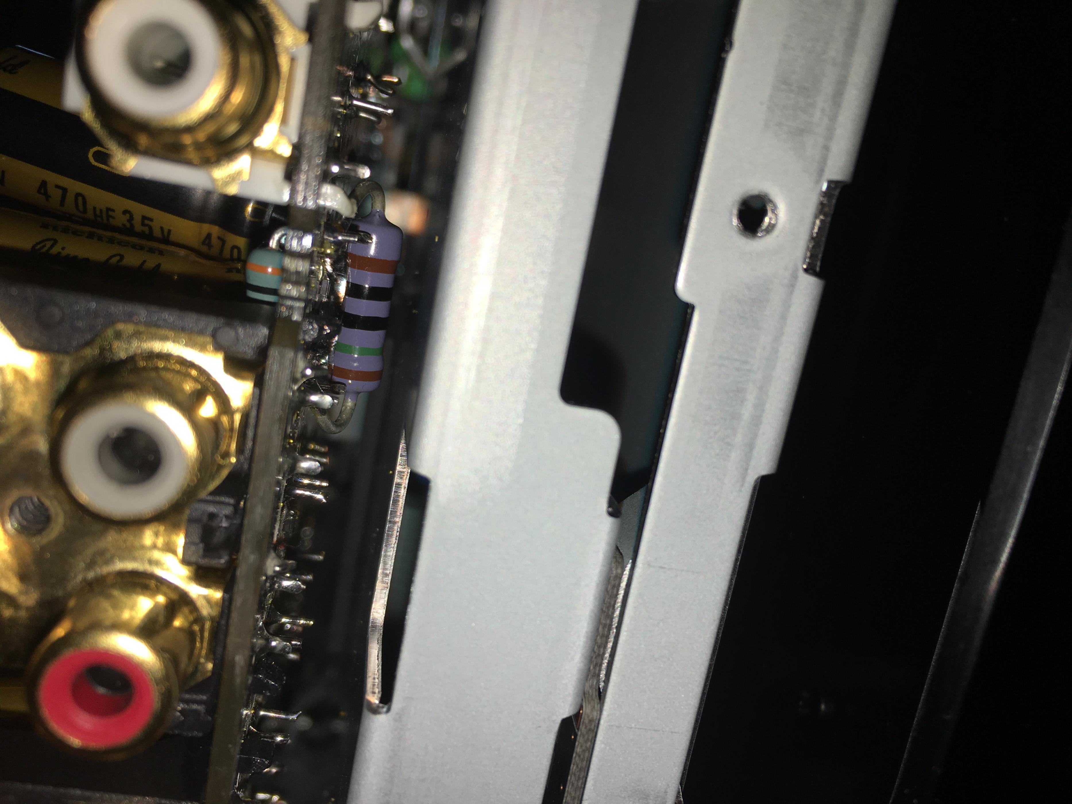

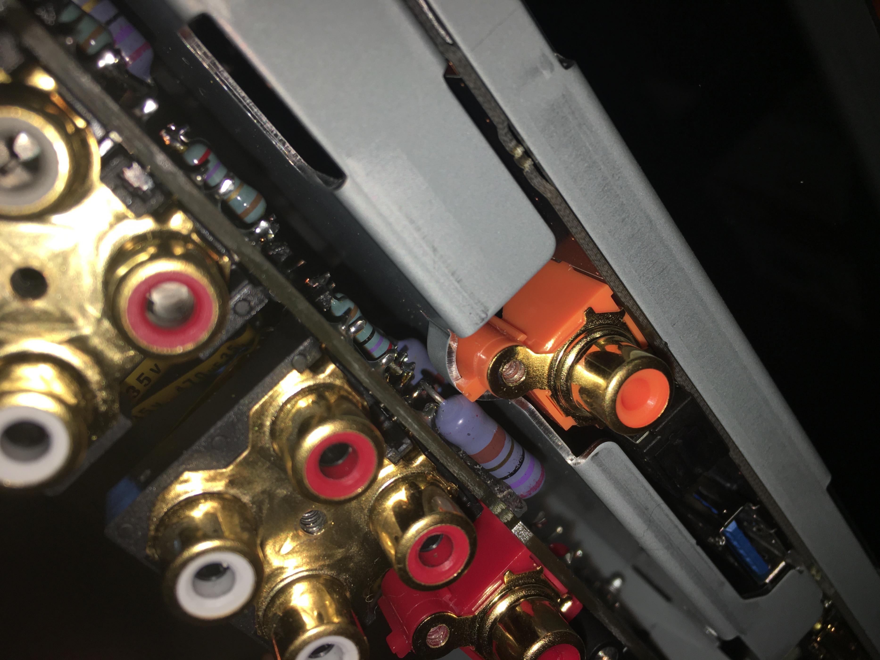

After some time listening to the Takman Rey, I am very impressed the only area I would say they might benefit from is a little more lower mid projection to add weight to voices. These resistors are in series, the signal is going through, so I guess quite critical to the sound. I'm not expecting or wanting a resistor to add anything but to take away fractionally less
I have now fitted some Shinkoh's in combination with the Rey's
A bit more tricky to add Shinkoh's the leads are too broad to fit on the 1W versions, so I have experimented with the centre channel using 300 Ohm Takman Rey and 150 Ohm Shinkoh in combination. If I dont prefer this I will go back to the Rey I took out, if I do I will add to the foot left, right, not a lot of room !
It would be very easy to provide a more accurate assessment of combining the Shinkoh with the Takman in place of just the Takman, however after running in and then simply playing 3-4 test tracks for the first time since altering I hope is accurate enough.

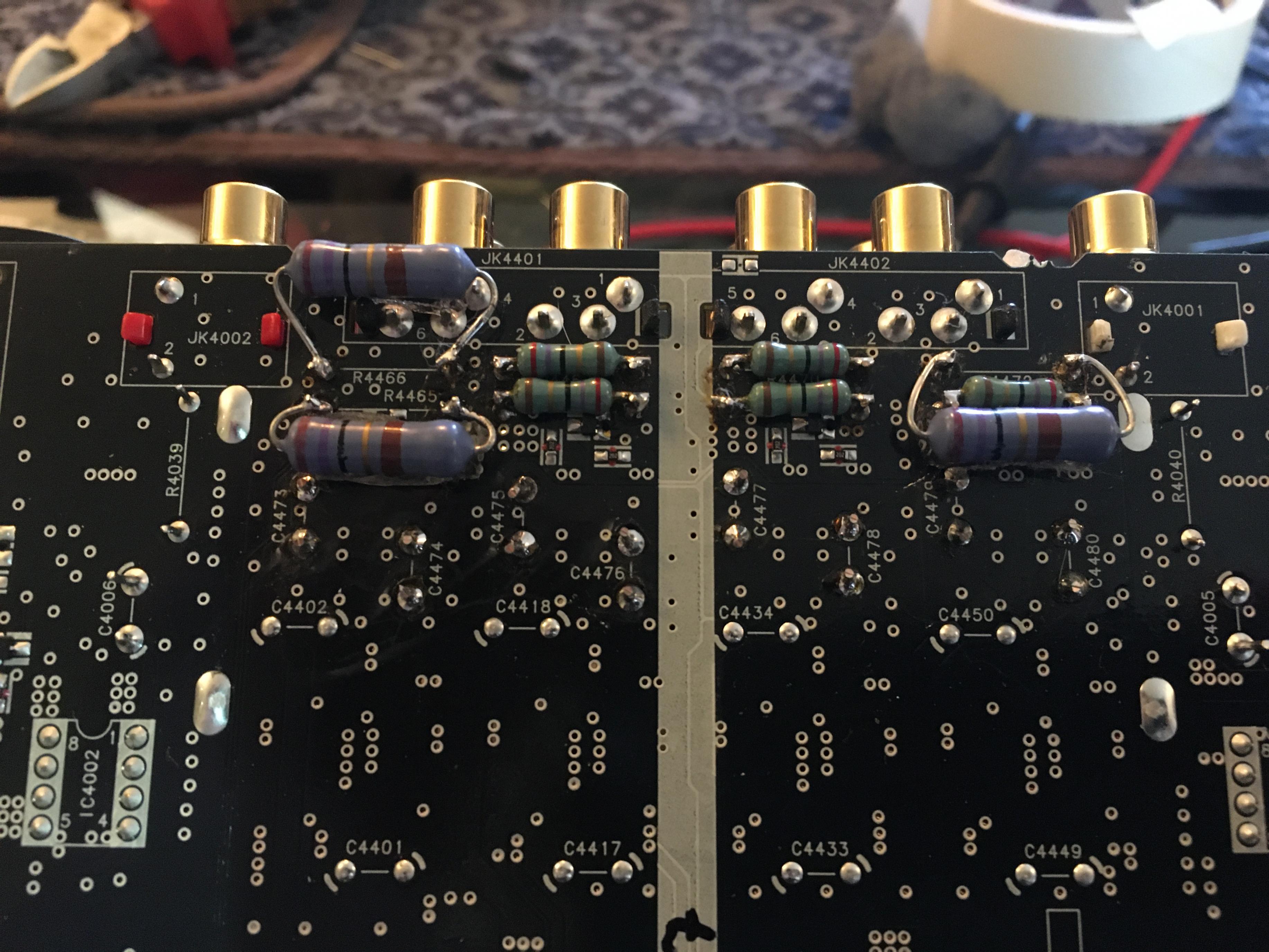

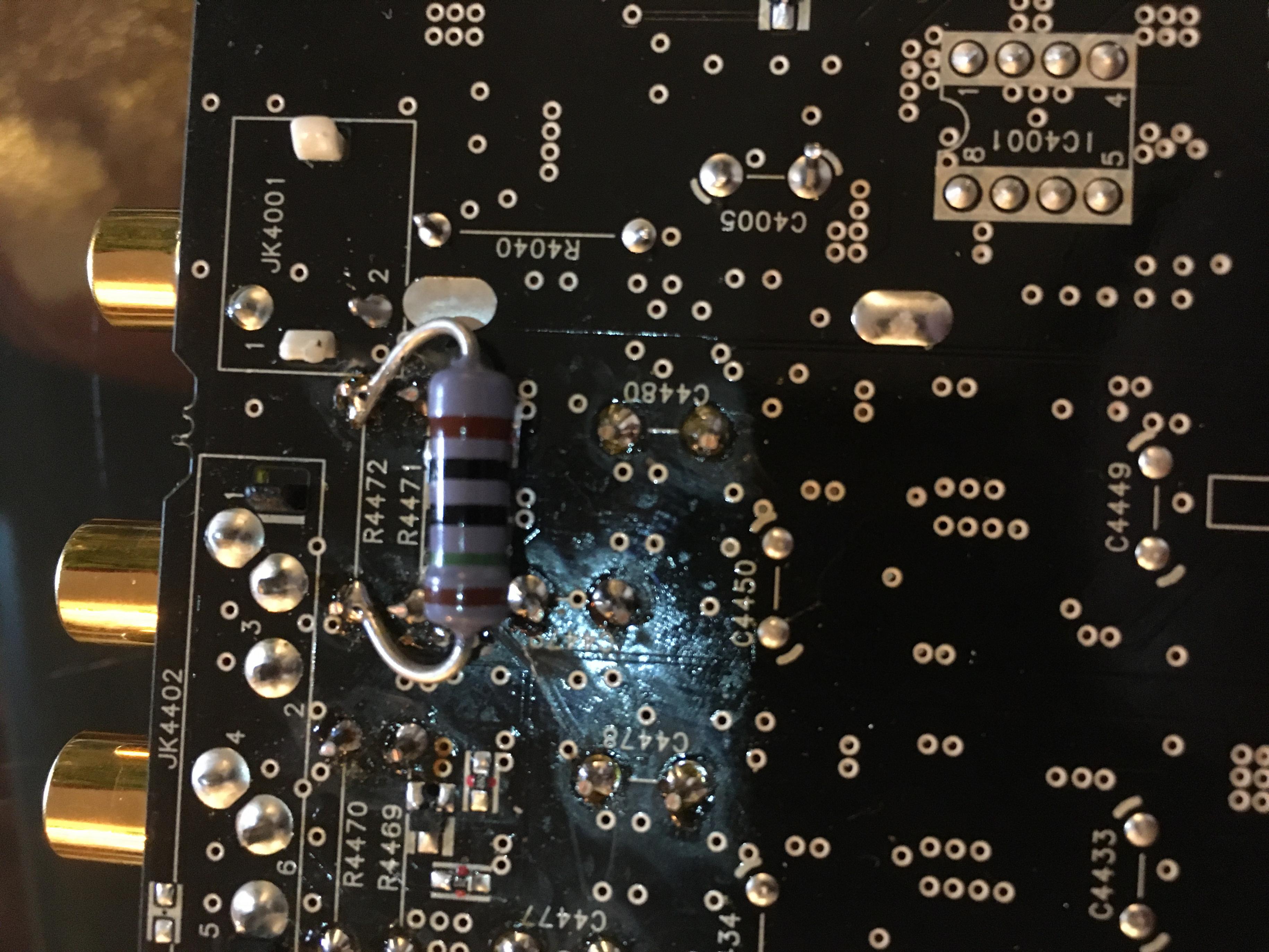

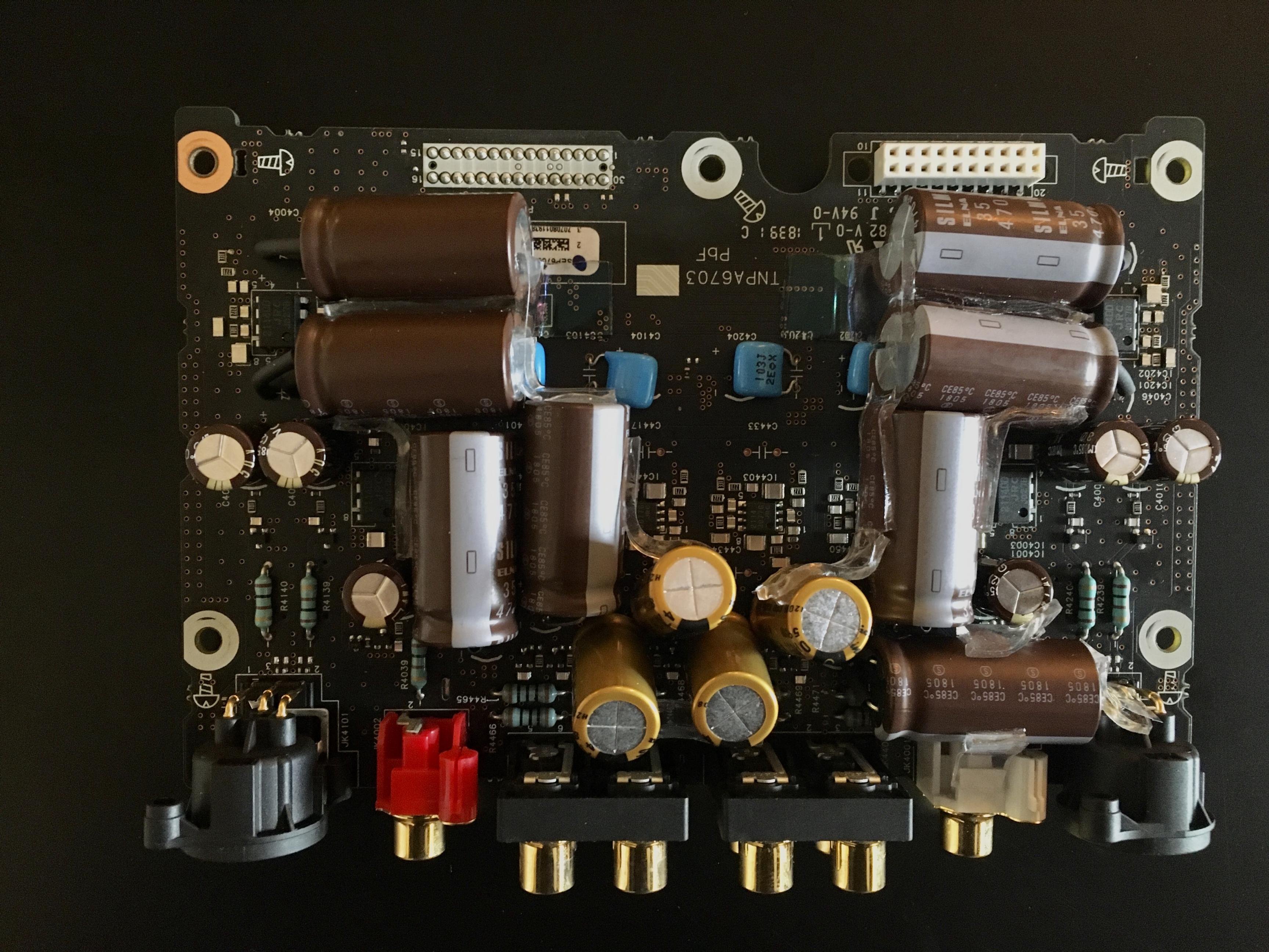

The final resistor swap ?
After speaking with Coris I appreciated that the 100 Ohm is not necessarily ideal in my situation (my naim AV2 has pretty high input impedence 47K Ohms) most of the same period Naim CD player and DVD players had 10 Ohm output impedence, so it made sense to reduce the resistance. I dropped to low 20's, so hopefully that will be okay (shortage of shinkoh resistors at higher levels, I was aiming at 30 but couldn't match that easily) I kept the TAKMAN REY 100's in place and added to the back of the board, using shinkohs for L,R,C it would have been super tricky to add the large 1W shinkohs for all 8 channels and they are £12.00 each ! So I didn't want £60 on the shelf if I couldn't squeeze them in
Initial impressions very good indeed, seems weightier and more dynamic and slightly more organic and natural. I'll wait a week to get my test discs out and do a critical listen
I'm not changing these again - hopefully

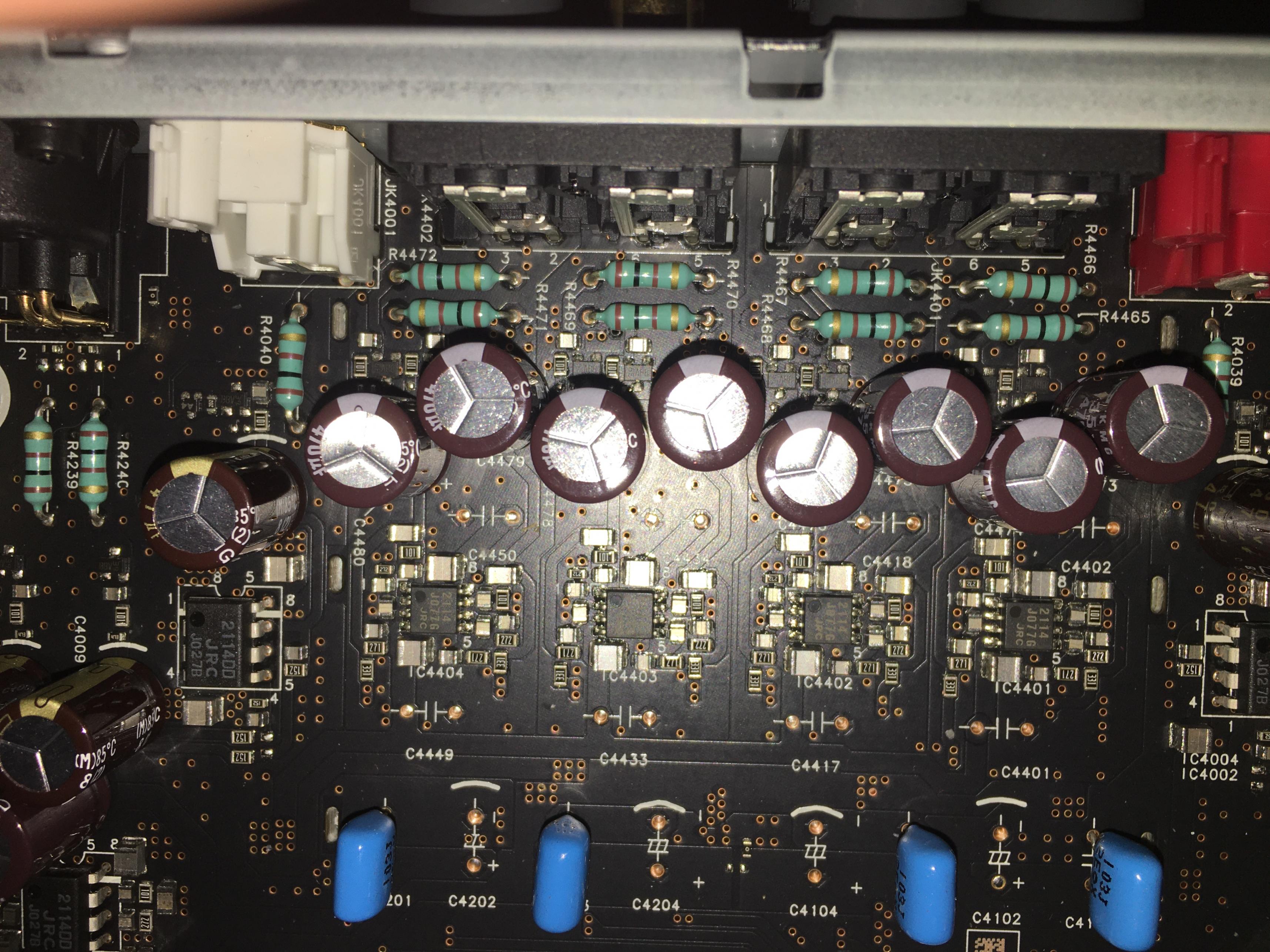

An update own the Shinkoh's
After dropping the impedance to 21 Ohms and fitting Shinkoh's in combination with the Takmans I am very pleased to say it has taken things a little further. The dynamics and sense of scale has improved marginally and the tonal density and body/weight has improved the voices in particular are now very good indeed. The sound seems more realistic and very natural, the resolution and detail is also excellent without being forward or exaggerated.
I'd liken the Shinkoh combination to a feeling of just less restriction and a more natural tone to everything coming through. Zero hardness or glare yet plenty of projection and dynamics.
I can see why people rate the Shinkoh's very highly, they somehow make the other resistors seem a little restricted and tonally limited

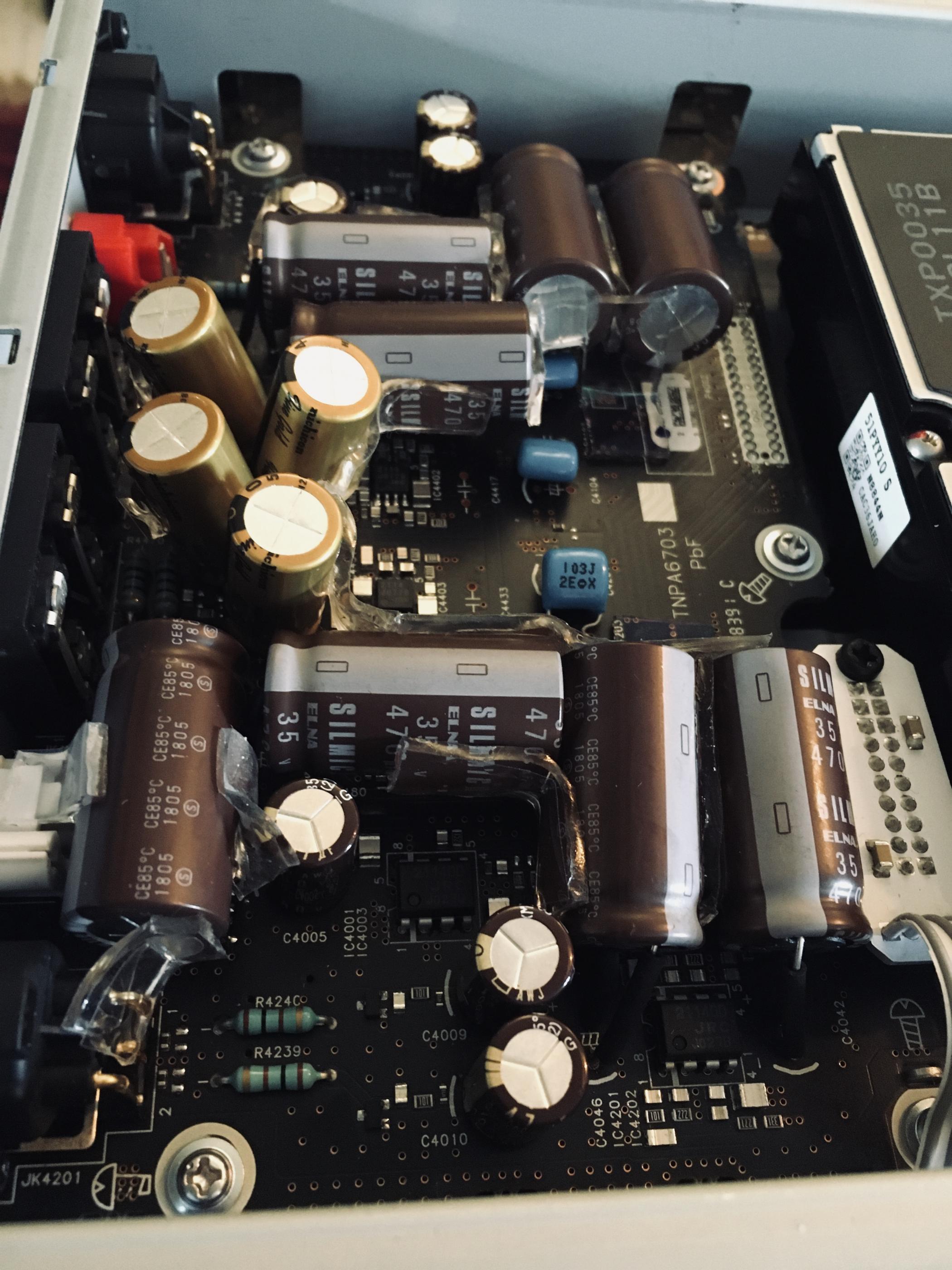

After finalising the resistor choice I am now experimenting a little with the AC coupling caps, I have swapped out the Nichicon fine golds for Silmic II's on the L,R,C and Sub channel for the multichannel coupling caps - 470uf 35V. it would be very difficult if not impossible to do this for all channels but interesting to compare Nichicon Fine Golds to Silmcs in this position
I have also added some self adhesive mounting tape to dampen them and hold secure
I'll put a few hours on them and report back
Really pleased with the results after 80 or so hours, I know there has been a lot written about burn in and these caps are suppose to need 80-100 hours my notes after the first switch on, then at 50 hours and now with 80
First on they sounded very good, slightly more dynamic more body and weight and substance, particularly in the lower mids, good clarity but perhaps not as resolving as the Fine Golds, slightly less physical scale good tonality and quite organic and real sounding. The first films sounded good and very analogue but somehow a little dark and possibly a little rolled off in the higher registers.
Then a familiar test disc at 40-50 hours, they were stronger in the bass possibly a little bloated and softer and also a little muffles and dull, a few parts of the upper mids, on piano and some vocals sounded dull and recessed.Tonally nice and pretty good overall but lacking the resolution. I like the tonality but they lacked the space and projection from the lower mids up. Also they did sound a little bloated in the bass, I took 1 db out as it was a little too heavy. At this point I wanted some of what they had bought to the sounds - complete lack of glare very good tonality and realism to things, but desperately wanted the missing resolution and projection in the higher frequencies. If they had stayed this way the Fine Golds were the winner and would be going back in
Afte 80 hours they took on a step change, all of the upper mid and high end is back, they are not forward but sound every bit as resolving as the fine Golds but with more body and tonal density everywhere, slightly more dynamics and weight in the bass and a great sense if ease and clarity. Now I would say the Fine Golds sound slightly more 'polite' and reserved than the Silmics and also slightly leaner and thinner in the upper mid. vocals now have superb projection, body and clarity, very in the room and real texture to things
I have to say this is the best sounds I have had at home in the cinema set up a notable step forward from the Acurus ACT4 now, from memory everywhere not just in the tonality and musical flow.
These are not expensive caps, physically large, shame more manufacturers don't spec them

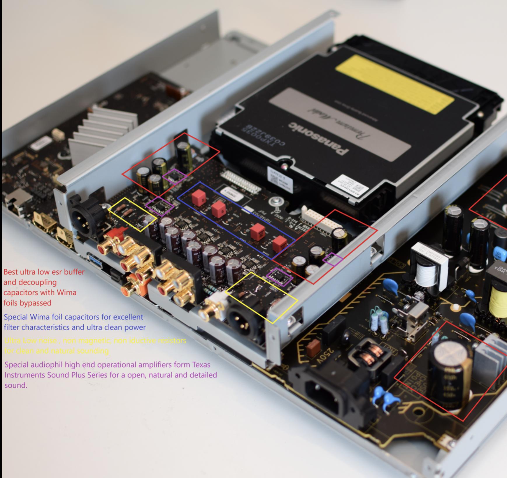

I would like repopulating the caps which are missing on board (beside the blue caps or the Wima ones in this picture - central area). It was designed to be there, but Panasonic wanted to reduce the production costs... Some 1000µ - 2000µ/16v will be good...
By the way, the original blue it are very good film caps, and is not necessary replacing it with other ones.
Yes, is that I was meaning about, but it seems to me, it may not be very much place available on your modified board... I cannot see very well in your picture, but if you have already used 4700µ on opamps +/- power rails, it may not be necessary adding another caps where are missing. If you used 470µ, then it may be necessary. 16v rated caps are just fine for these positions. As the caps have higher voltage rating, their physical dimensions become larger as well...
