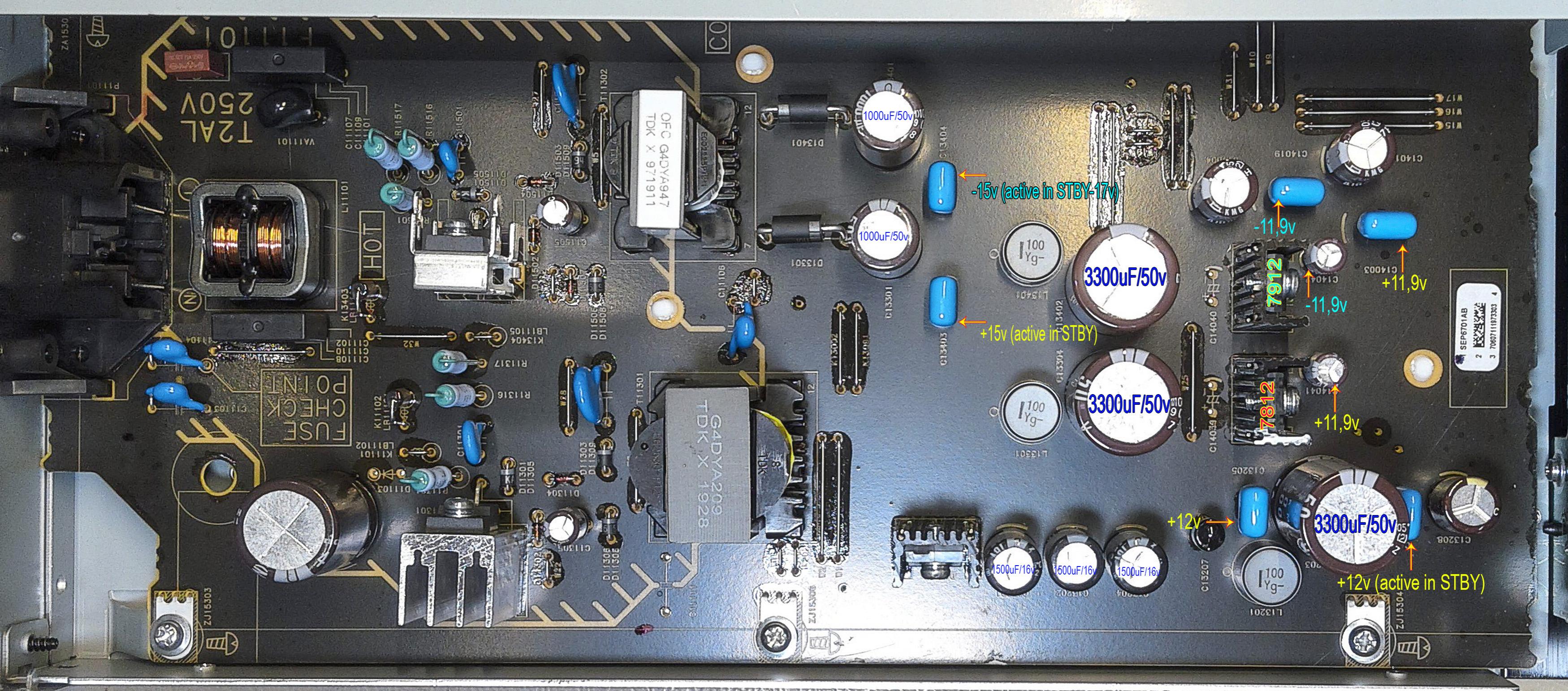

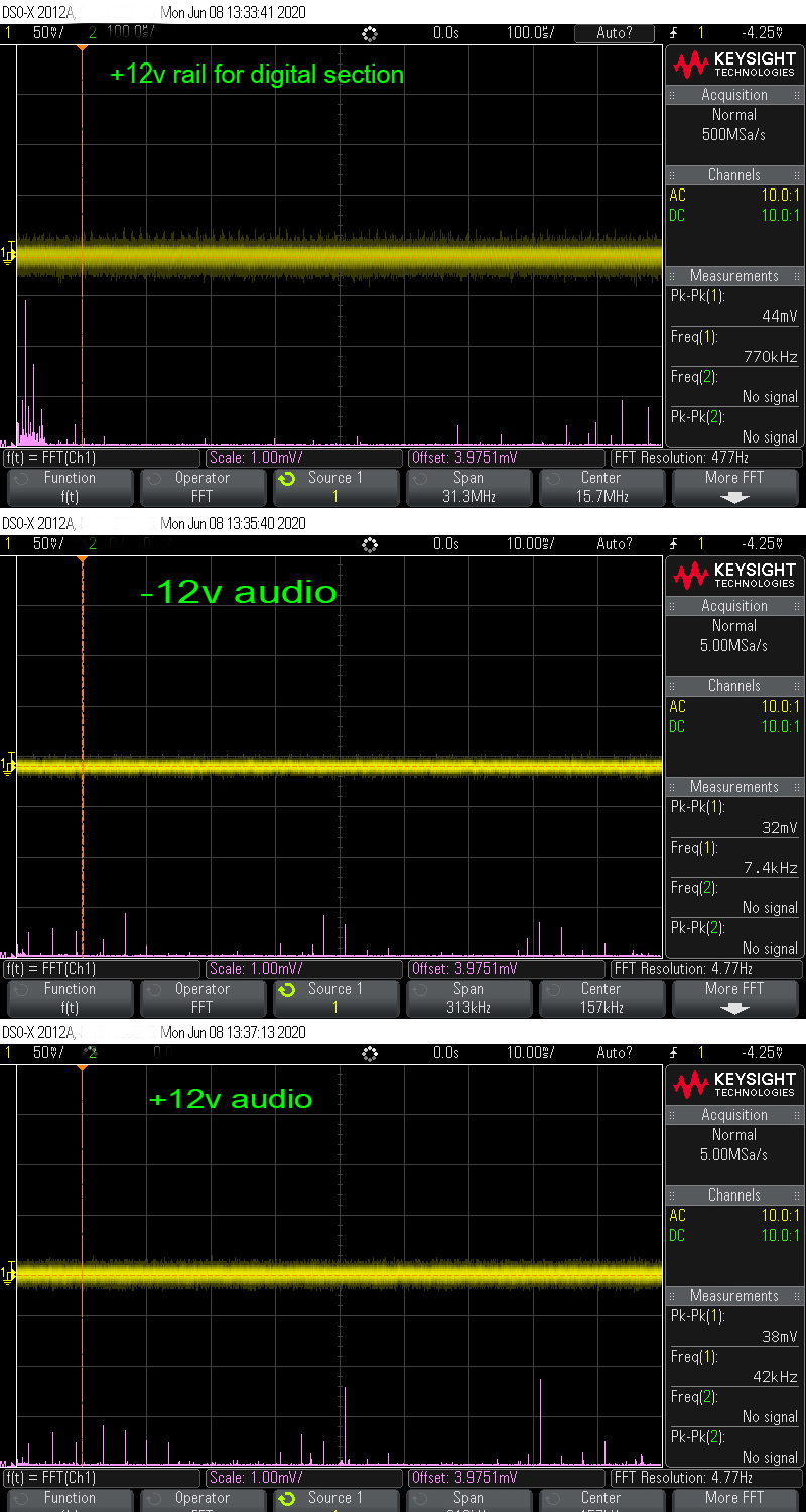

Some words (and measurements) about UB9k SMPS....
The power supply is divided in two sections: one which it power the main (digital) board, and the second section, which it power the analogue audio stage of the player. The power rail (12v) for the main board is always on. The analogue power rail (+/-12v) it is switched on at device start up. This section it power both the DAC chips as the post DAC circuits.
The SMPS it work at 170kHz and the filtering is quite good, as shown in my first post. However, my design for the linear PSU of this device is finished now...

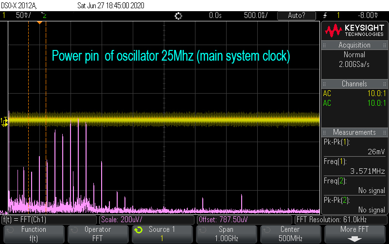

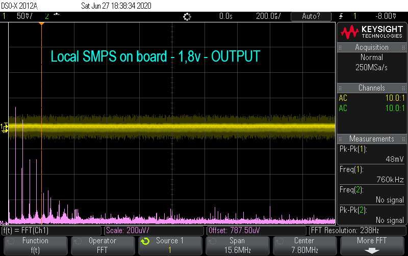

Some words about the system clock in this device...
An 25Mhz oscillator it run the main processor, and is also the only clock source for whole system. This oscillator it is powered from an small SMPS on board, used also for one of the processor power rails.
The pictures bellow it shows the noises on 1,8v power rail, at the SMPS output and at the oscillator power pin.

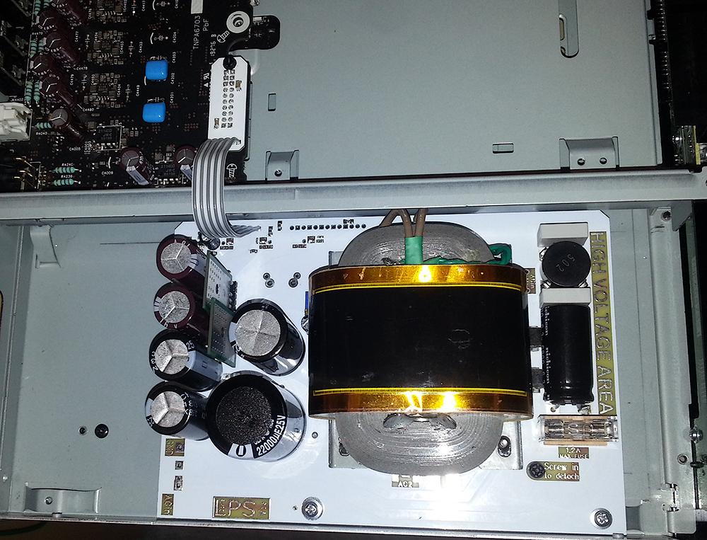

Joined 2009

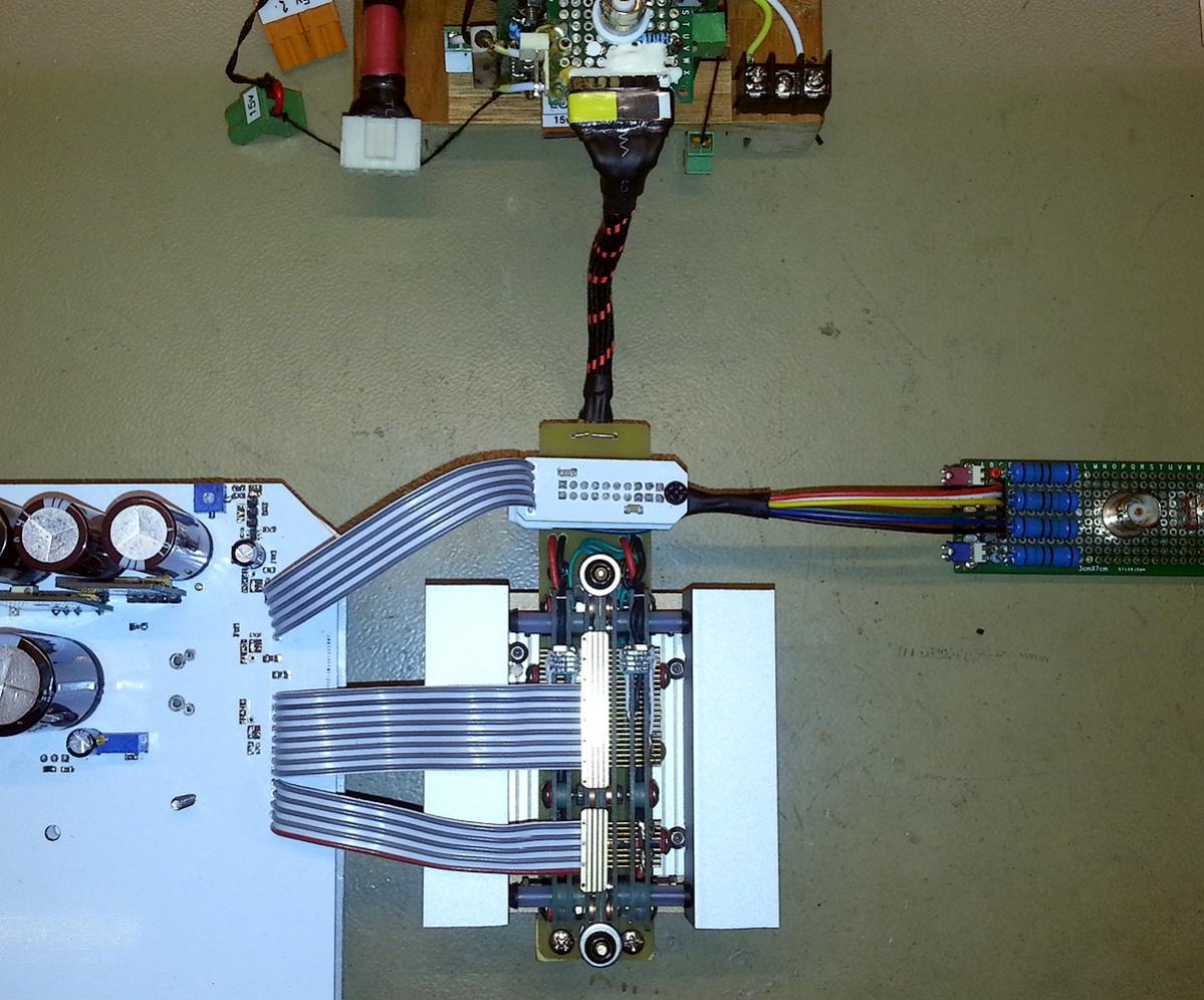

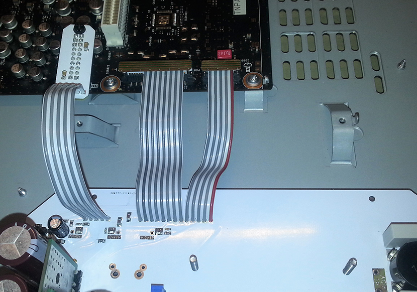

A step further... Connectors in place - perfectly fit.
Now I have to assembly an testing device. As the receptacles for those connectors are not available separately, a customised solution have to be in place. Working is ongoing...
Joined 2009
The working on UB9000 LPS it still ongoing... Some delays as well...
The out of standard power supply connectors in UB9000, and the impossibility of finding this component as spare part, it is a real challenge in adapting a LPS for this device. Well, I had to build from scratch a connection system for testing purposes, for my LPS for Panasonic UB9000.
I got also the new, and improved PCBs for this LPS. Now, the last step: the assembly and testing the final version of the UB9000 LPS...
