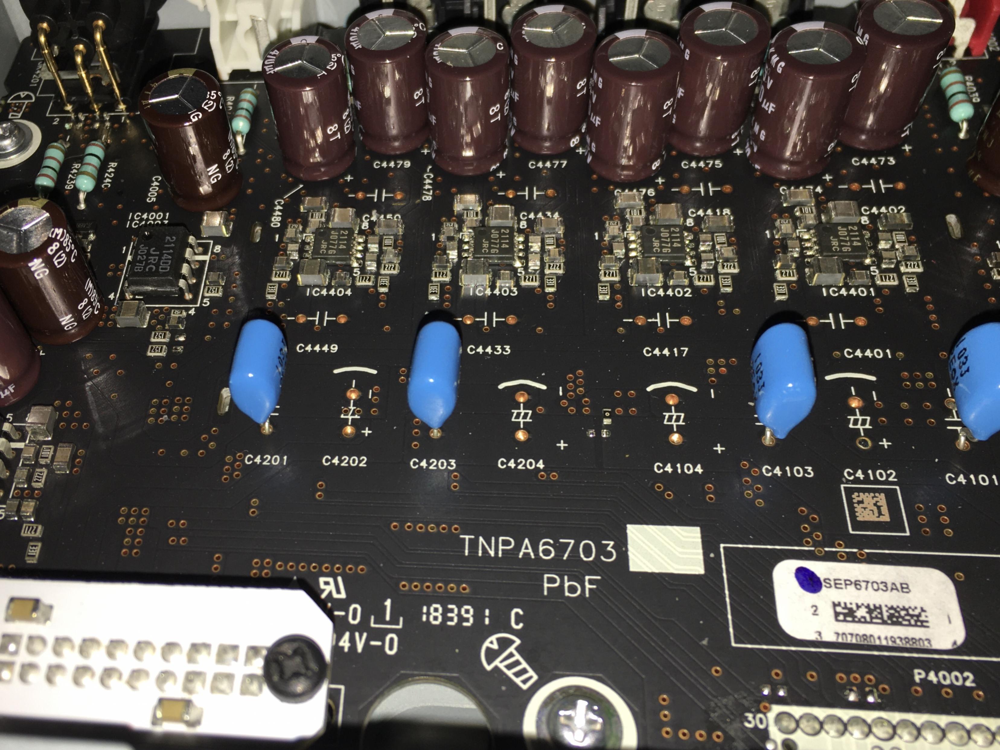

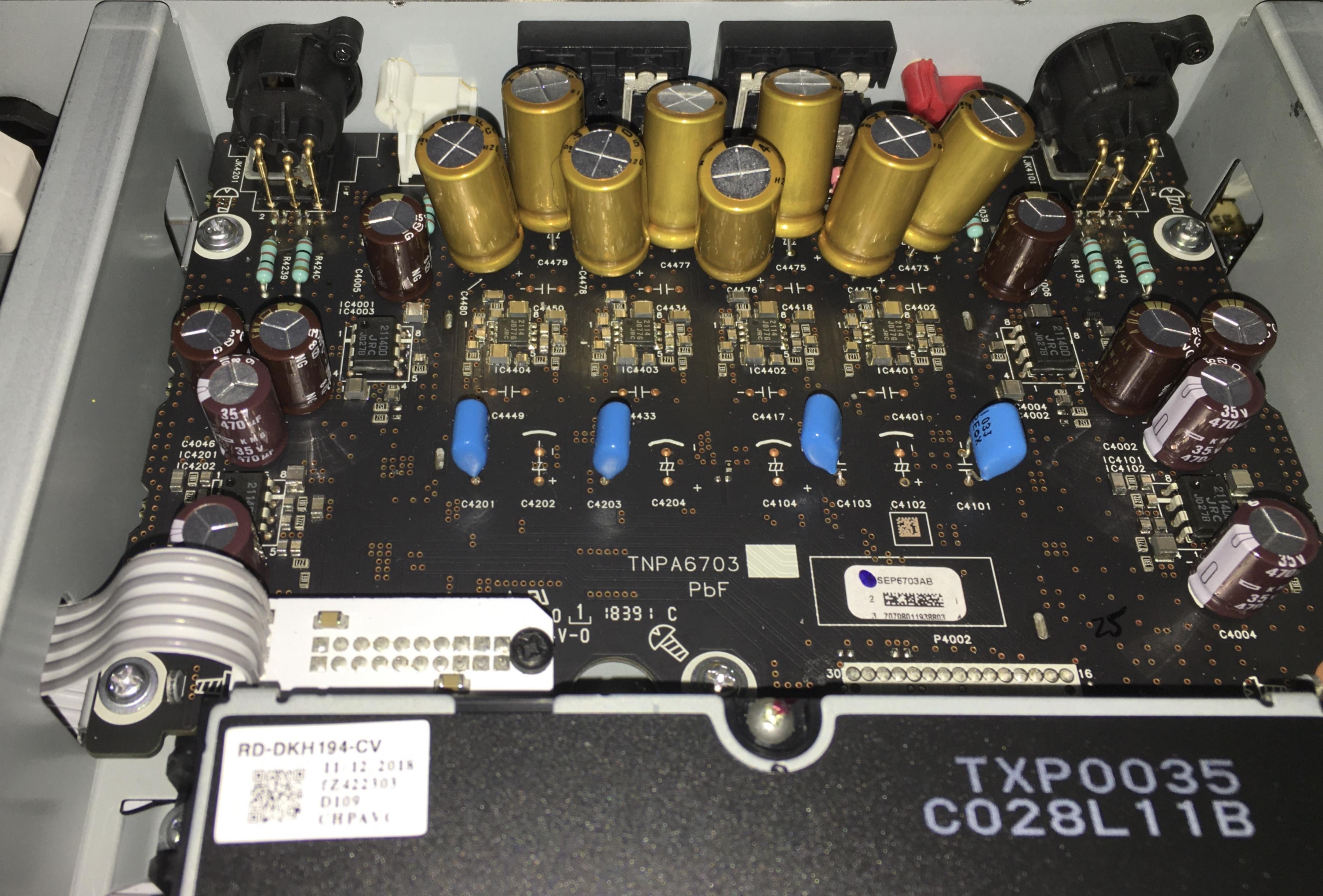

I have just noticed some pictures of the analogue board have some of the very small, .01 uF I think small blue caps, I can see places in the board for more and one picture shows them in place others, like mine missing any ideas on if these are worth fitting ?
The blue ceramic caps in slots either Side of the opamps ?
I have also seen some people replace these opamps with Texas ones any thoughts ?

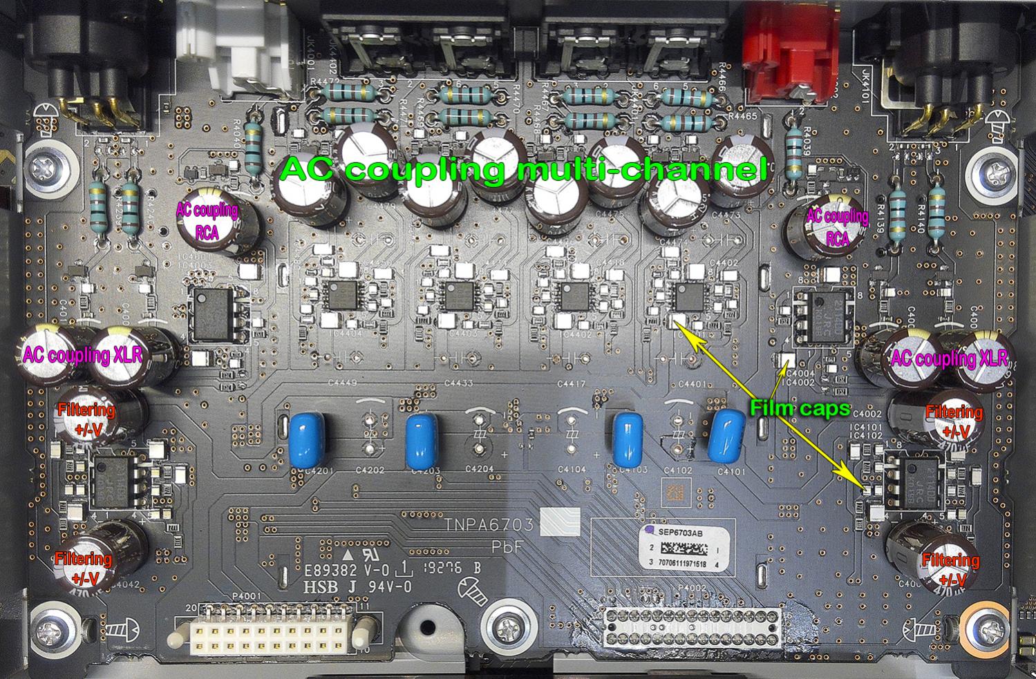

The caps marked on picture may be replaced for analogue sound improvements (AC coupling caps paralleled with 1µ film on back side).
The blue caps not necessary to be replace it. Please note that all the opamps on board are surrounded by film caps (good design!)

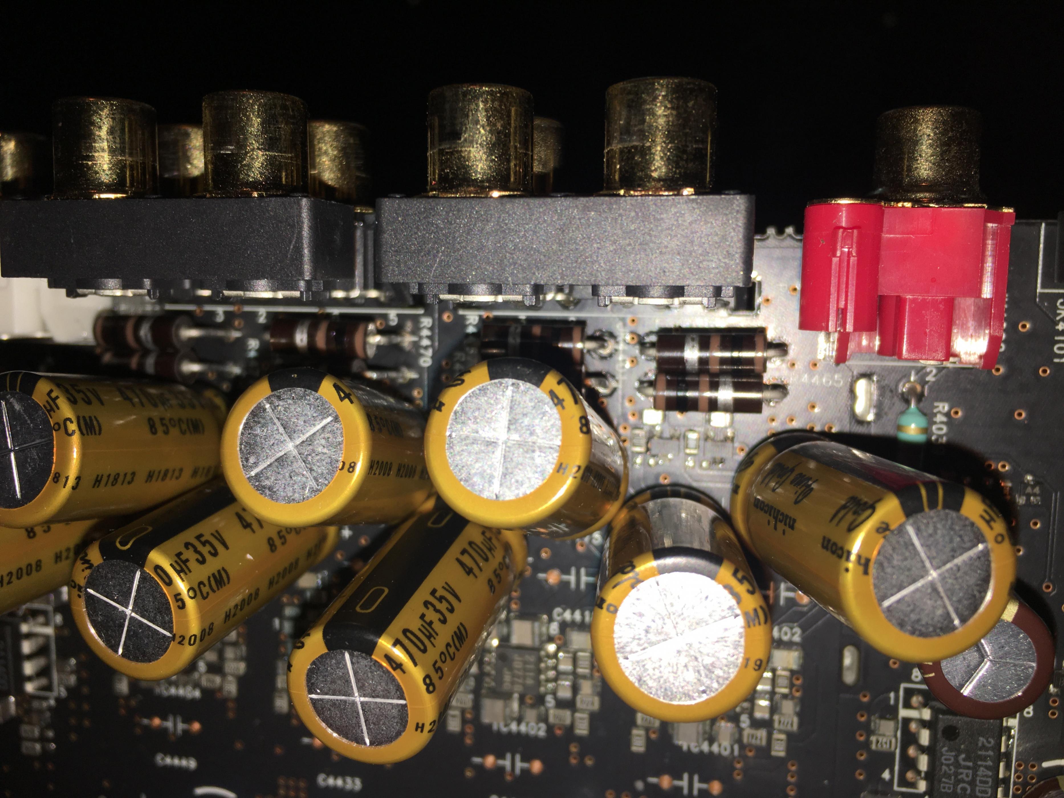

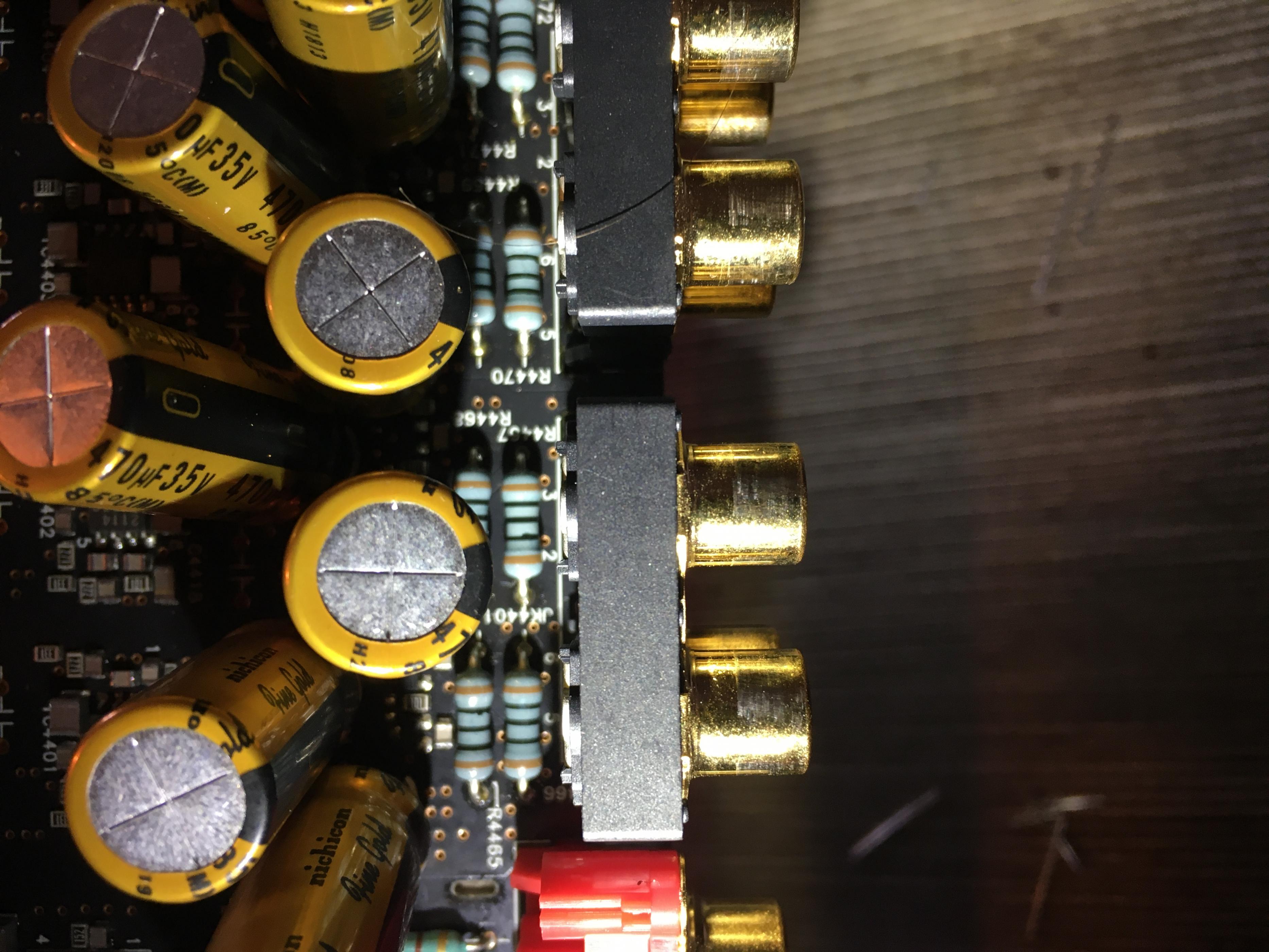

I did upgrade the caps and swapped the resistors to Takman Carbon as well yesterday, the Nichicon FG were larger and whist it looks a little unauthodox seems to be okay, I will have a listen later today I have checked al works okay and left it playing
I invested in a reasonable desolder station so feeling more confident now ! I can add the 1uf film caps, Wima's ?

Filtering +/-V caps it are placed (decoupling) on +/-12v lines which it are common to stereo and multi-channel sections.
The AC coupling caps it should always be unipolar types for best results. 1µ Wima are good. These caps it should be soldered on the electrolytic ones terminals (parallel it).
Okay a few words on the cap changes, I did run a few hours through before assessing, I know some don't agree but the recommendation was 100 hours for the Silmics
Overall a small step forward, in some respect less than I was hoping, all done at the same time so I cant separate the Nichicon FG with the Elna Silmic II's and the Takman resistors. But overall :
1. Resolution and clarity has been improved, lower level detail is more obvious and easier to seperate, there is less 'smearing and haze' everywhere, not obvious before but a little more of everything
2. Tonality is better there is a sense of more 'colour' and naturalness in the sounds you here, voices in particular sound very real
3. A marginal improvement in projection and scale, the scene seems a little bigger and broader
4. Unsure about any dynamics improvement, certainly no worse
5. A reduction in 'edginess' and the occasional hardness, seems as if any minor compression is reduced so its easier to listen at high levels
I am trying to compare to other upgrades, its noticeable but not transformational. I will try swapping out the TAKMAN resistors to the much loved Allen Bradley, which might be a little noisy (hopefully not) but if they do improve the dynamics a bit and or add some more colour to the tonality (By colour I don't mean colouration I mean the range of tones and the clarity of tones) then I can try some other resistors if I hear any difference
It is sounding very good as a system at the moment though, so maybe I should leave alone !
I have tried some Belden 8412 cable in a few places and have gone back to sharkwire, so that experiment failed ! I am tempted to try some Duelund in a few placed but that adds up

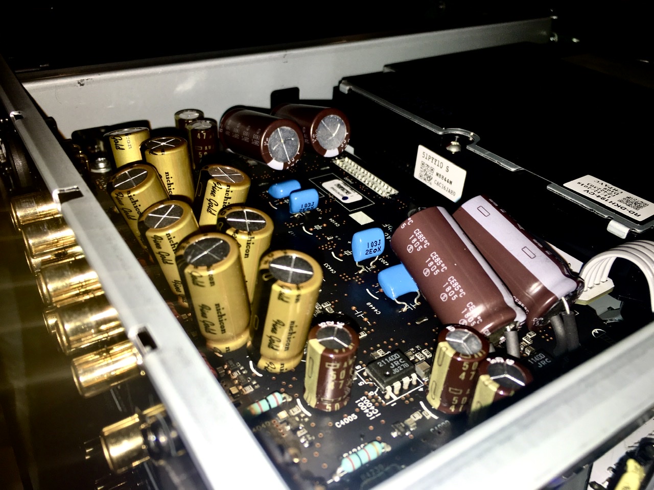

This seemed to be the perfect opportunity to send my 9000 off to Coris to get the LPS and hdmi board upgrade, so I shipped it off.
I only use my 9000 for movies and streaming, (Netflix and Iplayer) so I wasn't interested in the analogue audio upgrade.
Throughout the process Coris kept me informed of progress and provided the odd picture to show how my 9000 was changing.
The entire process, including shipping, took around 4 weeks.
I packaged it well on it's outbound journey but Coris had it even better packaged with a cardboard cover over the unit, within it's box.
The unit is heavier now with the LPS in it and feels like a really solid piece of kit.

After a few conversations I decided to put in some Takman Rey resistors to replace the Allen Bradley. A quick listen and the balance is immediately back and am hopeful that they will be better than the REX in this setting. Initial impressions very positive I think they are better than the REX and certainly better than the AB's
I'll write up a full summary after a few hours of running in, so far so good
Well the resistors have been back with the Takman Reys for a week and this is by far the best set so far. I am thinking of trying some Shinkoh, but cant buy 100 Ohm for the 8 signal resistors running to the RCA's. I assume these assist with the output impedance so dropping (I can buy 80 Ohm) might allow too much voltage to go through on the output and I'd run the possibility of clipping in the pre amp ?
I am really surprised how much difference they make
The Takman Rex were less dynamic in comparison (this seems top be a real strength of the Reys in this location) and although very good seemed a little reserved and polite, the AB's were just too recessed and 'thick' sounding with a lot of softeness and slowness to the overall presentation. However I really liked the lack of any glare or hardness and the in the room naturalness. The lack of resolution and lost ambiance was just way too great as well.
The Takman Rey are better than the Rex and AB in most areas. The low bass is superb the dynamics excellent, the are not cold thin or steely in any way, no glare or hardness but they do sound a little weaker in the lower mids, so some piano tracks sound a little lacking in comparison in certain harmonic overtones. They are really good and the best by a margin but I wonder if another hour with the soldering iron and some Shinkohs might be worth trying. I am still surprised just how much difference these resistors make.
