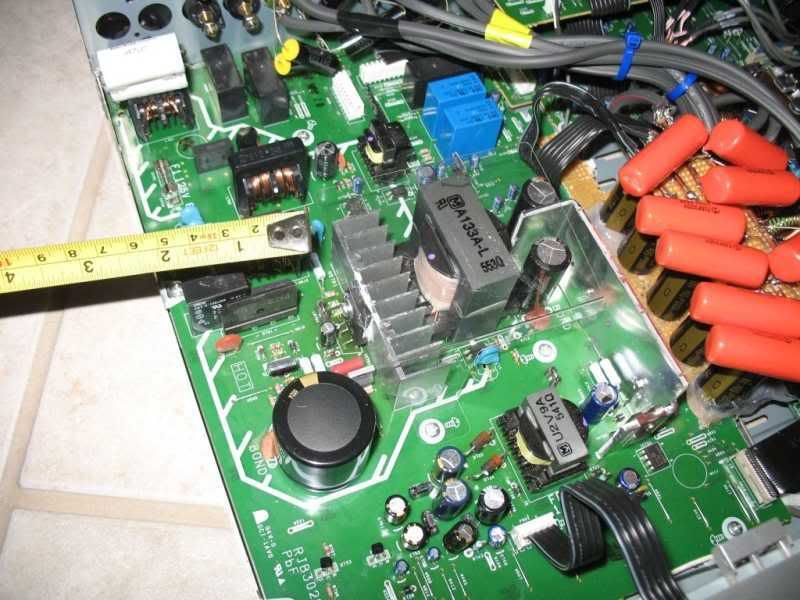

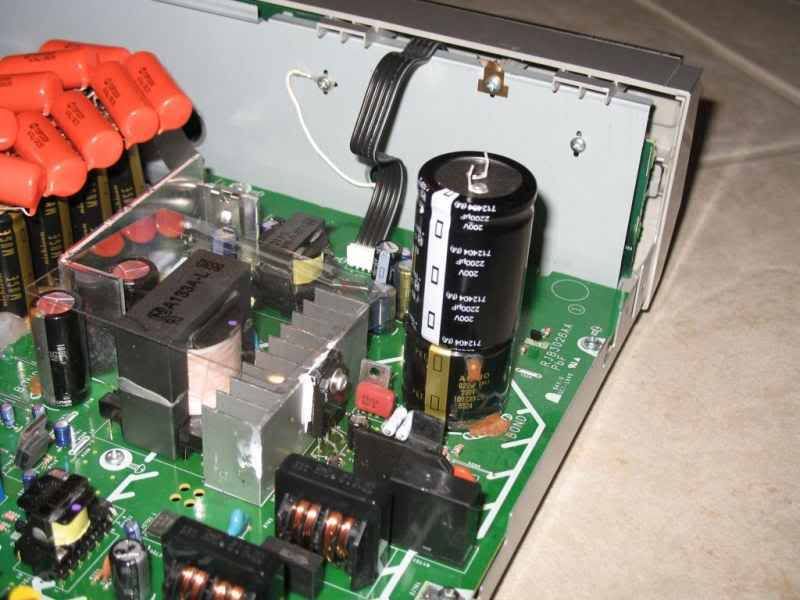

Hi jkeny,
Here are some pics that includes some of the mods I have done to the SAXR55 recently:

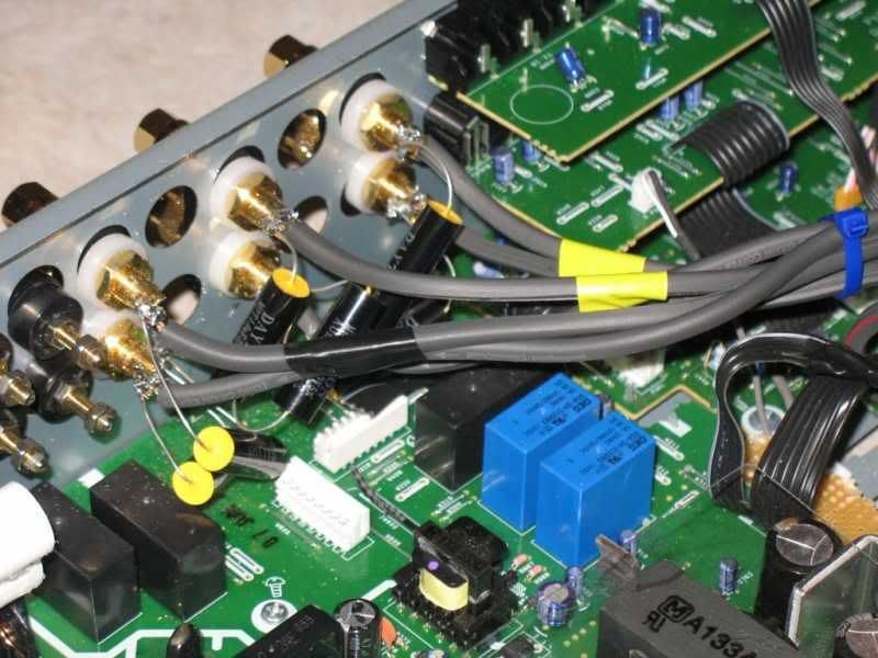

Dayton 1uF binding post filter caps:

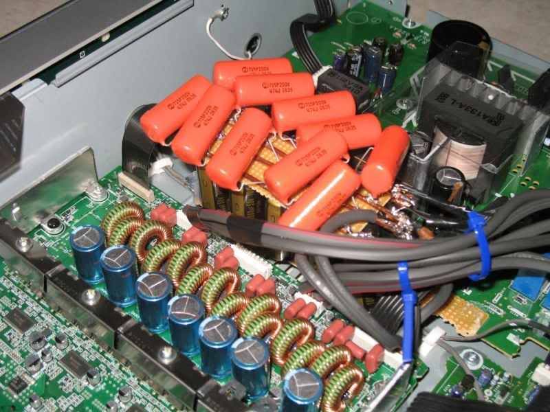

Vishay .47uF 715P and Nichicon KZ 1000uF power caps
The following is C707 possible replacement, probably will update this cap at the same time as upgrading the bridge diodes.
The Vishay SBYV28-200 looks like a really nice option. So we will have to build the bridge from scratch?

Nice pics eld,
Am I right in thinking you've got an extra 10,000uF in the PS now?
The C707 replacement is to cut down on any PS ripple, I take it? The new rectifier should help. Sorry, I actually have the BYQ28E-200 diodes, I got mixed up. These are dual diodes (slightly more expensive) so only 3 are needed for a bridge and 3 can be orientated so that they are in physical contact so the issue of thermal imbalance is somewhat alleviated.
Did you try the muting transistors? Are they the one's I identified?

Eld,
You replaced/added the 1.0uf dayton filter caps to ground on the new binding posts you added. I thought the stock value was 1000 Picofarads (on the XR-55)? You should have used 0.001 uf dayton caps instead. Maybe I am wrong here? Just trying to clarify.
Oh by the way, Use a Jensen 4-pole in the SMPS. I used a 1000uf/200v 4-pole. Did this a couple years ago on my XR-55 when I got it. Very nice improvement in bass/slam and depth. Stock it was too 1-notish I thought.

Good point Crazy-D, about the binding post filter caps!

Thank you very much for your help, rha61.
This is my first mod unit, so any help is greatly appreciated. I too was worry about the resonance issue of introducing the bypass to the electrolytic as you pointed out earlier, but so far, with the Vishay, this resonance seems to be small and not noticable. The plus side is greater detail, smoother mids and less strain at high volume. I will keep from adding any more caps, though.
I have changed the speakers filter caps to 1nF to match factory values. The floor noise seems higher without these filters in place.
The Pi filter sounds great. I didn't know what it was until your suggestion, but it looks like the stock unit has a built in Pi filter.
Again, thank you for your help. I will post an update as soon as the Jensen and soft recovery diodes are in.
Cheers!
Cheers!
jkeny,
The XEs are around 12.5mm x 25mm, I will try to measure them and let you know the next time I open up the unit (in a day or two).
Another possibility is following rha61 lead here, and remove all the XE caps and put a nice big one in their place.
I wonder if anyone have modded the XR55 and replaced these caps with anything better?

why a big cap ? because the experience shows that , for a same value , a bigger cap size sounds better ( no explanation for this )
for the ps caps near the switching Tr , i've put 100/50 Blackgte
the saxr45 has two pi filters ( if i remember ) and i add one , near the wall

Did you find the blackgates worked well in this position, next to the trafo? What criteria do you use to select your caps or is it by informed trial and error?
