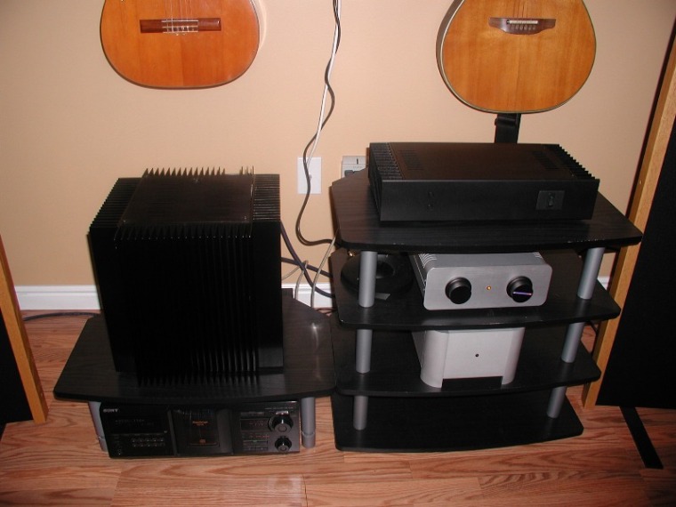

The Krell is King - it has officially unseated the UCD400...more clarity and control.
The Aleph will be another couple weeks to finish - got kids and an easily irritable wife in the way.
But the stock panny still does not disappoint.
Ah class A still beats out the new kids on the block, class D, eh! I'm going to build a zero feedback Class A amp ala Susan Parker which I believe will easily beat the Panny! But still interested in optimising this digital amp

The Krell boards are still around here (search Pinkmouse KSA-50) and was a somewhat easy build...It took me a couple weeks to find a little error of mine, but all works perfect now. For the entire build, maybe $250? Monster sinks gets pretty hot tho...pic attached with my krell to the left, UCD400 on bottom (Hexateq chassis) and other UCD400 on top, and my Audio Note M7 Tube Pre Clone in the middle...UCD400 on top is for sale btw...
Lots detail and "room" in the music. I notice when the panny is pushed, the music tends to get blended, whereas the krell keeps the separation and focus...
Next is the Aikido Tube Pre, Jfet BOZ Pre, the Aleph 60, and last is the Zen V5

The Krell is big, but only two of those sinks are connected and sinking any heat. I plan on adding a few more output pairs to the unused sinks to increase power to 100 - 120 wpc from 75 wpc
