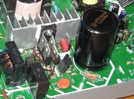

Hi guys,
Just wanted to report my latest round of mods and the results.
Mods:
1) Replace the stock C707 with a Jensen 4-poles 1,500uF/200V cap. Cut tracings to isolate input and output lines. ($62)
2) Replace the stock diodes bridge with a DIY Fairchild Stealth II diodes bridge. ($5)
3) Added two Panasonic TS-HA 15,000 uF caps after the ZE caps and before the Nichicon KZ/ Vishay caps. ($20)
4) Rewire the power lines to directly connect to the + and - tracings of the main board from the power board.
On a side note: I upgraded the power outlet to a FIM 880 (G)
After a week of listening from low to high volume, I can say that the results of the latest mods have elevated the Panny to an exceptional level. The 2nd harmonics are all there now in great details and depth. Violins and pianos sound natural and smooth. Imaging is rock solid. The stock sonic signature is still there, but the depth, smoothness, and soundstage are so much better. I'm very happy with the results. I think anything else that is done from this point on is just icing on the cake.

Thanks ELD for the pics and update.
I noticed on the schematic for the XR-57 (I know you have the XR-55) that they have control lines for the dual amp purpose to open or close the relays. However I assume this could just be all bypassed with a direct point to point feed from the amplifier board outputs straight to the binding posts since I would only use the unit in that sense and nothing else.
BTW, change that row of blue, water based caps to Rubycon 1000uf/50v ZL's.
I wonder how those CREE zero recovery diodes would sound in this receiver? Someone should do a diode test and report back sometime.

I connected the battery late tonight & need to listen for extended period but no obvious difference in the sound of the amp - maybe a little smoother, I'm not sure. I was expecting more of a diff,
Could be that I connect the battery direct without caps! (How much capacitance did you use dwk123?) Could be that the step-down trafo is providing a good clean PS feed from the mains? Could be that the PS in the XR57 is sophisticated ( I was impressed by the Kelvin sense used in the PS to take account of the inductance & resistance of the cables feeding PS to the output board)
I will put in some capacitance & have a longer audition.
I basically disconnected the cable from the PS board to the main board. This cable feeds PS & gnd to main board & takes back +sense & -sense from the main board as Kelvin sense. I connected the +sense to the +V on the cable & the -sense to gnd on the cable (basically connected pin 10 to pin 8 & pin 9 to pin 7).
This seems to work great - with just one battery of 11.35V the volume works as it did when connected to mains PS. I was expecting a flat area in the middle where variable voltage controls volume but I'm not sure I went into that area - didn't crank it all the way up as it was late at night.
