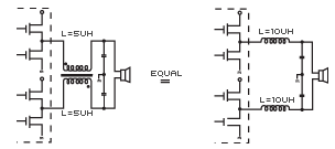

Also those output inductors look very close to one another - does this cause any crosstalk/distortion, I wonder? It will probably cause some mutual inductance as per Pulsus inductors here: http://www.pulsus.co.kr/english/products/pro_03_04a.html
Manufacturer of other pure digital amplifier chips!
Does this cause the effective inductance to be greater than the spec?
