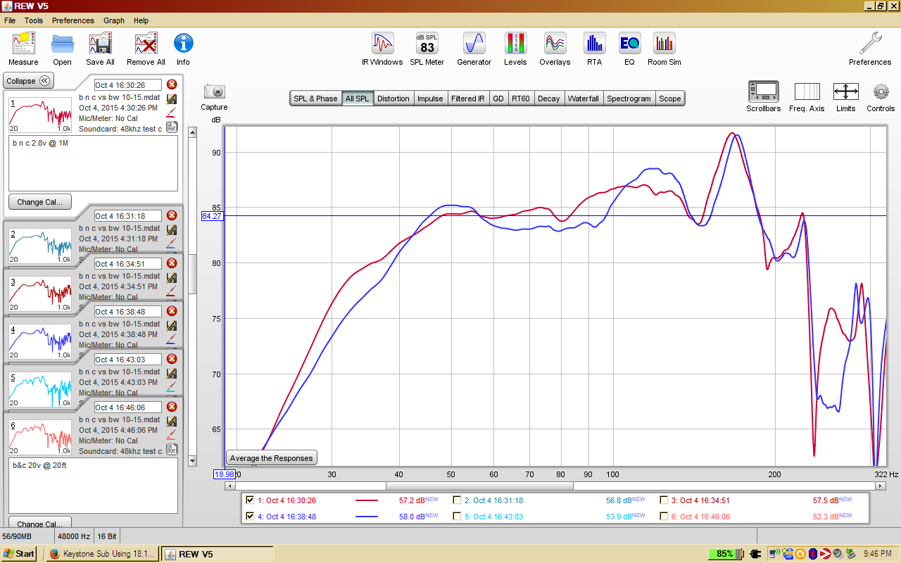

It's been a while but I'm feeling the call to build some subs again and I like the B Low Rider design. I have four Low Rider 18” speakers just waiting for a new home.
I thought I read somewhere a dimension change to fit a pair of 18s in the B-Lows ? Can't seem to find it now.
Would it be better to build four single driver cabs with Peavey 18s, or stay with a pair of twin driver units?
Any pointers greatly appreciated.
Well...the dual driver cabinet is bigger and heavier, singles are easy movable by one man band, however dual driver cabinets have more sensitivity, and if you feed em enough power more efficient than singles.
It is depend what you want to achieve, ask Art if he can modify it for dual 18"s and I will be glad to draw it.
The design was for the 15.25" diameter Low Rider, so all the dimensions that are 30.5" (2x15.25) would need to be increased to ~36.25 (2x18.125").I thought I read somewhere a dimension change to fit a pair of 18s in the B-Lows ?
More truck pack options with four cabinets than two, but increases overall weight.Would it be better to build four single driver cabs with Peavey 18s, or stay with a pair of twin driver units?
The 15" and 18" Low Rider use the same motor, so the "saddle" dip in frequency response between 40 and 90 Hz would be deeper.Any pointers greatly appreciated.
size and weight isn't a problem as these won't be moved much... a lower corner than the simple BR boxes they are in would be fun though 😊
ah yes, kind of like when I tried the 18" low riders in your Keystones?
The "Low Rider" Fb is around 35Hz, ~2Hz lower than the Keystone.size and weight isn't a problem as these won't be moved much... a lower corner than the simple BR boxes they are in would be fun though 😊
You already proved the 18" Low Rider doesn't have the guts for a low Fb in a tapped horn:
Why not lower your BR Fb by extending their ports?
Art
