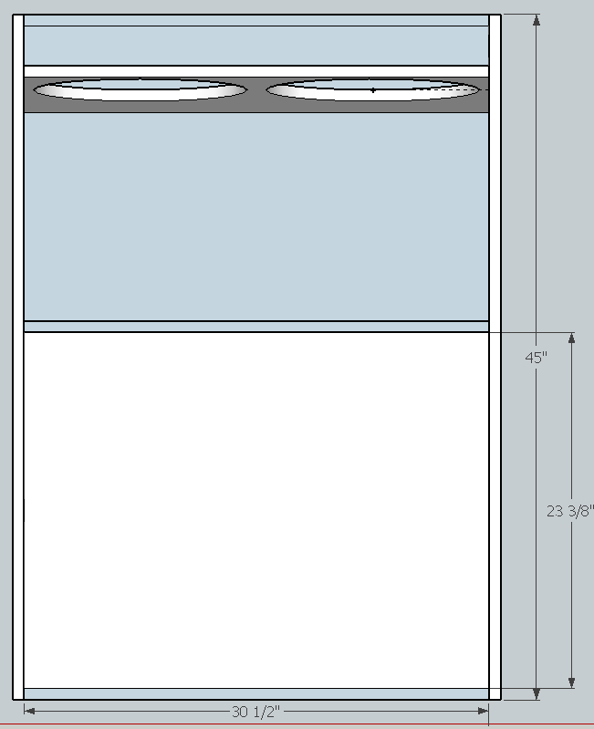

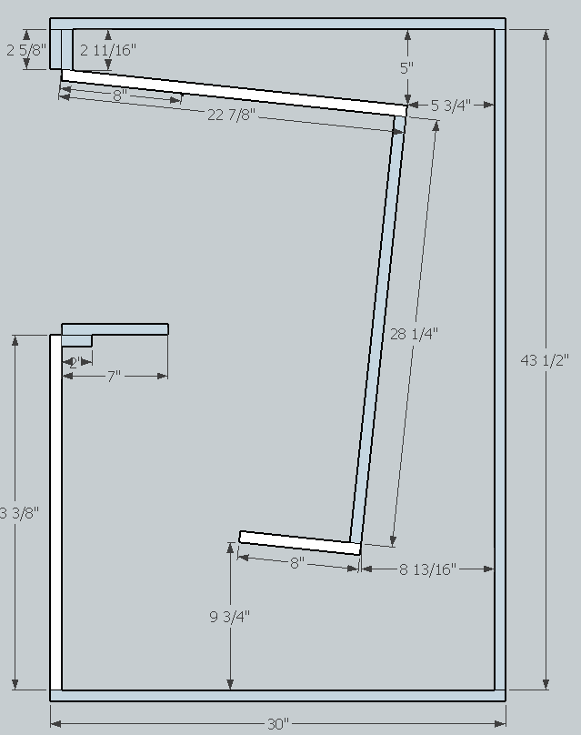

i found one one of your creations ,this doodle dated 1/17/08

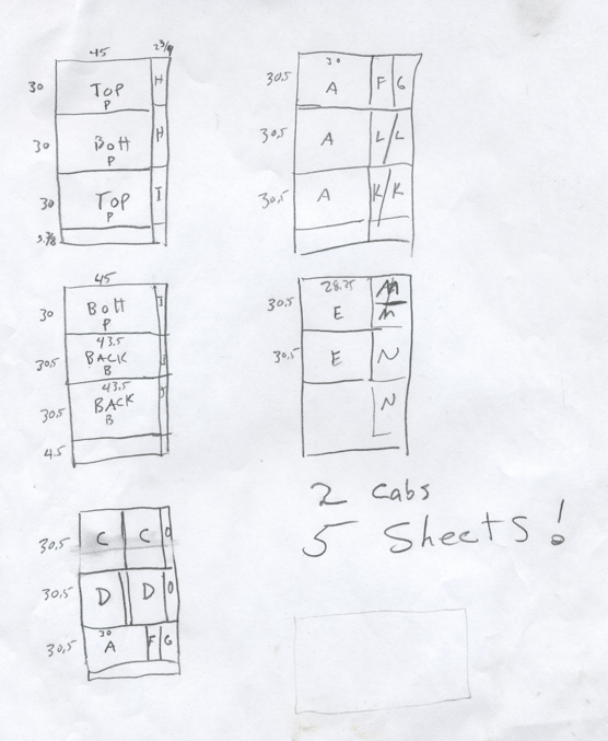

Cab is 45x30x43.5
it is for dual peavey low riders?
you named it B LOW RIDER
so it can hit the Low B on 5 string bass ?
31Hz

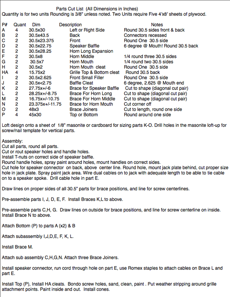

Yes.it is for dual Peavey Low Riders?
25 cubic foot exterior, 708 liters.
Two cabinets use five 4x8 sheets of plywood.
Yes, it could, though 30Hz was -6dB from 40 Hz.so it can hit the Low B on 5 string bass ?
31Hz
The excursion minima is probably closer to 35Hz than 30Hz, with 40 volts probably could expect around 123 dB at one meter reaching Xmax at 31Hz.

The builder, a Peavey dealer, had limited cabinet building experience, but he followed the directions well.Ohh and Art made a very detailed build guide!
The simple cabinet design worked pretty darn good 16 years ago, considering the drivers used, and no simulation used prior to the design.

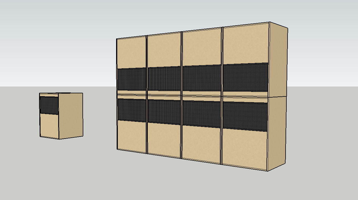

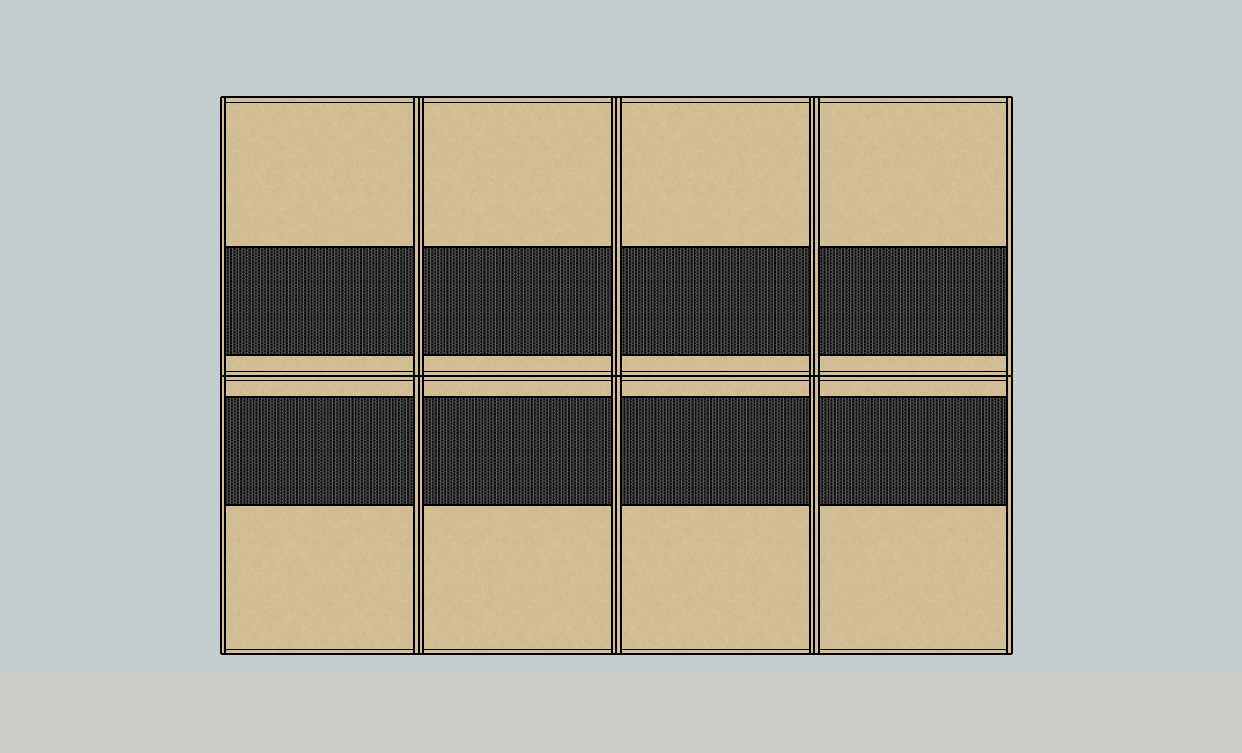

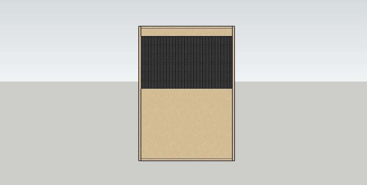

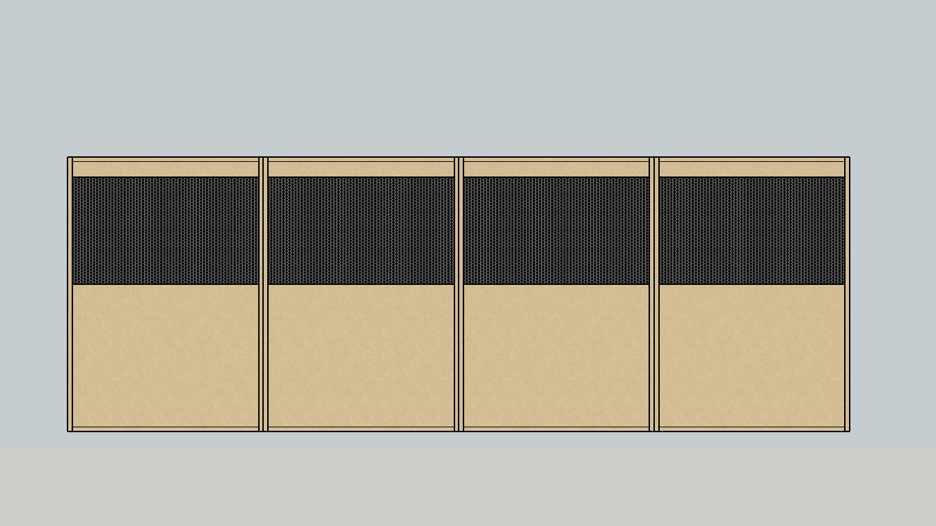

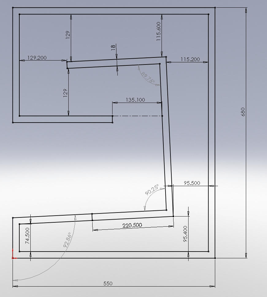

Nice!!! can the HR screen be created from the plans you shared
Dude, it's a TH-THAM design in a horizontal flip.
Dude, it preceded the THAM by almost three years, and the cones won't sag like the Thams 😉Dude, it's a TH-THAM design in a horizontal flip.
Brian Steele did about 8 years after the design was made, seems to be close to the response I measured:Nice!!! can the HR screen be created from the plans you shared

Is getting there, tomorrow i will post the 2D views with dimensions.
