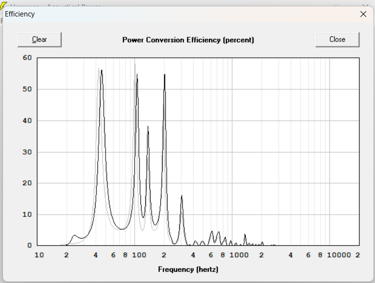

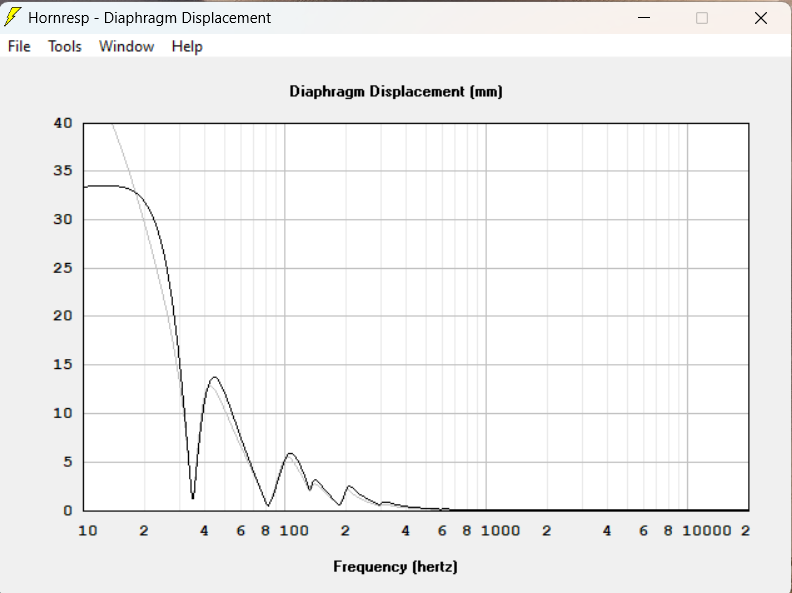

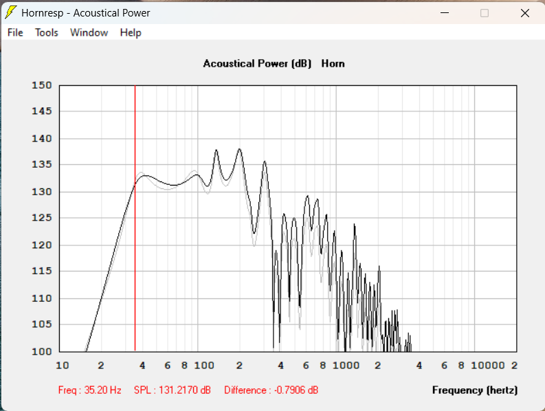

Here is sims of both the SB audience Nero 15sw800 and Rosso 15sw800, the Nero is the grey line and the Rosso the black line. There really isn't much in it as a raw voltage difference, and some may argue the slower roll-off characteristics of the rosso would be advantageous (I'd hazard a guess this is due to the Fs being far more suitable for a 35hz tuned tapped horn).
However the sims as shown are the same voltage - 67 volts- and the Nero does very slightly outperform the Rosso at the comparison frequency (35.2hz). In the real world the larger voice coil (4.5" vs 4"), cooling device which generates turbulence to cool the pole piece, and larger excursion would all allow for greater output IMO.
Of course the price goes up, and so does the weight too, as such in a home application or where more cabs is an option I'm not sure the Nero is really the winner.
