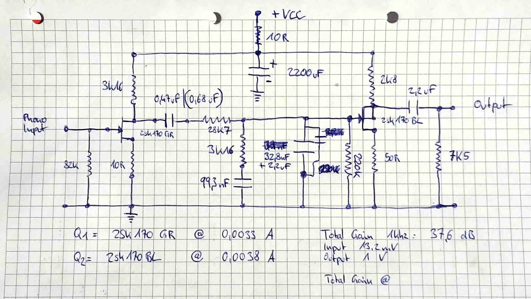

I did another handdrawn schematic, it doesnt look too clean, sorry. I am really interested how the simulated frequency response would look like.

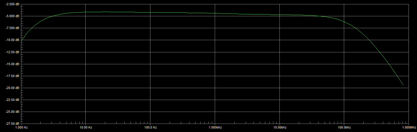

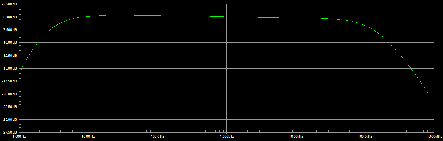

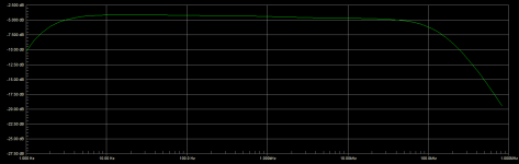

Here is your response with 7.5k load as in your schematic. And a second one with 75k load. Same shape in the HF but the gain goes up to 40dB and the sub bass roll off is shallow of course. You should not overload the output with less than ~28k load since it has 2.8k source impedance. You can alternatively shape the sub-bass roll off with a smaller value coupling capacitor either between stages or at the output.

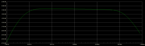

Hey Salas, thanks again for helping me out with simulating... How would you implement the sub bass roll off? Do i need it? I already tried a smaller coupling cap after the first stage but i had the feeling that this was no good idea, because of the very small signal the bass frequencies still have after the first stage.
What would happen if i drive the output coupling cap without the load like in the original pacific circuits?
You need some sub bass roll off not to pass too much of the records eccentricity and some other low Hz resonances to the amp and speakers. You know, that excessive woofer pumping thing that can happen in some systems when playing records. That is why there was a phono subsonic filter in old Hi-Fi amplifiers.
As it is you can simply use 27k instead of 7.5k at the output. It will not stress the output stage while having some roll off when retaining the smooth overall response shape.

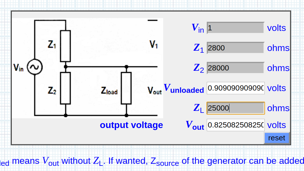

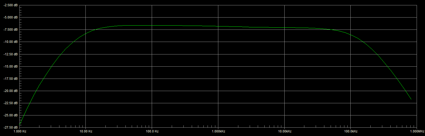

okay, i did some days of listening and testing. I am not happy yet and will try to improve the output section again. I want to avoid building a buffer stage but i maybe will have to. But before that, I calculated a bit and thought about the output capacitator size and especially its load resistance in combination with the input resistance of my amp (which is unknown but expected to be between 10k and 47k, so i calculated 25k)

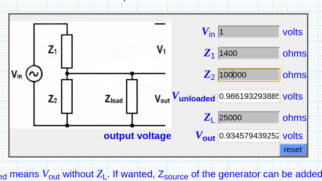

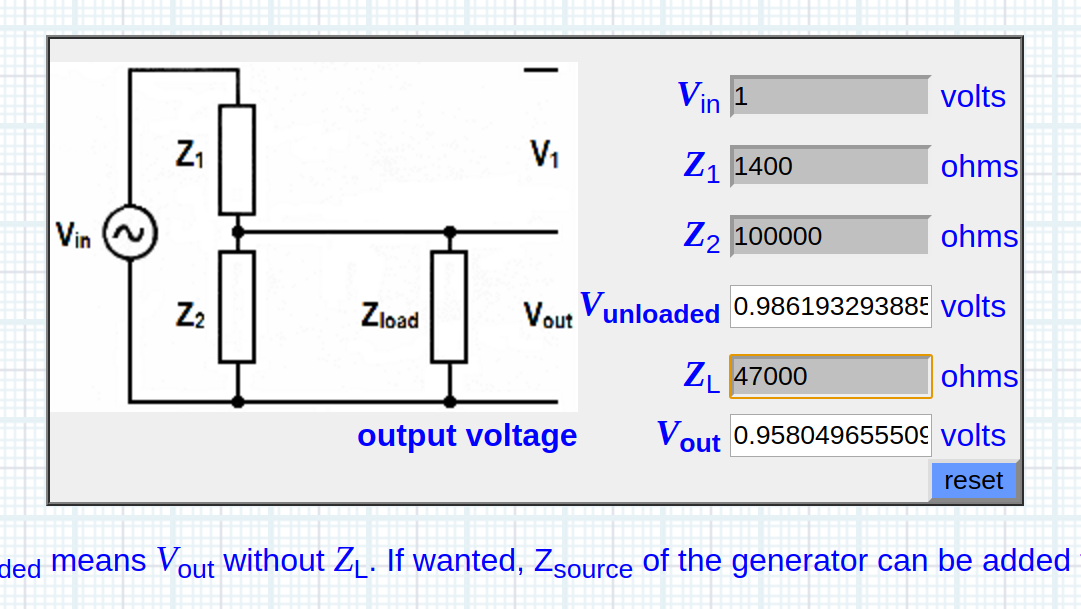

If we simplify things and calculate the output section of the preamp and the input impedance as a loaded voltage divider, i can see how bad the driving capabilitys of my circuit are (see picture 1).

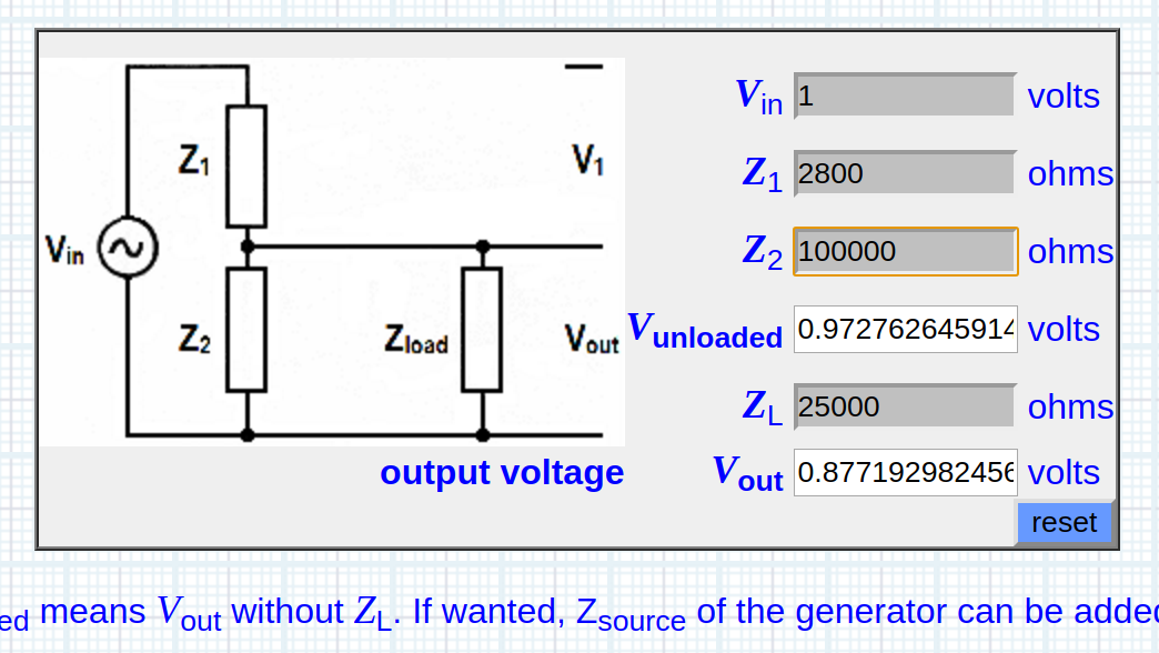

With my highish preamp source impedance of 2k8 ohm and my output cap load resistance of 28k ohm and a 25k'ish input impedance of my amp, only 82% of the voltage arrives at the input of the amp. (picture 1)
Fiddling around with the different values showed me that a first aid would be to put 100k instead of the 28k output coupling cap load resistor i use now. With an input impedance of 25k, 76% of the original signal will arrive at the amps input (picture 2)
But the final conclusion is if i want better drive capability i need to lower my output impedance. To lower my output impedance i would have to replace the drain resistor of Q2 with 1400 Ohm (instead of 2800 Ohm).
I will lower my output coupling cap to .680 uF. I already checked that would be okay if change my circuit to match the scheme to the newest version ( picture 4 )

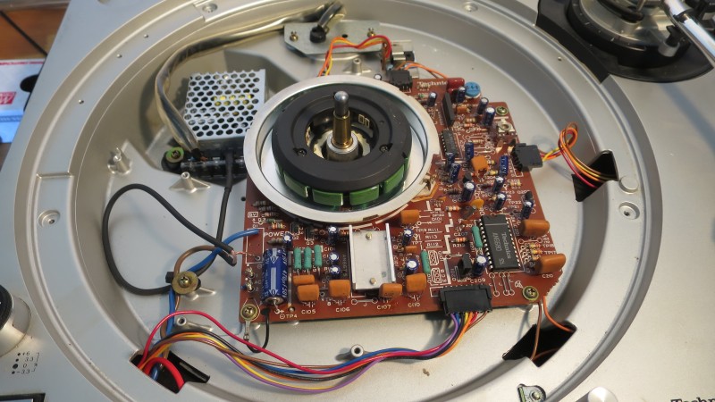

Little update: after some more testing i located the source oft the hum when my dl-110 sits on the record, but the platter is not turning. It is the transformer oft my 1200 which seems to create a very small vibration at 50hz. The Motor itself works with DC not AC.
So the next big project is to move the transformer out oft the technics case and put it in a external box.

As we speculated it picks it from the TT then. No AC motor in this case but... hello naughty transfo. Alright, nice that you located the source of that little nuisance. Maybe some Mu-Metal shielding application could be less of pain to fix the situation (?)
I guess the trafo has mechanic vibrations, not electromagnetic hum. Because the hum is only present when i put the needle in the record whilst the platter is NOT moving. The hum seems to be induced in a mechanical way. If i just place the needle next to the platter (using the needle protection plastic as a stand) there is no hum at all. Thats why i dont believe that electromagnetic fields are causing the hum in this case. The problem is very audible with low compliance carts. With Ortofon DJ Cart the hum signal is much loser, maybe because they are more "stiff"?

After our latest reasonings i read a lot of threads about noisy technics 1200 mkII transformers and decided to install a simple SMPS instead of it. I removed the internal transformer and put a Meanwell RS-15-24 inside the deck. That totally solved my hum problem that i had with the needle sitting on the non-rotating record groove. Now it is dead-quiet.
I will improve the implementation of the SMPS further, but for now i am pretty satisfied. Costs: $ 10,- for the ready-made SMPS. Effect: much less noise, hearable better soundstage, more defined and clear bass then before. Biggest bang for the buck i have seen yet.
