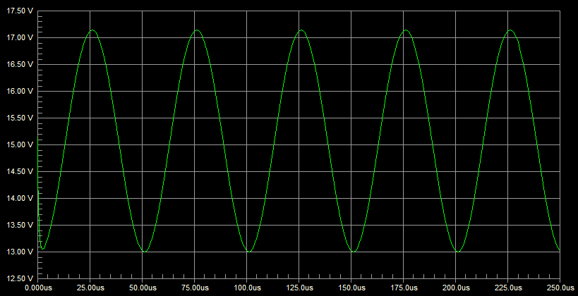

A 5mV cart at 5cm/sec 1kHz will do 50mV at 20kHz on 20dB records pre-emphasis assuming there is same potential musical groove content there. Now lets think 18dB above nominal as are the highest test records torture tracks that make most needle profiles skip. 5mV+18dB=5x8=40mV=113mV pk-pk. Very unlikely in music but lets think that there are pops and clicks in every less than pristine state record that will be the real offenders. If you will drop the first stage's gain too much the noise will go up.

I run a sim for you and I see circa 4Vpk-pk at 20kHz at the output node of a 29.65dB gain fist stage. Driven from a 5mV (1kHz nominal) cart simulation fed through a RIAA pre-emphasis network. Biased at little above 15Vdc you can see the swing around that point. 8Vdc bias allows for double that swing...
