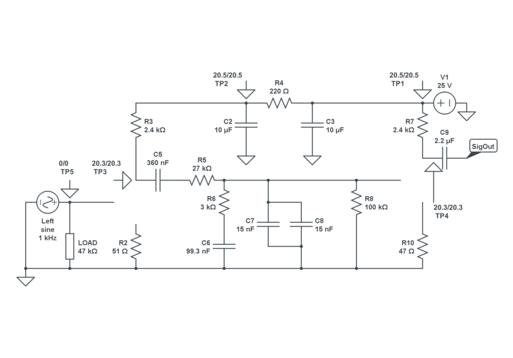

improved bass response by moving coupling cap
Update: my soldering iron did not run cold after my last postings. In my newest, cleanest version i applied some helpful changes. I use 50 ohm trimmers as source resistors only for the second transistor stage. Cant hear the difference to fixed resistors, but it helps me searching for the sweet spot biasing point. Together with the variable VCC it gives me more different ways to set the voltages and biasing points on the first jfet (with fixed Rs of 12R7) and on the second jfet.
But the biggest improvement came from moving the coupling cap at the output of the first jfet stage to the input of the second stage. I saw a lot of people in the forums doing this with the pacific topology. But i did not understand why it would sound different.
Now i thought about it again and realised that right after the first jfet stage the frequency spectrum is still bended according to the RIAA curve.
But after the RIAA filter stage, right in front of the second jfet stage, the signal is low level, but already "flat". If you place a coupling cap there it will see a higher amount of bass (compared to the amount of highs) in the signal. In combination with the gate-to-ground resistor of the second jfet (220k in my case) a mild highpass with fc around 3 Hz is formed without too much attentuation of the audible band.
I guess there are more professional ways to describe this, sorry 😀
Will come back with my actual schematic for everyone that might find this thread somewhen in the future 🙂

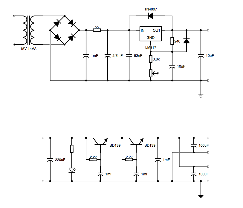

Comprehensive schematic.
That was about my hand drawing. But I wanted it cleaner for archive file.
So I've done my homework, nice little supply with top circuit in a remote case, bottom one in the phono's one.
The software is iCircuit on Mac OS, lacking parts but I guess they're working on it.
Looks good, nice drawing 🙂 How does your power supply sound like? Mine is exactly the same lm317 circuit followed by the capacitance multiplier, but powered by a smps wallwart. I checked different models of wallwarts, some are noisy, but mine (the cheapest Voltcraft model) seems to be dead quiet..
I found some hints in the web, that it is good when all the capacitors of the capacitance multiplier share one star ground point. Changing the capacitor ground rail to a star ground totally killed the last amount of hum in my case..
Example: http://sound.whsites.net/p15_fig3.gif
Hi, sadly the shape of my circuit is the only one that fits in my tiny phono box, it's only a quick build with mostly drawer spare parts (but the JFet). Anyway it's a very good sounding "waiting until better" phono pre, and quite silent!
Let's enjoy the LPs 😉 And thanks that guy named Salas!
finally my Hagtech inverse Riaa unit arrived 🙂 I did some basic square wave measurements on some the phono preamps using the inverse Riaa.
Phono Input Allen Heath xone 92: weak bass response under 50 Hz, bass boost at about 70 Hz, not-so-square looking waves at the output.
No-Name opamp phono preamp: way better looking square wave response.
Pacific: very good looking square wave output at 100Hz, 1khz and 10khz. At 10khz the square wave output looks like there is too much attentuation at high frequencies. But keep in mind that the Hagtech inverse Riaa comes with an additional zero at 50khz, which is not represented in the circuit i used. So the square wave output will always look a bit "rounded" as long as i do not implement the "missing Neuman constant" at 3,18us.
After my holidays i will continue with more comprehensive measurements including some integrated phono preamps. Very interesting topic!

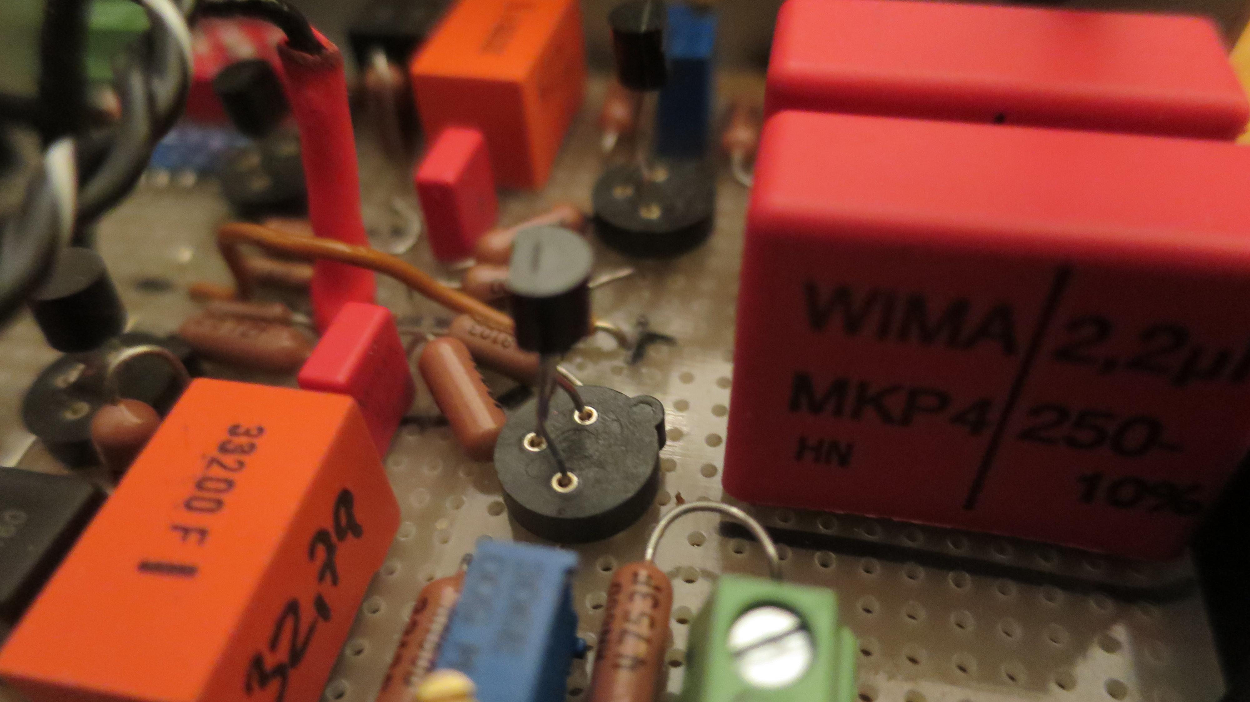

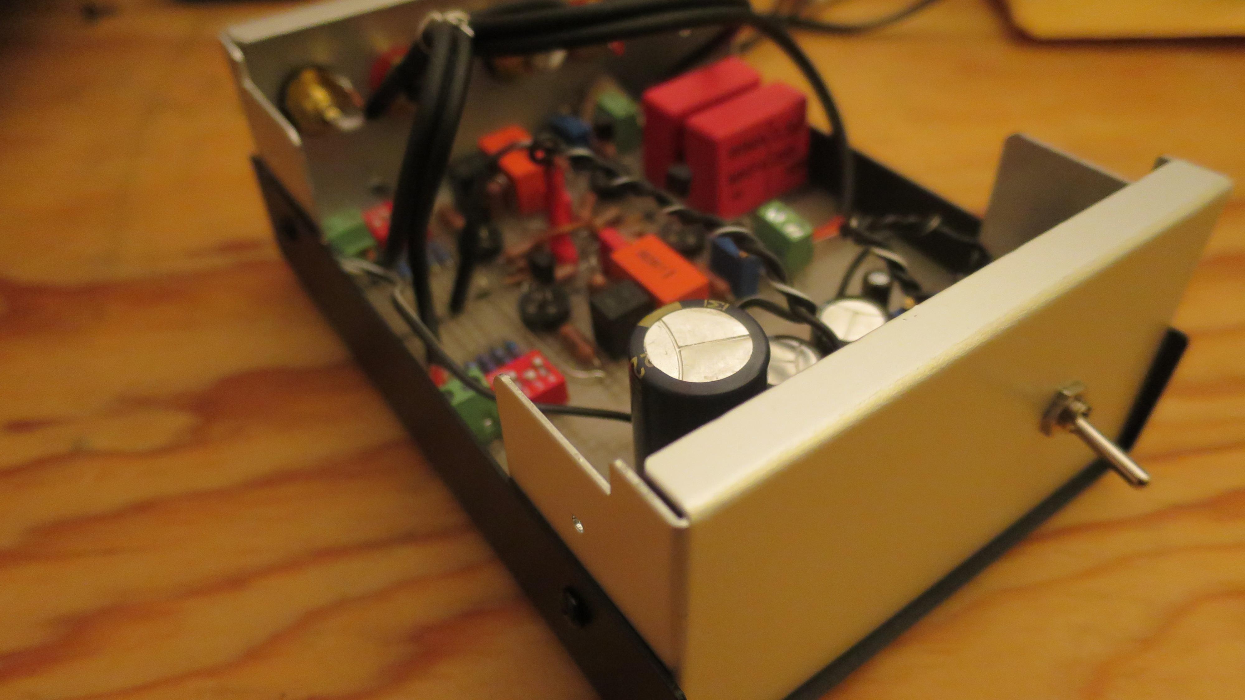

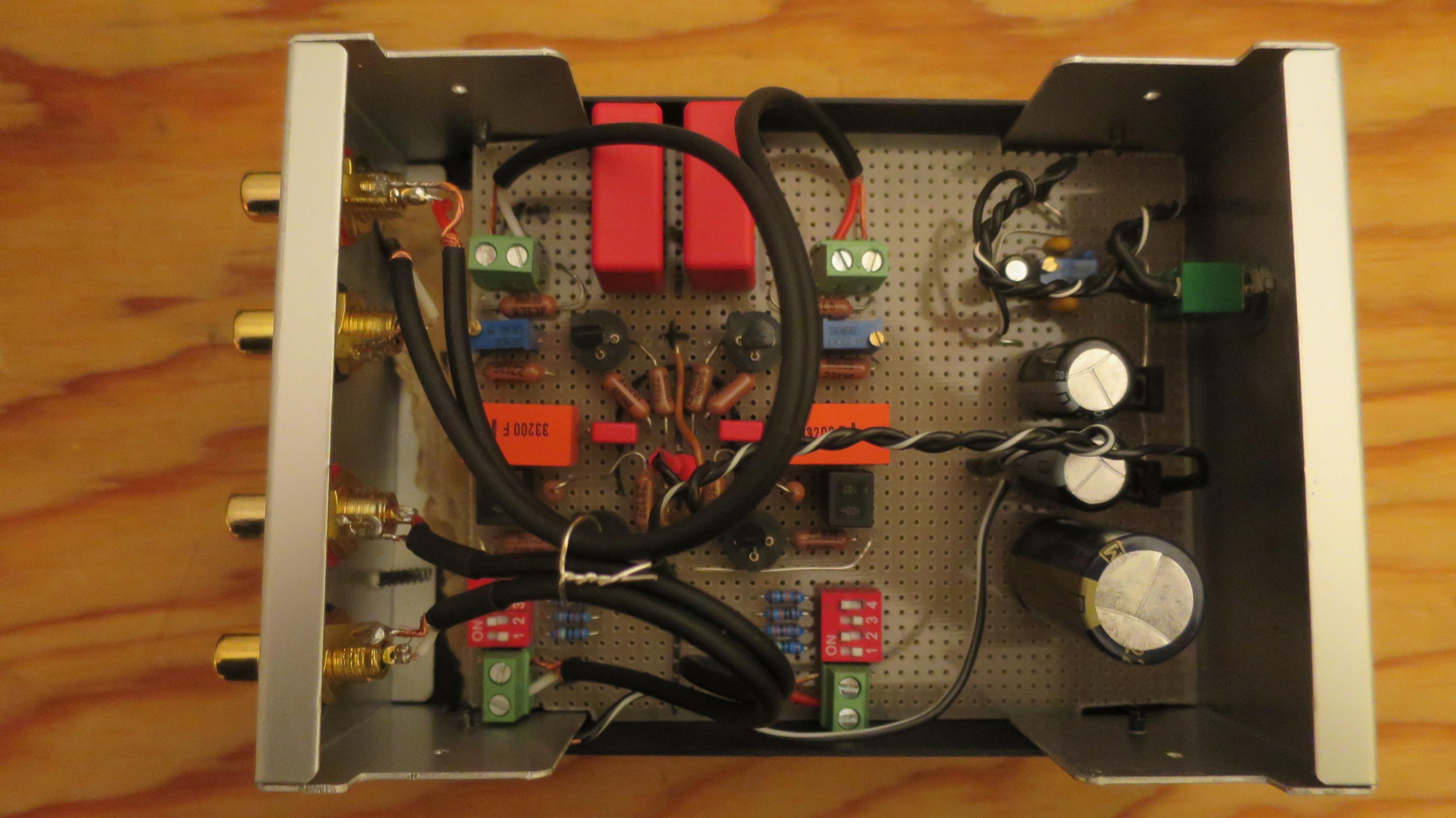

some updates and pictures

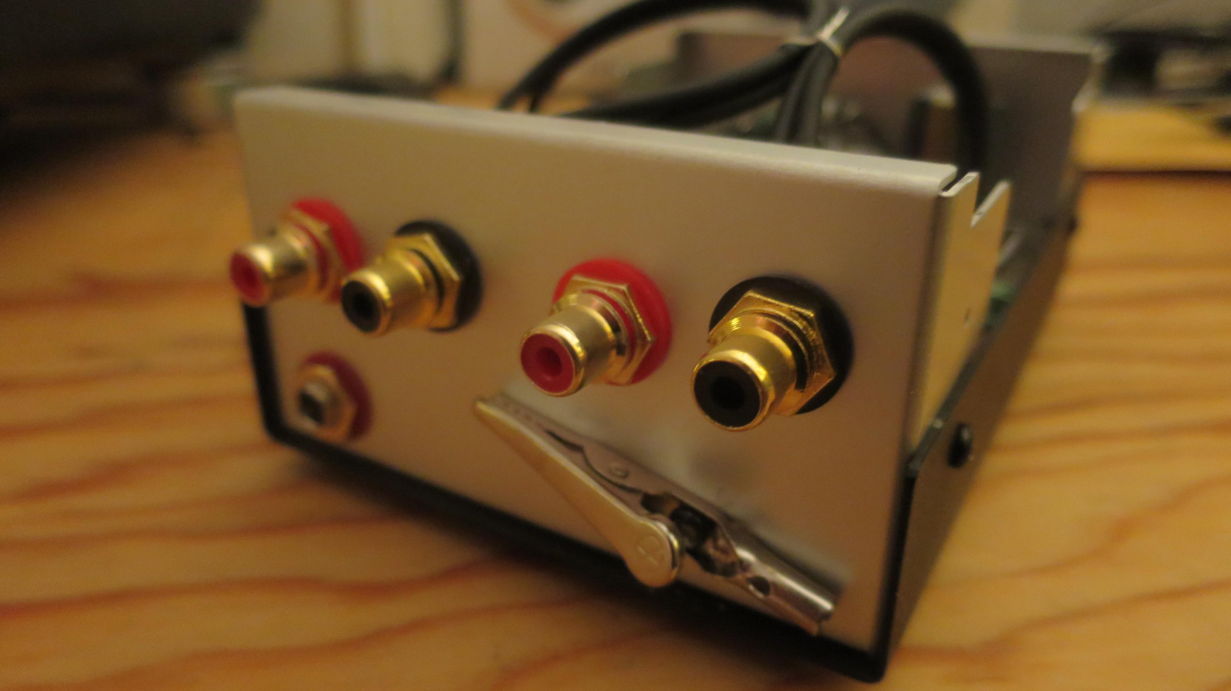

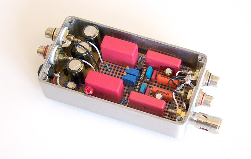

Hey all, still got that jFet fever.. I just wanted to share some pics of one of my last builds. It is build using perfboard and silver wire. I used sockets for the jFets to be able to switch them quick.
There are 4 resistors on the input that can be switched using the dip switches. They are to adjust the input impedance of the preamp in 16 steps from 17kohm to 150 kohm. I stole this idea from muffsy preamp documentation and i am very happy with it. If i would like opamps i would try his cnc clones for sure..
I used HiFi2000 economy case and I think its great for experimental use. Of course it doesnt feel like an expensive, classy case, but it turns your prototype pcb into a usable device for only 6 Euros.
In another build I experimented with an additional 98R resistor in front of the smaller cap in the Riaa filter section (32,8 nF). That should implement the "missing time constant" or technically speaken add a zero at 3.18 µS. Can't hear a difference with my ears, but measures a little better when using the Hagtech inverse Riaa (which implements the fourth time constant into its filter network).
That build measures a total gain of about 42 dB (i am still to stupid to do the gain maths right). That is a very suitable gain structure for my Denon DL-110.
It also plays fine with MM Carts up to 5mV@1kHz nominal output.
Next step will be to try a salas folded phono ;-) But first i have to stop soldering and start moving to my next flat.
Thanks again to everyone who helped me out and answered a lot of questions :cheers:

Now THAT's Just Too Cool 4 School !
Hi Malefoda 😀
I have been following your story Thread on & off here for a few years. 😎
I have loved the look of 'Le Pacific' & all it's variants for a while now.
I must have a go one day ! 🙄
679158d1525708128-pacific-riaa-phono-pre-failure-pacific-jpg
I gotta say ... WOW ! that is some super-slick building you have ended up with. 😱
I thought you might have swapped the DIY soldering-iron for a store bought preamp at one point. 🙁
It has taken a few years !!
But that lil' box of tricks of yours is a masterpiece & a Faberge egg of the RIAA type ! 😉
CONGRATS !
Si.
I hope the Judges are in a good mood today. :judge: :boggled:
thanks for good words, but don't know if sweating, loose appetite and sleep when two resistors are not perfectly parallel or colour rings oriented the same is a gift, sounds more like a disease to me. =) If only I can build speaker the same way...

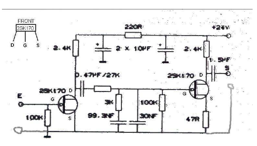

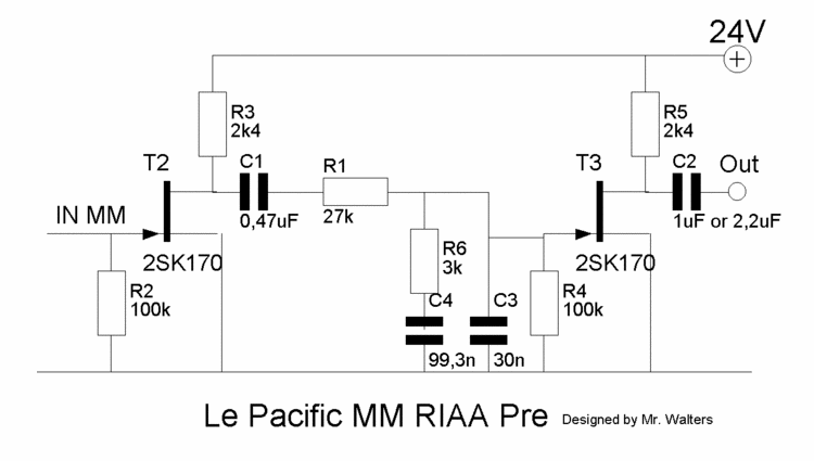

If your last configuration was how it was finally made ... 😕
... it is interesting to see that you deviated very little from the original Mr Walters version.
It looks pretty much like the only thing you changed/added were 2 source resistors & 2 gate-stoppers. 😕
No tweaking of the EQ parts.
No moving of the coupling capacitor to after the EQ.
No extra 1M resistor on the output.
It sounded not that great
Hi Malefoda
OK ... But with fake 😡 Toshs in the trash ...
... Hot :hot: new PSU ...
... & of course top build :Pirate: quality ...
... it sounds good now right ? 😎
What did you do to your EQ that is different to your final schematic then ?
Top :$: :$: :$: hi-end parts ? 😉
Just curious. 😛
You DO like the final result ... right ? :whazzat:
Si.
C3 (on the post#47) higher value, and no, no high-end parts, matched Toshiba and parts, other parts I do have in drawers. BTW Wima MKP10 are said not that bad, few MKT caps also, I guess hand matching helps. Steve Clark's riffs sound great at that what's matter for that year to build little monster in a shiny egg! That's just a waiting cheap phono pre for me, but I can live with it in fact 😉
