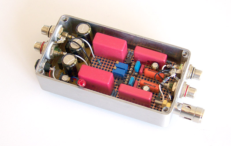

I measured again with my fg and oscilloscope, using the following method:
mh-audio.nl - Home
I noticed a loss of low bass compared to my previous version. I have -2.254 db loss at 20 Hz. At 40 Hz = -0.9 db, at 50 Hz = -0.665 dB, at 60 Hz = -0.19 dB, at 80 Hz -0.18 dB.
maybe my first coupling cap is too small? Or is it about the corner frequencies of the Riaa curve?
Frequencies from 100 Hz to 8 kHz are all boosted by +0.2 dB to +0.4 dB.
At 15 kHz it measures +0.8 dB and at 20 kHz its +0.7dB.
I will draw a new circuit scheme with my actual values to complete documentation. Thanks for your offer to simulate it sometimes to compare simulation and measuring.
I fear that my measuring tolerances are up to 1dB or more, so it is more about seeing a trend then measuring it exactly. But what we can see is that 20Hz has a loss of almost 3dB while 20 kHz is boosted by 0.7dB (i want to keep the boost at 20 kHz because of my dull sounding mm carts ;-).

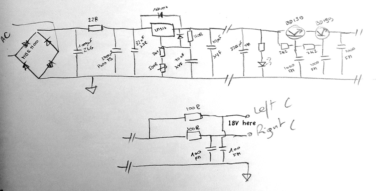

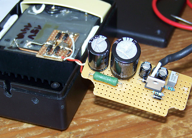

Done, LM317 adjusted for 18V (after the 100R added before each channel for filtering/separation), 9V at Q2's drain. So far no smoke. It's a funny slow charging supply (about a minute), and I guess the output DC drift is caused by this. My DMM shows nothing obvious at outputs (what can be real levels of faint hum or such? Well below the DMM abilities?), next step is to put it back in service. And that's the scary part...

It's up and running. I feel it's a touch cleaner and has more and better bass. Great bass that no cheap CD player/DAC can do. I admint my former supply was a recycled one, not a dedicated one like now, enough for a real gain or it's all in my head?

Its a real gain I believe. Sounds more like a battery supply now from the way you describe. I can see three same capacitors in the multiplier (probably 1000uF) but can you sketch what more you added and how you connected it, as you mentioned 100R resistors, and I also see one smaller capacitor there?

Comprehensive schematic. Thanks. So the 100R 100uF RC filters are positioned after the 1000uF multiplier's output capacitor? If yes bypass those resistors and listen again. The cells with smaller caps do improve split theoretically but alter the output impedance of the multiplier also. Given your layout characteristics and the specific phono maybe they help or not.
Yes the "18V here" is where I measured for the LM317 adjustement, the supply being applied before that small RC.

That's not strictly true. It only takes 1.35V Vin-Vout drop across the whole cascaded multiplier for both transistors to work as intended for the few mA consumption level his phono has.

Chance to get better. You don't have to remove the 100R resistors. Just bypass them with wires for the test.
