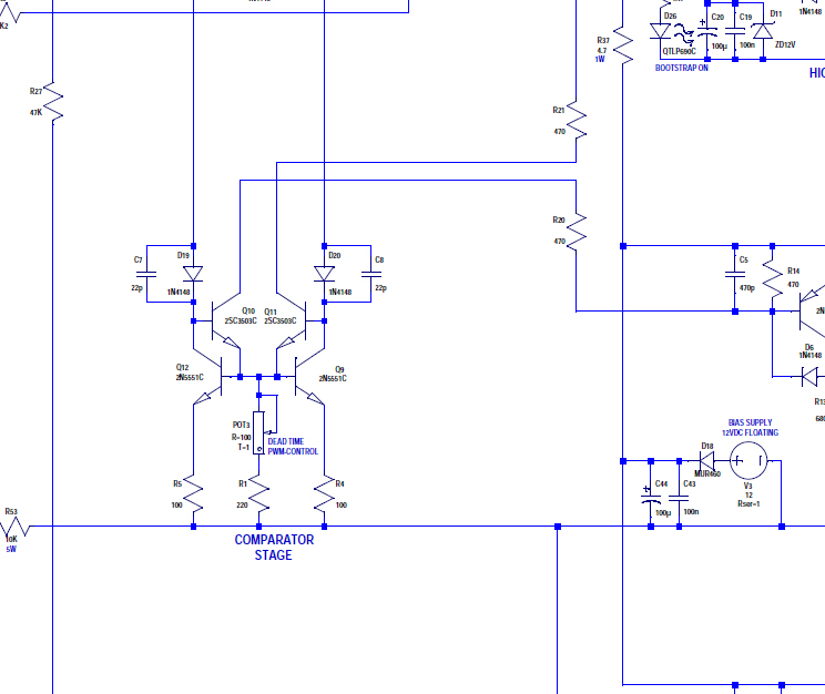

I did buid one based on OP's schematic. I'm however having some problems with it.
At +/- 90V, it seems to distort at about 20-30W output power and when probing with a scope before the output filter, it seems I'm loosing modulation for a fraction of a second - while the amp distorts sound.
Can anyone point me on what to check to fix this behaviour?

I've attached the schematic i've used, extracted from eagle.
There are some parallel resistors that are actually smd packages placed in parallel to increase dissipation. Also, not all output capacitors (in the output filter) are mounted, - only 3x470nF.
I'm using 3 pairs of IRFB4227 mosfets. Output coil is T157-2 micrometals - 42 turns.
R28 - from my schematic - was changed to a trimmer pot to fine tune dead time setting.

you have old schematic
1. look PDF
2. Dead time R1 should be 320R
3. look youtube Video 15 min assembled from scratch with Final test

I already have a finished module based on that old schematic, i'll try to troubleshoot it further.
Increasing R1 (or R28 on my schematic) allows for more power before distorsions kick in (that weird crackling noise when i loose modulation) but at that level, the mosfets will quickly heat up.
On the new schematic, I see that both sides of the diferential pair are matched, one leading to the feedback path and one leading to ground. Most UcD schematics I've seen use this sort of arangement.
Since that's different on my schematic, I gues I could start from here...

It can use 320 as minimum. Below that will be high risk of mosfet shoot thru. Higher value will increase dead time, but higher pwm speed and lower clarity as well. Proper dead time maybe need your own adjusting but remember the risk, so it must be done carefully.
Using trimpot can manage adjusting the dead time easily, but I prefer use fix resistor.
