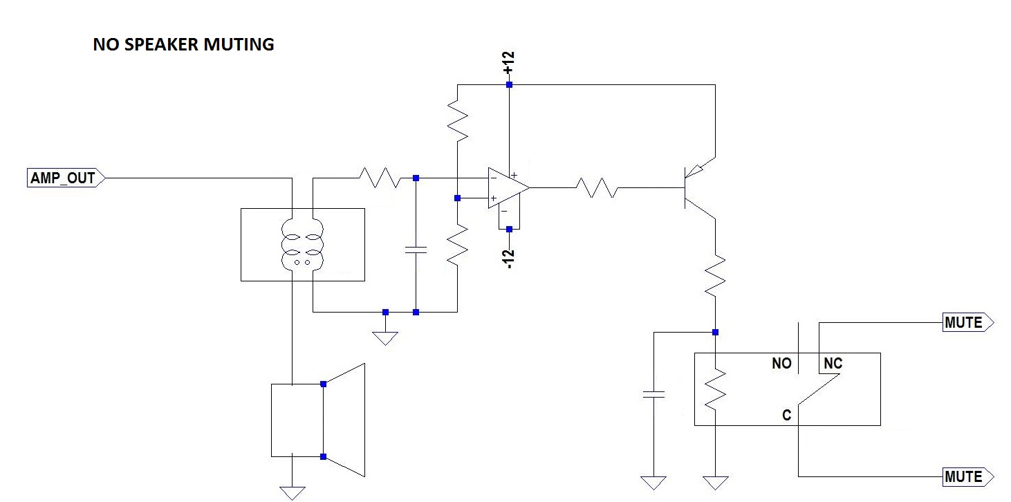

So, only for protection system is not yet implemented. Because it is lite version. I have another complete protection like OCP, mute at no load, ground loss, DC offset servo.
Hi Kartino
can you provide / sharw ( complete protection like OCP, mute at no load, ground loss, DC offset servo) schematic ?

Sorry I cannot share to others.
Too good design here but many people take advantages for commercial purpose with less effort to share to other.

amp protection easy to design, mostly people fear of dc at output and overcurrent when short happen at output, its not hard to make it. u just need to LEARN in PRACTICAL and not in theory only.
i think hes provided working schematic is really good enough for us no need to see oscilloscope, fsw meter, vi in every leg of ic and etc, tell you the truth im also making my own pcb, and i need to spend 3-4 days to complete sometimes up for 1 weeks, sometimes what we design and order prototype from factory not 100% perfect and need to re order again, its same happen to mr kartino, i dont think hes making all perfect and he also do need repeat again sometimes, i always do make pcb from scratch why?? because i know the whole circuit on pcb because im built it lol, so i dont need refer to schema again in each values and adjustment i make on that pcb, if we took another person pcb, there u go, nightmare will happen there, cuz u dont know anything from it, just receive and put component, actually u dont know that component what for, i have alot of pcb gerber collection, more than 100 collection, start from class A amp, pre amp, tone, class AB amp, class D amp, smps, half bridge, flyback etc etc........... kartino denies to give gerber file to avoid people resell it, not you, but others will do, he just share hes knowledge here and give us perfect circuit to study and make the pcb, The exact problem is, poeple who try to involve in class D without proper tools, no fsw meter, no oscilloscope, no inductance meter, almost only have basic for enough to make linear power amp.... its very sad when we blame the owner or make of amp class d or smps, we should blame ourself first... class D we cannot guess.. we cannot measure remotely to tell the thing will work or not, sometimes what we predict to be happen but another thing is coming,.... we need patient... tools and learn from it. you will be success to build it.
