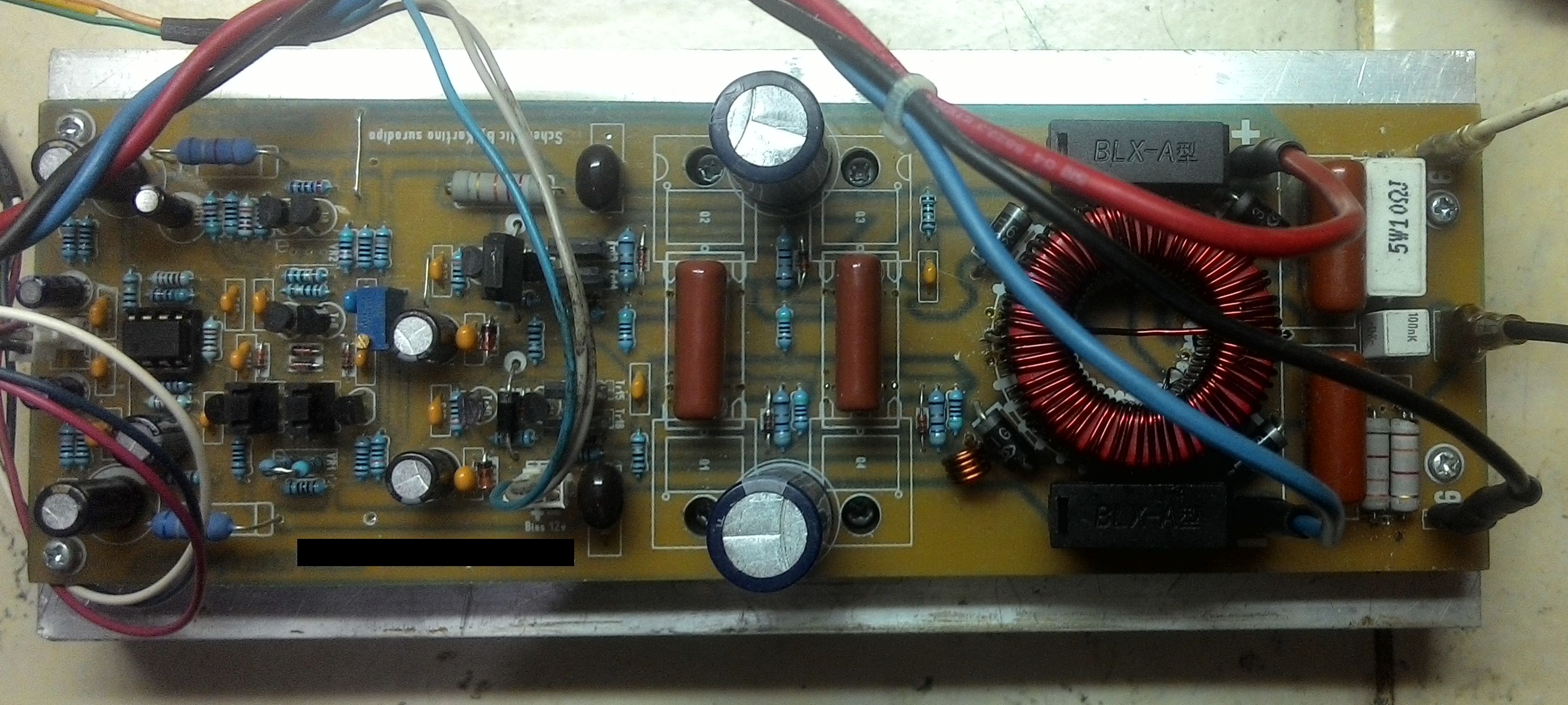

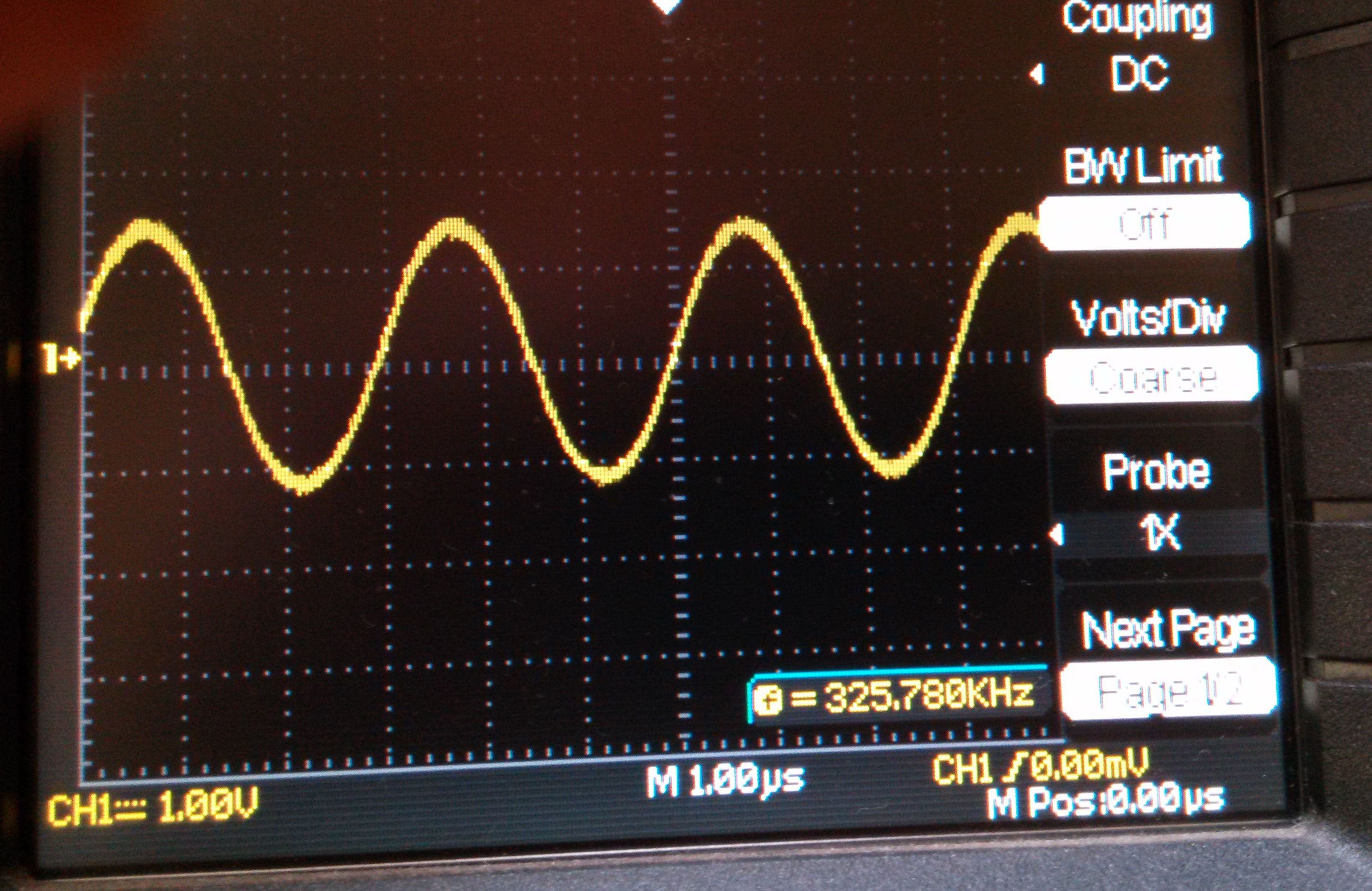

I did buid one based on OP's schematic. I'm however having some problems with it.
At +/- 90V, it seems to distort at about 20-30W output power and when probing with a scope before the output filter, it seems I'm loosing modulation for a fraction of a second - while the amp distorts sound.
Can anyone point me on what to check to fix this behaviour?

Please post your schematic exactly as real kit
