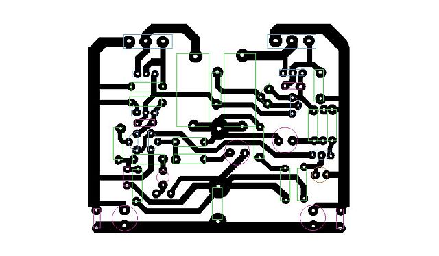

adi81bv said:do you consider this a good pcb?
Difficult to say without the silkscreen. If you're having difficulties building the amp, I would buy Rod's PCBs, then at least you know that that part is good.

I think i found the problem with the amp. Transistor BD250C has the following impedance B-C = 567 and B-E = 566, BUT when I measured the resistance across C-E it was in both ways 0.8ohm (the minimum that my milliampere-meter can measure).
So I think this is the fault with the amp. I will change it and power it up to see if this was the problem. First I will measure also the other transistors.

I replaced the BD250C... but everything went on fire. Probably other components were damaged and thats why it burned.
(this time both the power transistors are damaged, and also some resistors). In conclusion, there is no point trying to repair this one, maybe just recover the pcb board.
