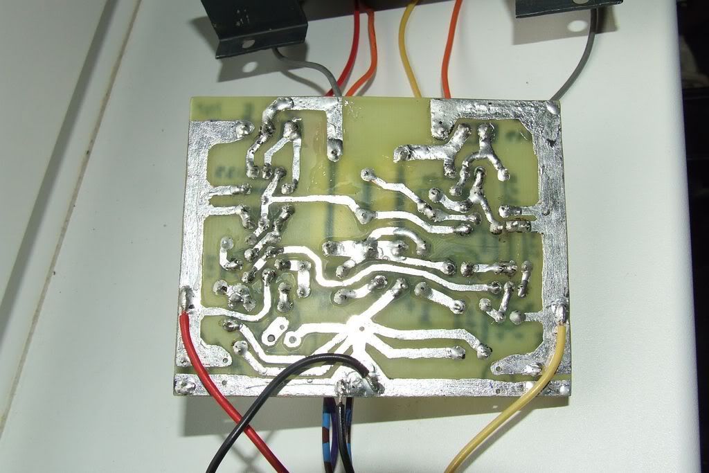

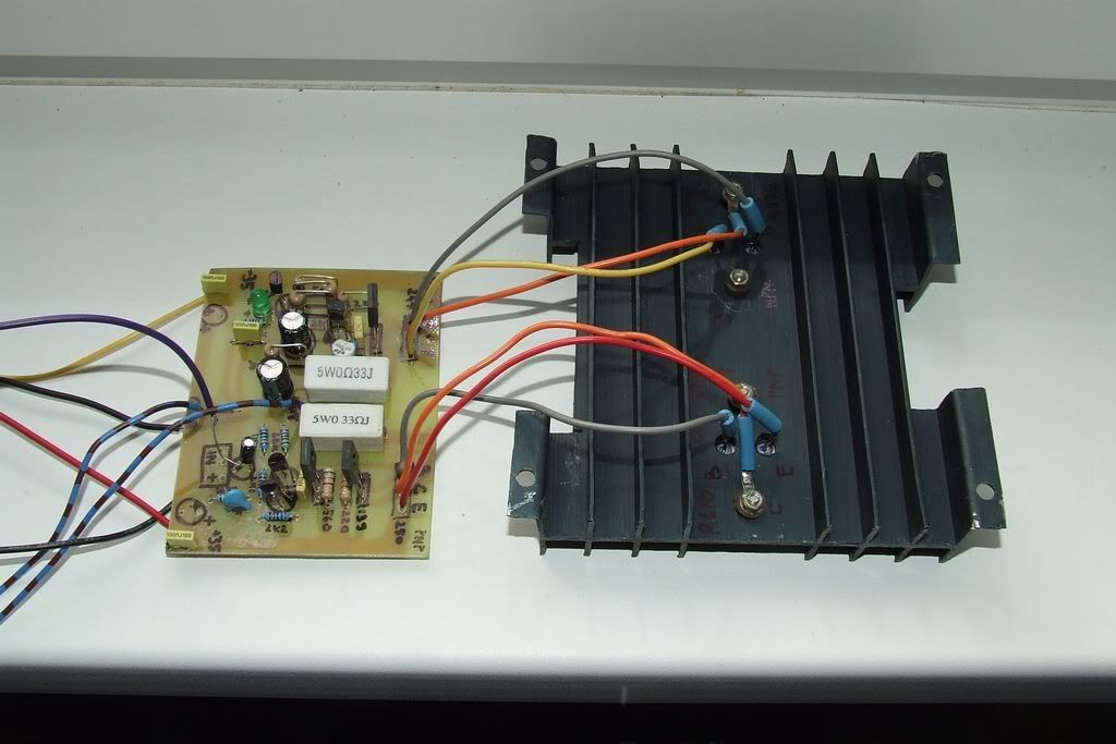

I just made some photos of the amplifier. Here they are, and a small question regarding the speakers at the end of the post:
It sound well to. A little strange at very low volumes, but powerful bass at high level.

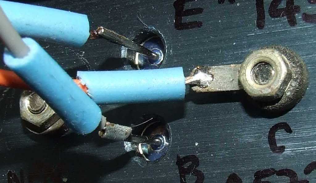

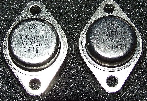

You need to shorten the wires to the main transistors as short as possible. The output stage of the P3A is a Sziklai pair and these are sensitive to oscillation. Long wires will set that off.

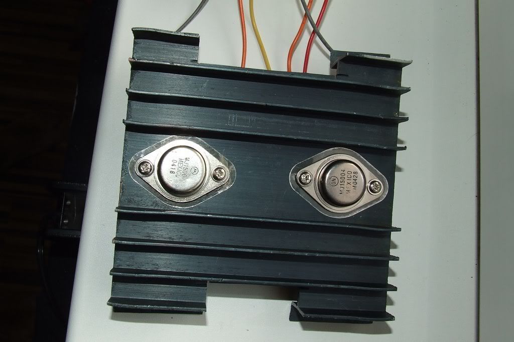

I would say your output transistors are fakes too... certainly the one with the ON logo is. They look nothing like the genuine ON parts I have here. I would say they are MJ2955/2N3055 instead, which will work, but dont push it. No 4 ohm loads, and keep the power supply to +/- 35V
Are you sure that they are fake. Because if so... in Romania probably there are no original transistors this way. 🙂 I'm happy that it sounds good.
Can you give me a picture of an original ON transistor?
If they were original, you say that i would have problems (oscillating because of the long wires)
Originals I recieved from OnSemi samples programme about 4 years ago:
Also, Rod Elliot's page on counterfeit transistors, specifically the MJ15003/4 pair:
http://sound.westhost.com/fake/counterfeit-p1.htm#mj15003
Really, no matter what transistors you use, you need to keep the wires to the output transistors as short as possible. If you were using faster power transistors then you would definitely have issues (the main reason I don't like the Sziklai pair output stage!)
OK, thanks for the advise. I will shorten the wires but after I build my amp box, to be sure what radiator I'll use and construction method. For now I'll just keep it at lower volumes.
From the photo you posted..... your sample seem strange, because of the bad orientation of the markings. (the text is not very strait? or it spreads in the right part) And my ON transistor has very good orientation of the text.
The reason way the text is so thin and one could not read easily all letters is because I tried to wipe it with acetone, and rubbed like 10 seconds to see if the text will be removed. I also mention that I had no success in removing the paint with my nail, thats why i tried the acetone.

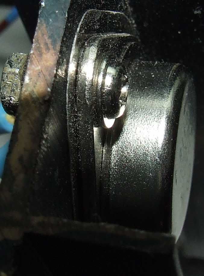

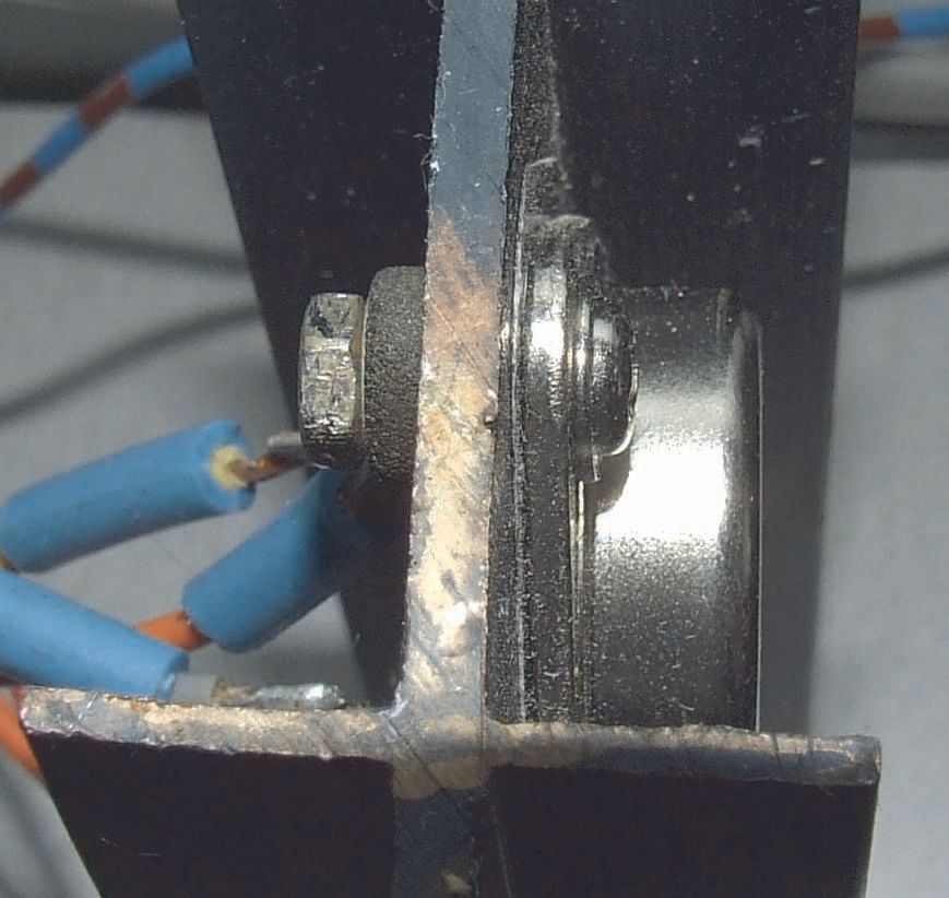

Again my transistors:
-the ON tr. seems original, i don't know about Motorola (but I hope that it is a old stock)
I tried to make some photos. Here they are:
I also measured the thickness of the legs, diameter of the blue epoxy, the distances between the legs. They all are in the specifications of the ON data sheet. Also they are steel cases (I saw one in aluminum in my town 😀 a cheap store, and I said the guy that is a fake and he look at me very angry)
