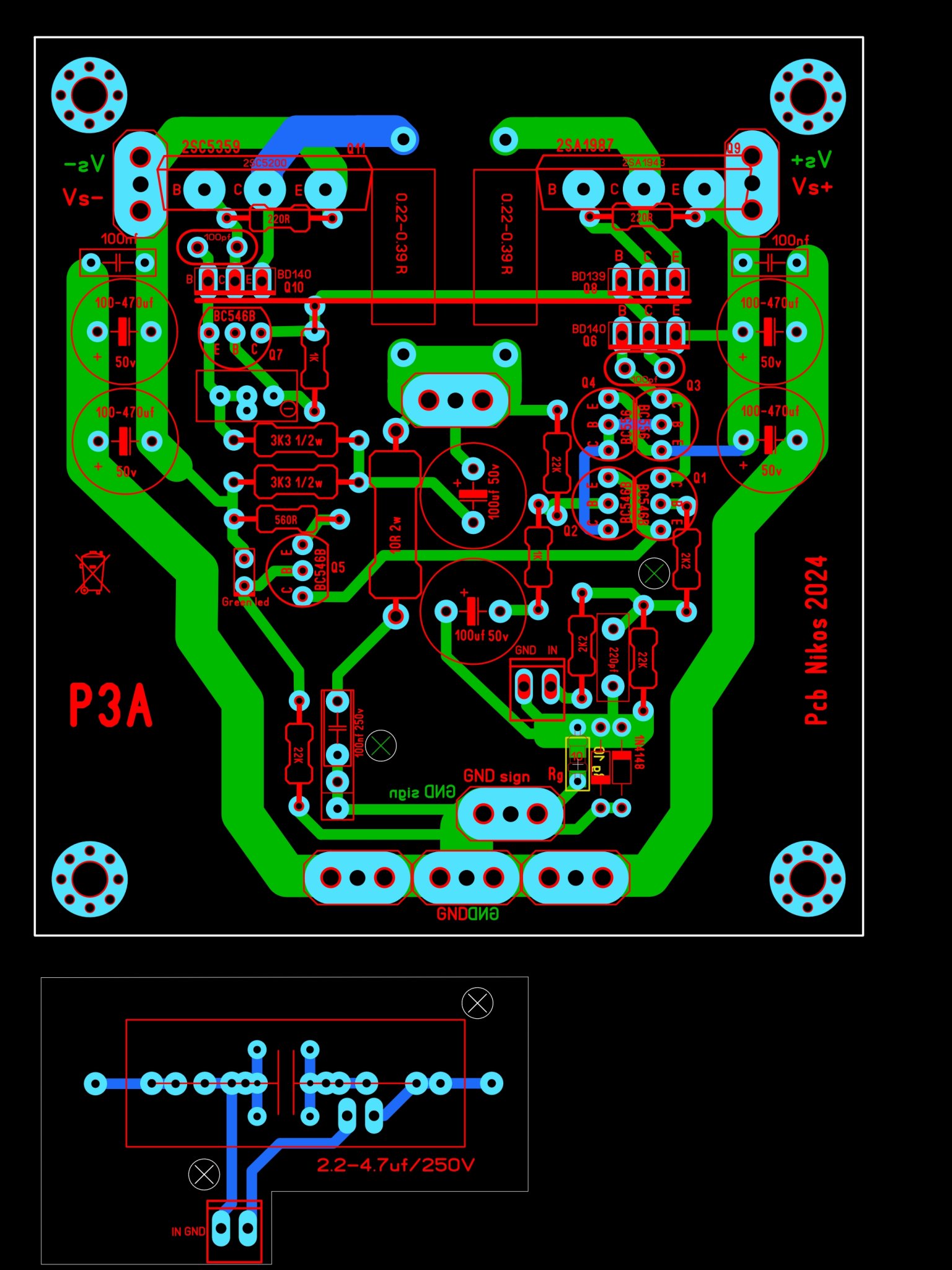

I have seen many versions of P3A on the net incl. the original Rod Elliot's PCB. I'm just wondering that whether Rod's layout has a "Star ground" or not. All I can see is a straight copper track with various components soldered along the bottom track with the main power gnd located right in the middle PCB
Disclaimer - I'm not an expert in PCB designing
Hello Nikos, have you sent this lay-out to a pcb house? A few thoughts, input source should be away from power sources, yours is very close to rail fuse. another preference of mine is 'rail fuses is placed as part of the PSU board'. One acceptable consideration is 'placing the rail fuses in between a stereo board, just like Rod Elliotts pcb design.
This is my personal preference of a CFP output amp board. Outputs, drivers and zobel network is placed near each other, the more compact the better.

Layout is not a real big factor for a design like the P3A. By no means is it a PPM amp !
It's going to test at .01-02% however it is lay'ed out. As long as NFB takeoff is correct and
there are no gross electrical mistakes. Even a less than ideal star ground would not matter with this
design.

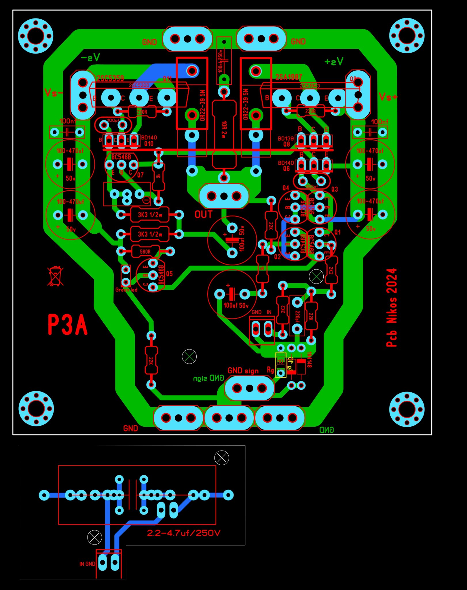

Last version without fuses.
