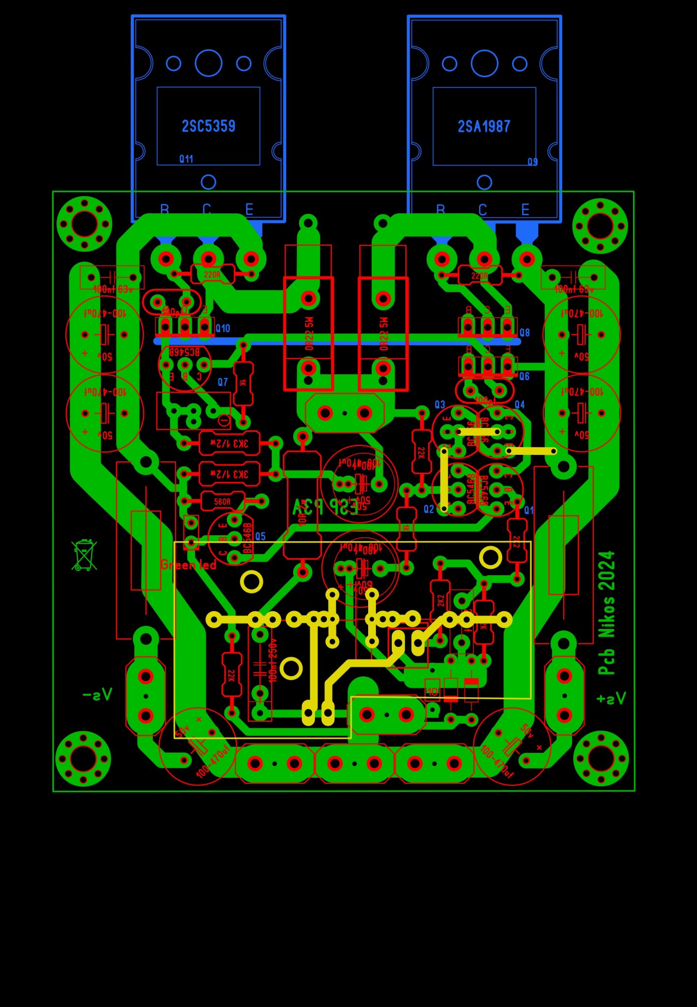

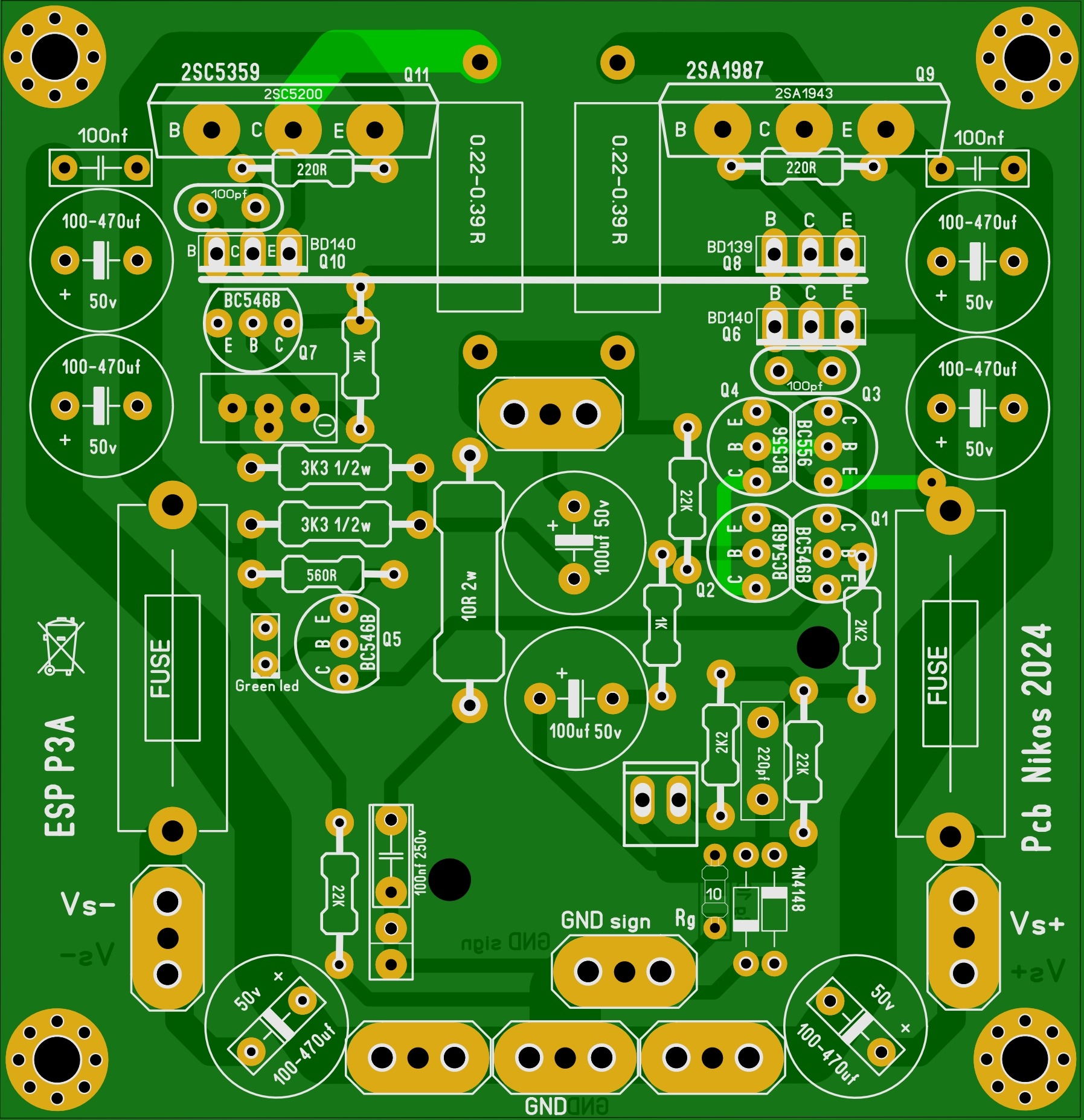

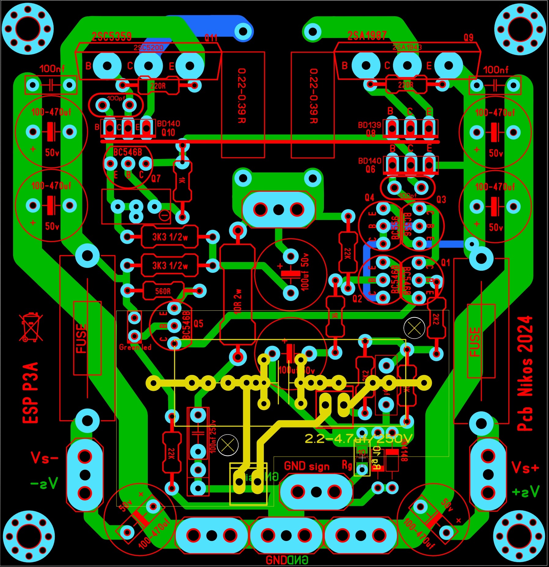

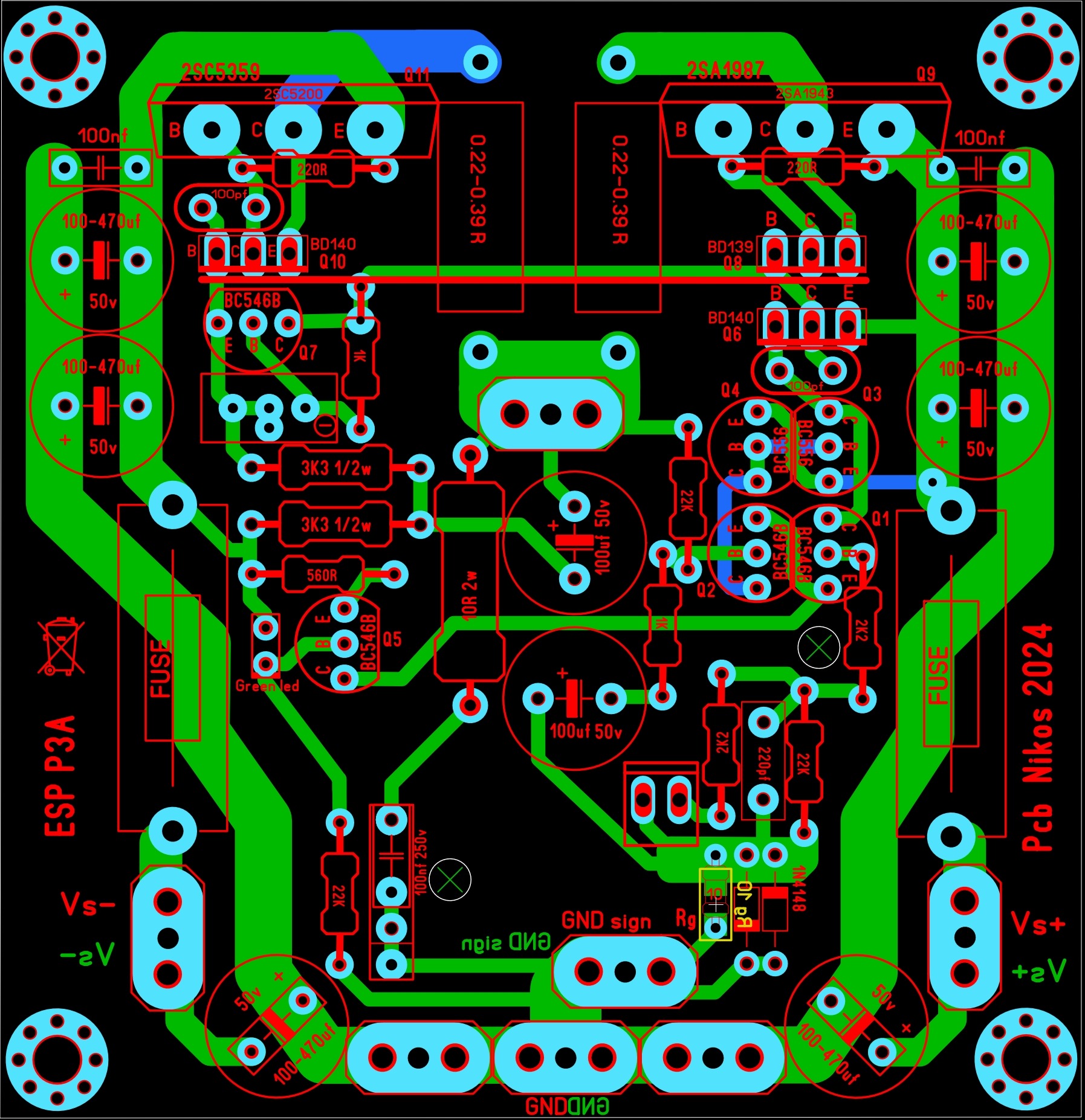

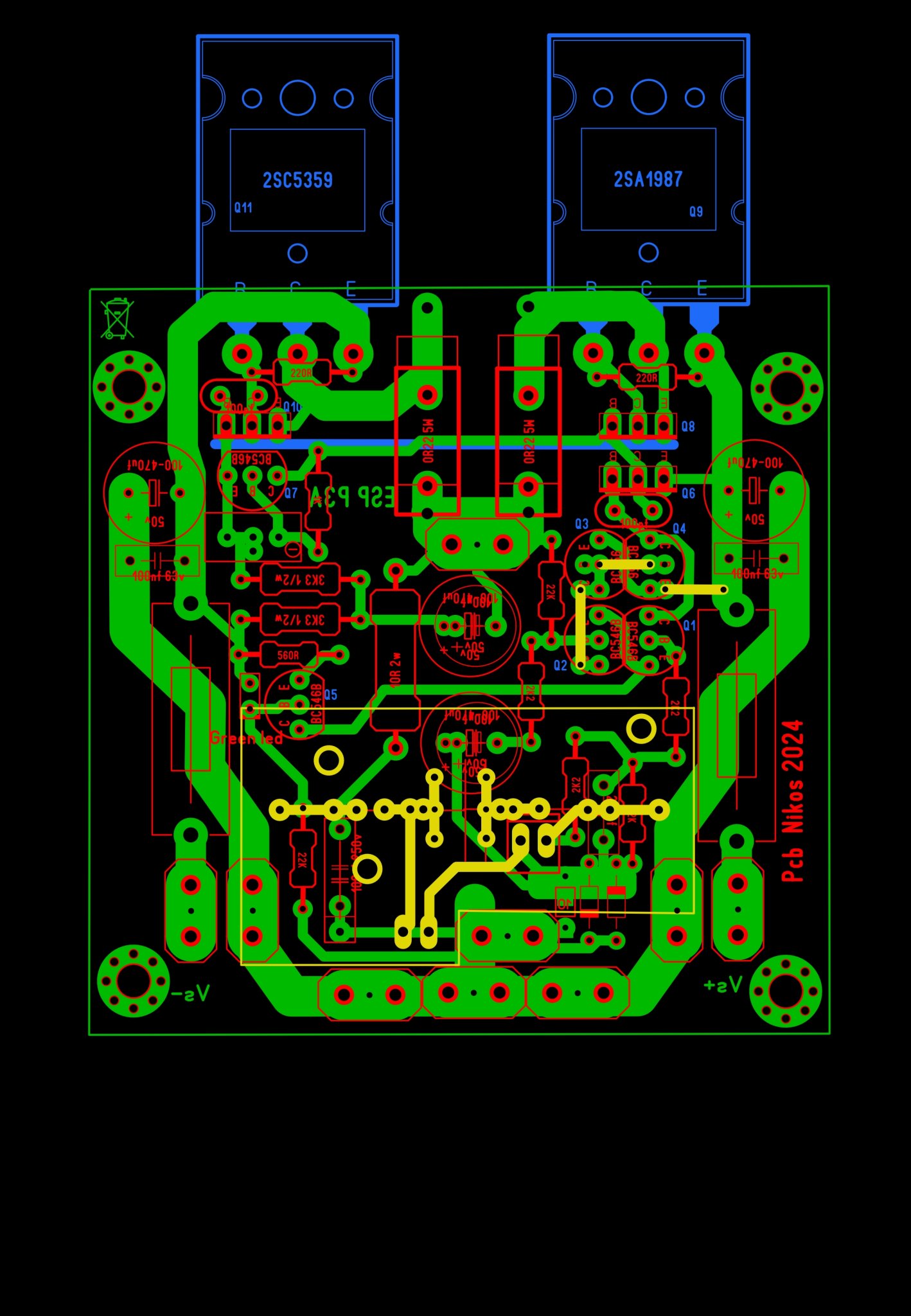

P3A PCB Layout

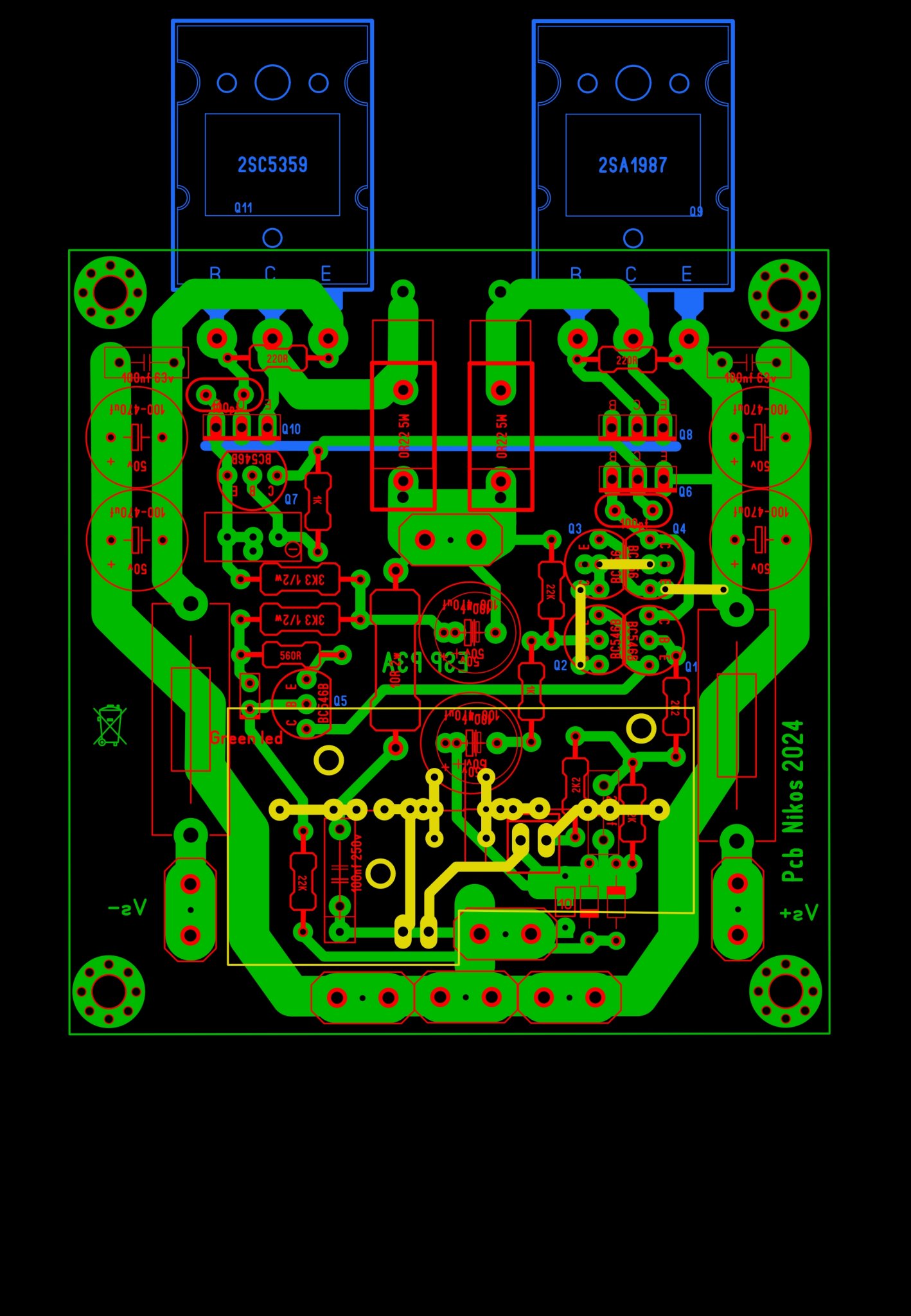

Final version. Option Q7 +Q10+Q8 at the same heatsink.
If someone want the .lay file its free just send me a PM.

While I agree in concept, this is not the way its implemented on the Wolverine PCB. They have the 100nF caps positioned as Nikos does. Those guys obsessed over every possible PCB tweak that could improve performance. Difference circuit obviously, but the intent of these caps seems the same.
Thoughts?
Final definitions.....personal use.
Hello Nikos, have you sent this lay-out to a pcb house? A few thoughts, input source should be away from power sources, yours is very close to rail fuse. another preference of mine is 'rail fuses is placed as part of the PSU board'. One acceptable consideration is 'placing the rail fuses in between a stereo board, just like Rod Elliotts pcb design.

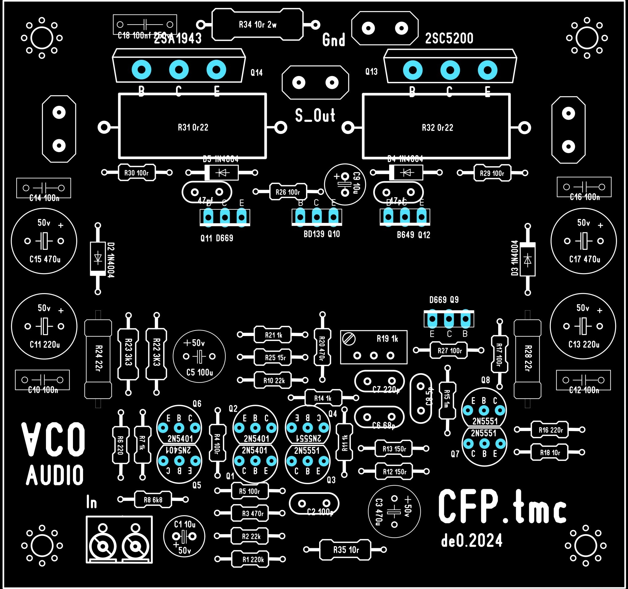

This is my personal preference of a CFP output amp board. Outputs, drivers and zobel network is placed near each other, the more compact the better.

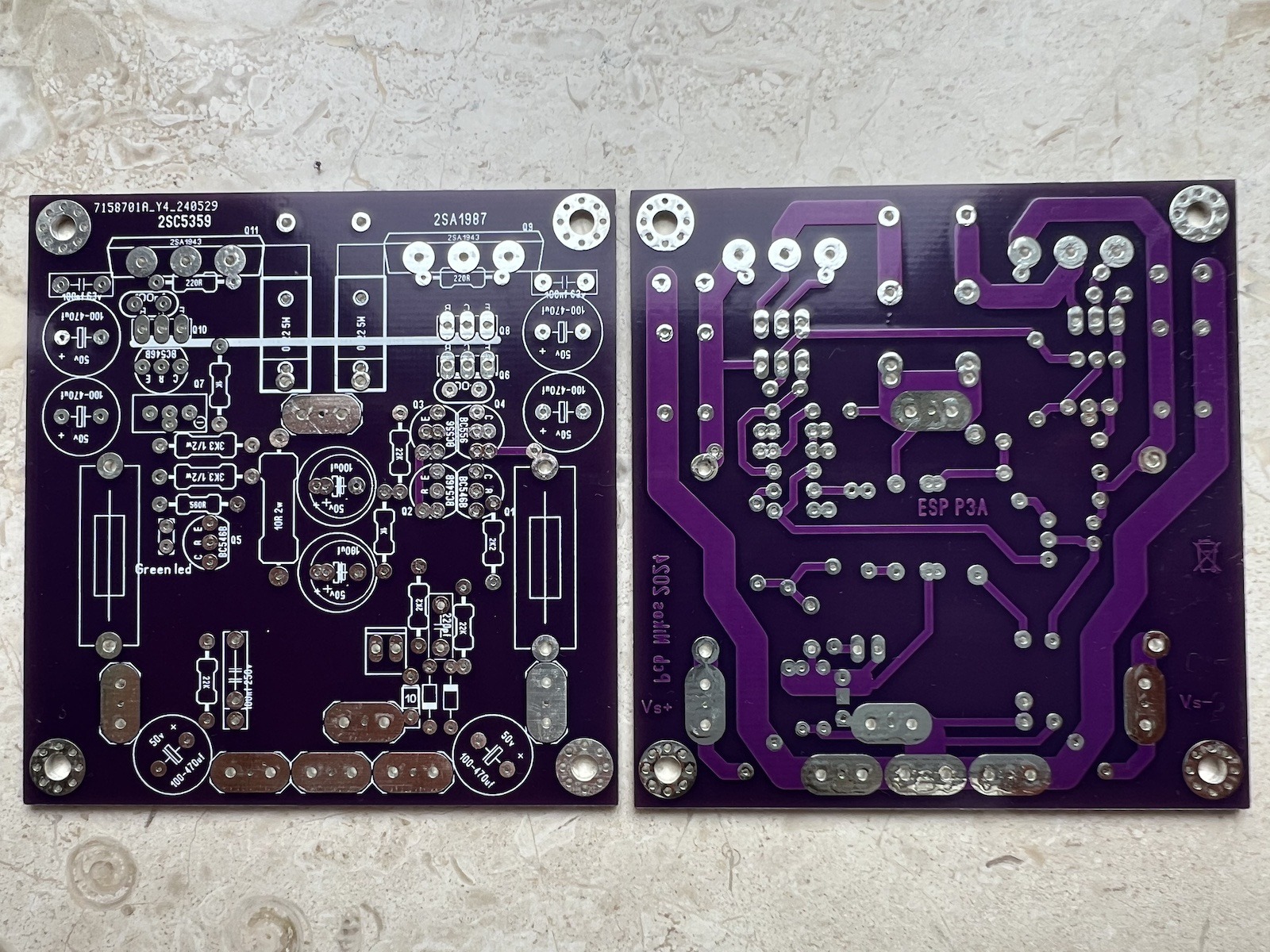

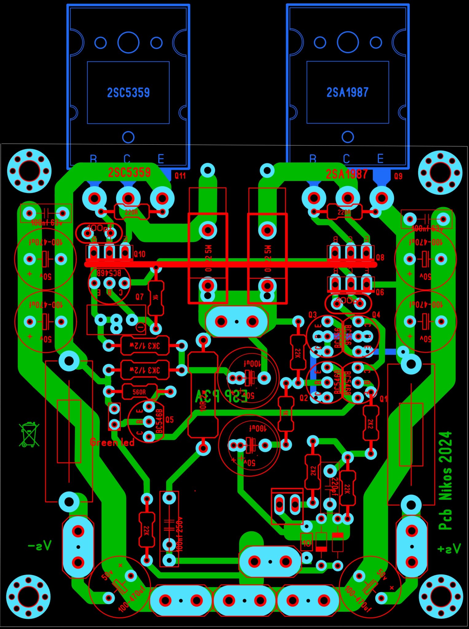

I gave a Nikos' boards a run.
Just the pcb, no soldering so far.
Silk screen is as you can see on the picture.
Misleading 2SA1943 marks are left near OPS transistors.
The main issue is with drilling - too small holes for many components.
Resistors with 0.55mm leads does not fit.
Example - 10R/2W resistor on one lead is D12, on the second is D13 (on the drill map).
In my opinion D11 should not be used, all D12 should be reviewed.
I got a few spare boards (say 4 pairs to share).
If someone wants to give it a try (boards as is, manual correction of drilling is needed) please PM me.
Across EU shipping is like 7 EUR, boards 3 Eur per pair, total 10Euro.
